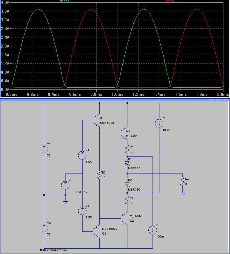

Pair of Schottky non-linear resistances spanned between two offset followers
gives the following push and pull currents into the load: I've never been sure
if this behavior was Class A? or Class AB? Maybe its your Hyperbolic thing?
Is there a schematic of the OPS?

cbdb>Is there a schematic of the OPS?
Yes.
This circuit I am about to show you is an older one, created the above plot.
Certainly not the simplest, nor best way I could have drawn for you today.
Magic is simply two independent single ended class A amplifiers, any type will do.
Offset one amplifier to track one emitter drop above the desired output voltage.
Offset the other one to track one emitter drop below the desired output voltage.
A quiescent current is set by resistors spanning the gap between these two offsets.
If that resistance is linearly resistive, then only linear class A crossing can be the
result... Power wasted at quiescent is exactly the same as at full output swing.
But if that resistance rides on the curve of a non-linear diode.... You can shape it.
The Quiescent current can be far less than full output swing. But still no transistor
is ever turning off.
This is my own circuit, nothing to do with Yamaha's. And possibly irrelevant.
We still at this point know nothing about "Hyperbolic" to guess what that means?
But the Yamaha advertised description (so far) fits how mine behaves to a tee.
Is Yamaha using the same trick, or I've spun completely off a different tangent???

Darn, and I thought MY way (with a big Schottky) overcomplicated.
Yamaha looks like an analog computer based upon log nonlinearity of
bipolar transistors??? How they keep that from becoming temperature
dependent? A Schottky on the other hand dissipates almost nothing
in this application compared to the capability of its TO220 package...
But I think we are talking the same end result, as far as current go.

Its far easier to match curve of an identical two terminal diode to compliment
the same on the flip side...
Than trying to match up swervie-curvies of an NPN to PNP, especially if those
same devices are also the ones dissipating the big power... Many of the purpose
built complimentary pairs have lots of emitters with series resistance, too linear.
Just build in some error correction, and let them be as linear as they wanna be,
why fight it?
The Schottky can't drop more than .3 forward volts, so its largely out of the
power dissipation business at any realistic Class A current. But it gives back
the curves we need to achieve this A-AB-hyperbolic crossing or whatever it is...

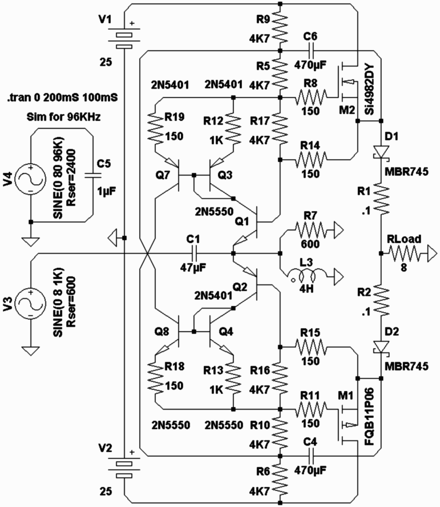

---Are there HCA diy projects respective other commercial amplifier brands, where is HCA technology inside?---
There are two quite simple schematics for DIY experimentation here :
Ian Hegglun,
"Square law rules in audio power"
Electronics Wolrd +Wirelss World, September 1995, p751 to p756.
