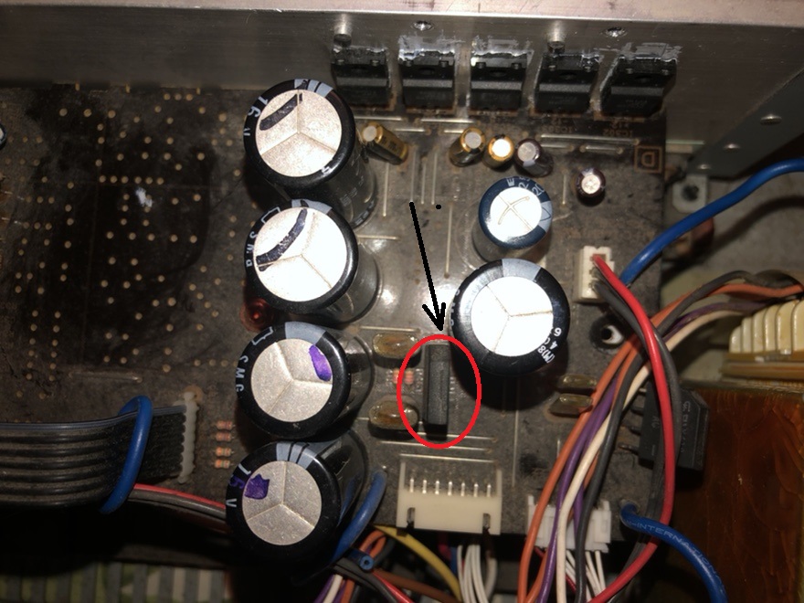

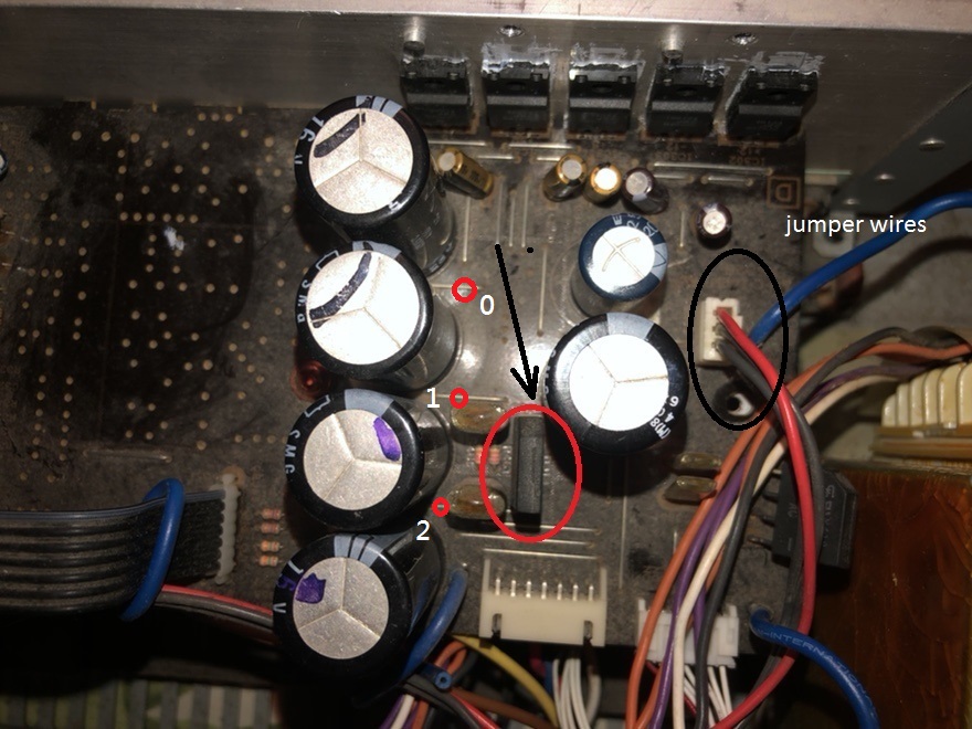

I think I burned some IC regulators because of my bad test of yesterday, The values received seem to be wrong, for example yesterday on the first IC I geted the correct value which is "+12V" and now I get 1.30 ...

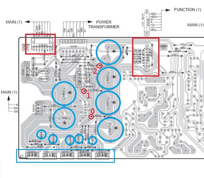

OK, please measure below voltages after the bridge rectifier, one probe on jumper 0, the other probe test jumper 1 and then jumper 2.

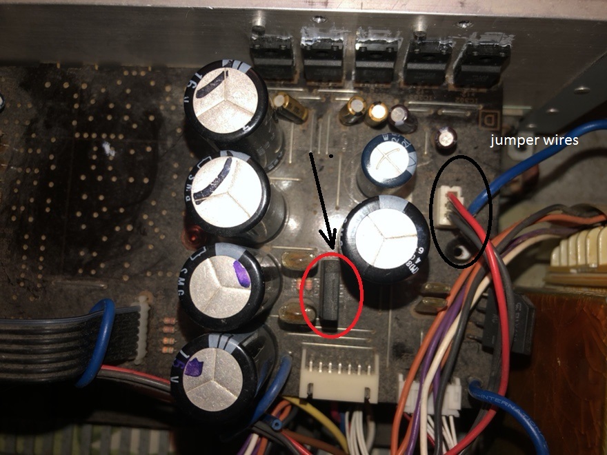

In the video, I saw the bigger caps quality is not so good, I think you should replace all the regulator ICs and all the caps together and hope the power supply board can work after the replacement. I marked the replacement regulator ICs and caps in blue color.

This is the bridge ?
Measure using DC Voltage function/mode, not diode mode. Black probe connected to chassis.Ok, I mesure that with diode mode ?

power on and measure the voltages
I'm really sorry but you want me to test theses 3 wires ?
measure below voltages, one probe on jumper 0, the other probe test jumper 1 and then jumper 2.

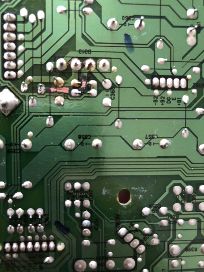

I think that the game is over, I found it :
It is not difficult to fix these broken PCB traces, but first you have to find out all the bad components, replace them and reconnect the broken PCB traces, then you can test the board again

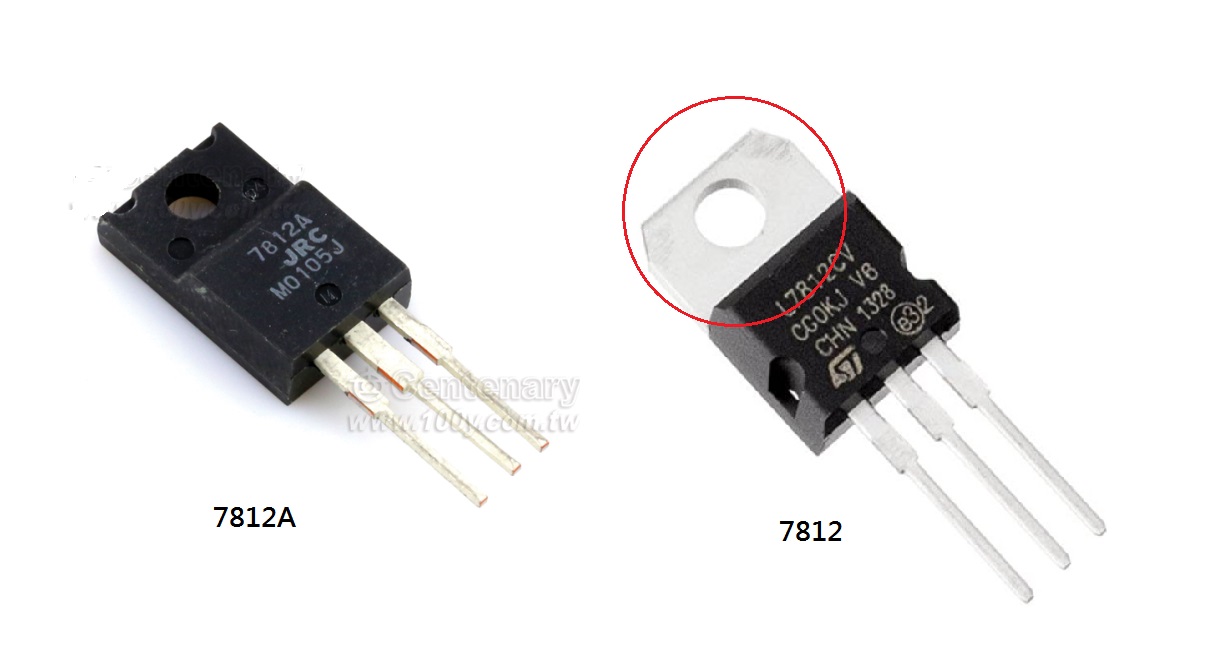

Can I replace the : 7812A and 7805A IC by 7812 and 7805 IC ?
Best regards
I have a question please,
Best regards
The package is different, normal 7812/7805 the heatsink fin is exposed, but it is the ground pin for a positive voltage regulator, so that it should be no problem to use them to replace the A version.

Do not hurry to test it without all the regulators get replaced.
How about the back side of the PCB, do you repair it good.
Unfortunately no, how can I fix this?
