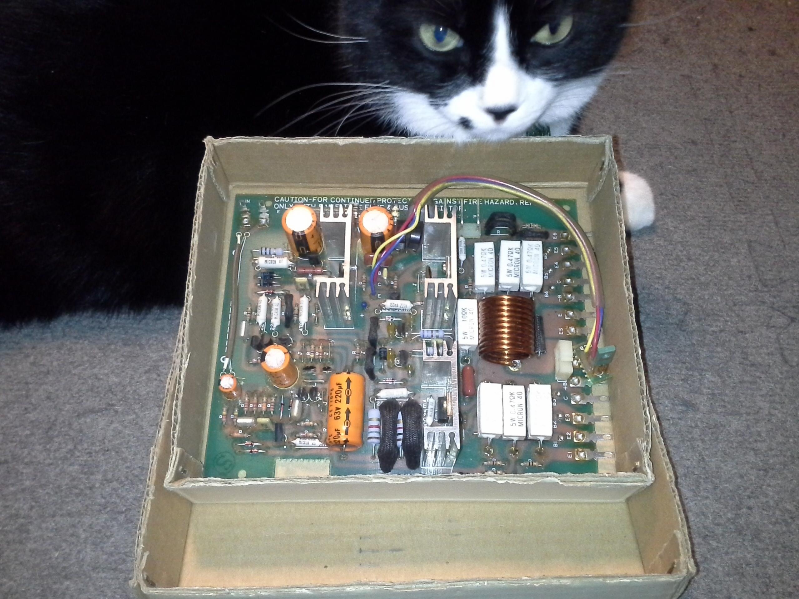

In looking at your pics there seems to be something strange about the PCB boards. These Yamaha amps (Japanese not Chinese amps) had different right and left mirror PCB boards, and what you are showing are two channel “B” boards used for both the right and left channels. The board that is installed as your channel “A” is actually a channel “B” that was taken from another amplifier. This can be seen from the fact that the shielded input connection is towards the rear of the amp and is located close to where the speaker connection should be. This was considered bad as this could couple the output signal back into the input causing the amp to oscillate destructively, and since there is NO speaker protection on these amps. It would also result in the destruction of the connected speaker. You might consider rotating the whole heatsink assembly 180 deg so that the input would be facing towards the front of the amp although this would mean that the bias adjustment pot would now be facing the bottom of the amp.
I had at one time a brand new (unused) spare channel “A” PCB (see pic) but I sold it along with all 8 of my P2200 amps to a friend. I could contact him to find out if he would be interested in selling it if you would be interested in purchasing it.
Hope you get it working because it really is a great sounding amp.

Philip, I would be interested in that spare PCB, if you friend wants to part with it. I have a P2200 driving 16 planar tweeters in my system. The amp in question is a P2201 (the ugly sibling). Could you explain the mod you performed to reduce oscillation, I also require new outputs for that channel. I had this problem with my Phase Linear, I had insufficient capacitor size on the output R-C network.

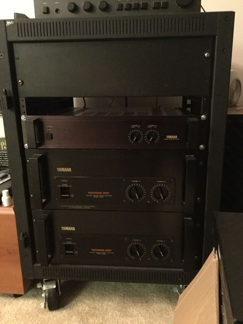

Any progress on your amp? I am a big fan of the P2201, I have 2 in service and a third arriving soon, I hope.
I've had a lot of SS amplifiers over the years and these Yamaha's are among the best (at least best bang for the buck), I would put them up against Brystons all day long knowing I've paid a fraction of the Bryston price tag.

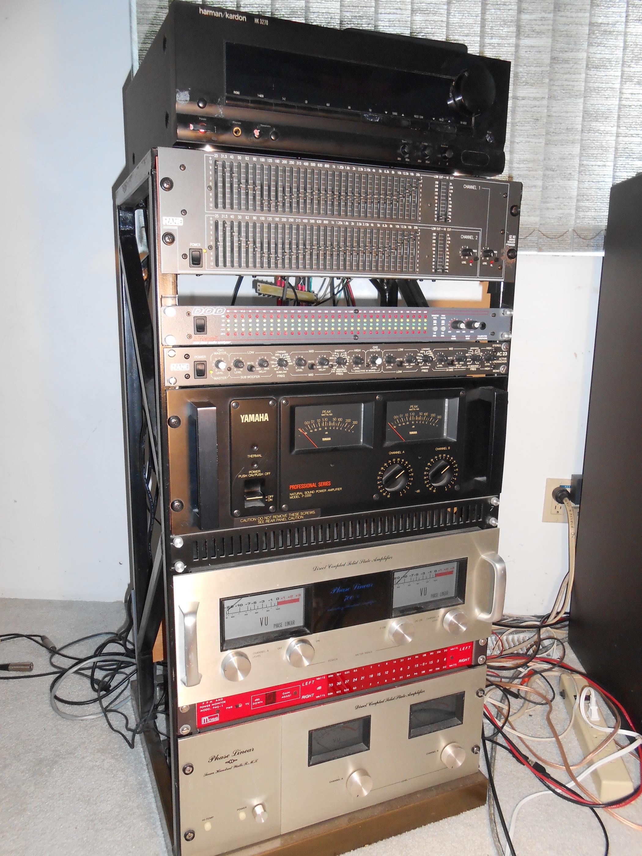

Here is my 'nice rack';

I agree and am very impressed with this series of amps. I would never literally scrap this amp, but for the moment, it is 'on the shelf' As mentioned, it's brother (P 2200 ) with meters, is playing a key position in my system, driving 16 planar tweeters.
BTW; are you aware of amplifiers of this series, but larger? I'm sure I saw a theatre sound system in the early 90's with rack's of Yamaha P series amps, some were another 2 rack spaces taller!
Also, regarding upgrades, I would be very interested in how you might modify this amp. It was mentioned here that replacement outputs are 'faster' and IIRC, may oscillate.
PS; I have my sights on a P 2100, so I'm building a 'retirement home for Yamahas' rather than a scrap heap. Although my electronics knowledge is limited, I am a firm believer in class AB for HIFI systems. Class A seems pointless, given so many other weak links in ANY audio system. I have resorted to class G (Crest CA 18) for my (subwoofers) LF from 140 Hz and down.
