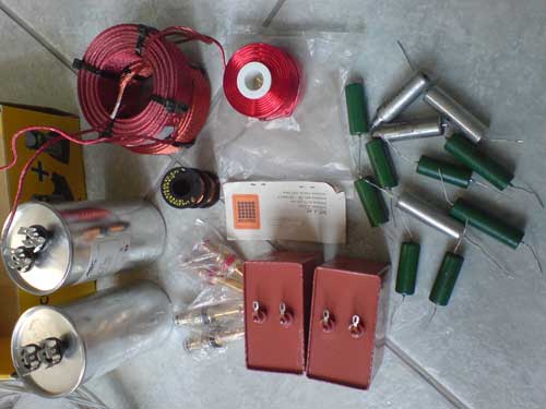

As I said in an earlier comment: my old NS1000s did OK. Then I replaced the x/o caps with SCR MKP:s, speakers like new!
Finally I cleaned the level-pots with Kontakt 60, and voila!
Coils and internal cabling were resoldered but kept original.

Here's my pile of upgrade material. Hopefully I can get it in the box.

I think ELFA charges around 1000 SEK for SCR caps for two x/o:s
Probably cheaper in the UK.
I hope this photo will be included, never done this before .
If not, e-mail me and i will reply.
Not too difficult to swap. Lift out the big electrolytics, leave the sixpack in place, they ARE bitches to get out in one piece....
Solder in the new ones, use melt-glue to secure them.
Best rgds/Conny
