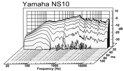

The measurements of Yamaha NS10M from Toole's "Sound Reproduction"
reveal that this speaker was designed particularly to have a flat POWER
response, which is very wrong when one puts it in open space, but there is a
rumor on the internet that the guiding idea of making such a speaker was to
counteract the fact (?) that the average loudspeaker set in a home environment
had its bass and HF region lifted up well above the midrange (loudness), so to
put things back in order, they figured the midrange should be pronounced enough
so it sounds normal again.

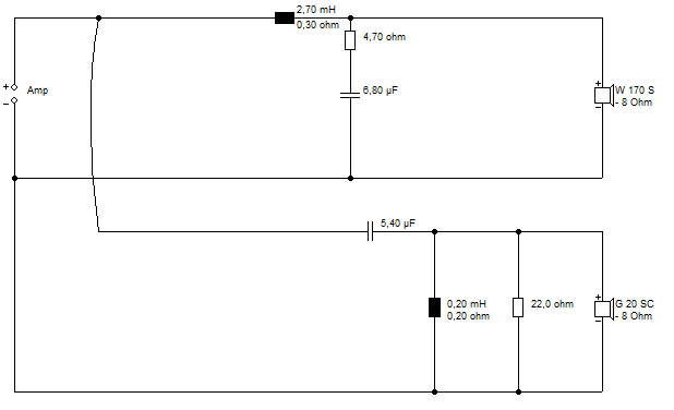

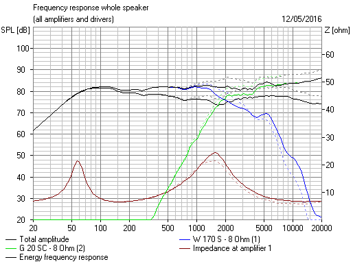

Thanks for doing that System7. How do you happen to have the FRD files for
these drivers already? Looks like all it needed was some padding for level
balance between bass and tweet. Now we can get rid of the Kleenex. 🙂
No. He's still posting sims based on the wrong drivers.
Seems to think its OK to be not too far off. It is not.

Thanks for doing that System7. How do you happen to have the FRD files for these drivers already? Looks like all it needed was some padding for level balance between bass and tweet. Now we can get rid of the Kleenex. 🙂

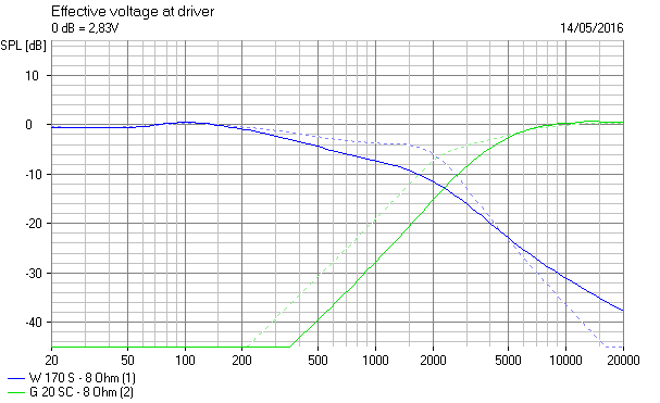

You don't really need to know anything about the drivers to know how filters work.
Adding shunt resistance to the bass circuit makes the midrange less peaky and shallower. And 2.2R series and 15R shunt on a tweeter is just 4dB attenuation, however you lay it out. I prefer my way for the higher impedance. Phase alignment actually improves. On second thoughts, smaller 7W resistors would be more than adequate.
Regular 6" paper drivers are 6" paper drivers IMO. Perhaps except for some exotic low inductance Scanspeak and SB designs, they can be treated the same. The shunt 4.7R resistance counteracts the ca. 0.9mH voicecoil inductance. Always an issue with the 5kHz peak too which is a cone resonance, but in practise you notch it at slightly higher at 6kHz if necessary. Just how it works.
Interestingly, Troels Gravesen has done some 6" projects with otherwise identical low inductance SB Acoustics SB17 Polycones, Paper Cones and Metal Cones. The polycone is easiest.

I also stand by my suggestion of lowering the mid and tweeter level, which increases subjective bass. Tuning by ear really can work if you know the tricks. I don't suppose that woofer defies the laws of physics. It's probably 8 ohms and Le 1mH voicecoil inductance. So the electrical response is fairly predictable.
For a £5 worth of 7W wirewound resistors and a bit of soldering, what have you got to lose? It's fun. And if you don't like it, you can put them back as they were.
That is absolutely plain wrong. Filter transfer function is calculated
not just based on filter parts values but also on impedance of the load.
If that alone would have been sufficient as you already said, you wouldn't
post response plots of a whole system, including acoustic output
of the drivers.

There is 2 potential tweaks to improve bass extension response.
1. Modify the XO filter to get rid of the wide midrange hump
and pad the tweeter down somewhat
2. Make a vented box out of it.

It's not actually as bad as it looks. The power response around the room is quite flat. That 2kHz peak in frequency response occurs at the point where dispersion is weakening, so has some strengths. Probably a good "Rock" speaker with lively guitar harmonics that sounds good all around the room.
Personally I don't like a 2kHz crossover to a tweeter. It's pushing it quite hard and maybe into distortion when loud.
The bigger box and some sort of reflex might work. I really don't know how that will turn out, but it's been done before with 6" bass.
But the more radical option is to increase the bafflestep. Changing to 2.7mH and 6.8R shunt along with a 4.7R resistor lowers the peaky midrange by a huge 6dB. I thought that 0.6mH tweeter coil was way too big also. OK, a complete rebuild, and TBH it might lose everything that was special about it. Who knows 'til you try it. But this IS a DIY forum, and that's the hobby that we so enjoy. 😀

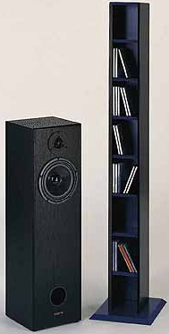

Well, it's been three years, so I figure it's time to resurrect a thread...
I just purchased the originals- the NS-10T, which is the "home version"; the "original" speaker re-purposed for studio use. I sort of wanted the original versions to see (perhaps) why they ended up becoming the 10M that is so coveted(??) these days.
I got them for short money (matched pair from the son of the original purchaser) and after removing the thick, sticky, black goo from the sides with isoporpyl alcohol (that was fun! Simple green wasn't up to the challenge!), they look OK. Drivers are in good shape (haven't fired them up yet). A few nicks and dents too, but I may re-make the boxes (same interior volume but more bracing and real veneer)
Most of the data out on the web references the "M" version, the smaller box adaptation (capitalization?) of the NS-10T as a "studio monitor". Interesting that Yamaha defined the market now known as "studio monitor" as it didn't exist prior to speak of. (Horrortones anyone?)
So, based on age, I figured a crossover rebuild was in order. Being an ignoramus on crossover design, I'd probably do what I've done in the past- replace caps with higher quality audiophile caps. But ,maybe there's more to it? More to be had while I'm in there messing stuff up?
Unlike the NS-10M's, the NS-10T's are not commanding the big bucks (so no loss to mod them, other than weirdos like me looking for the REAL NS-10. Must be the "gray" woofers rather than the slick white ones that devalue them, or perhaps the genuine simulated wood tone vinyl wrap... Who knows. I think the larger box is a good thing, as is having "the original" version that was re-purposed, rather than Yamaha re-designing something that really didn't need redesigning.
Now I know the M has a different crossover, different drivers, and a smaller box. But, what were they addressing with so many changes? To make them sound worse? Anyone have any insight or ideas?
So, I'm planning to use these as intended- as bookshelf speakers with a vintage (probably Kenwood- not purchased yet- let me know if you want to unload something) system for my office.
So does anyone have the T version crossover and driver specs to potentially tweak them to a slightly flatter response? If they even need it? I presume the drivers are quite close to the M version (despite the color) and the larger box might be a good thing too. Also sealed- no ports.
