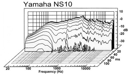

There is 2 potential tweaks to improve bass extension response.
1. Modify the XO filter to get rid of the wide midrange hump
and pad the tweeter down somewhat
2. Make a vented box out of it.

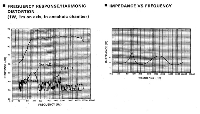

Hi Mr T,
although you have decided not to work on this project, questions asked deserve
to be answered. One can modify the way a speaker sounds by modifying XO
filter. Manufacturers do that all the time when they engineer loudspeaker series.
Yamaha states 2 kHz XO frequency for NS10-M and the impedance plot seems
to confirm that.

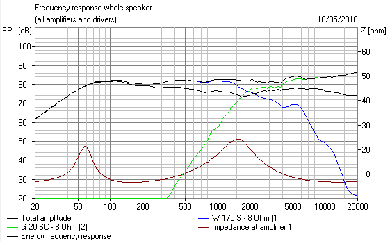

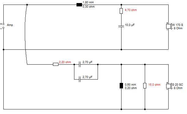

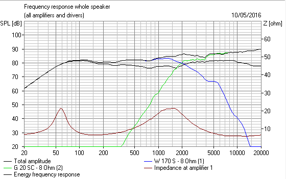

Along the lines of what one can do to learn more about making and modifying crossovers - you can take the existing xo and draw a schematic of it with part component values. Run the drivers without a crossover and use a calibrated mic to measure the minimum phase FRD files for each and both in parallel (sans XO) and the import those FRD files into a simulator like PCD or Xsim. Enter the as drawn XO schematic into the simulation program. Then purely on a computer, you can play around with changing component values or even making a new XO altogether without messing up the actual speaker parts. It will be a very accurate way of predicting the final Xo performance. If you end up with a response you like in the sim, maybe try making the xo and listening to it. It's a great learning process. It probably won't yield a better sounding speaker - although flattening the response may help reduce harshness which was sometime accomplished by hanging 2 sheets of Kleenex tissue in front of the tweeter to take the bite off the sound.
A little 6 or 7" bass in 18L is never going to be a huge performer at the bottom end, but you can do a bit by lowering the midrange and top subjectively.
I ran XRK971 crossover up the flagpole based on what people say about this closed box speaker. Not bassy, and bright.
A few 10W wirewound resistors make things look better. 2kHz crossover looks right. Must push the tweeter quite hard.
