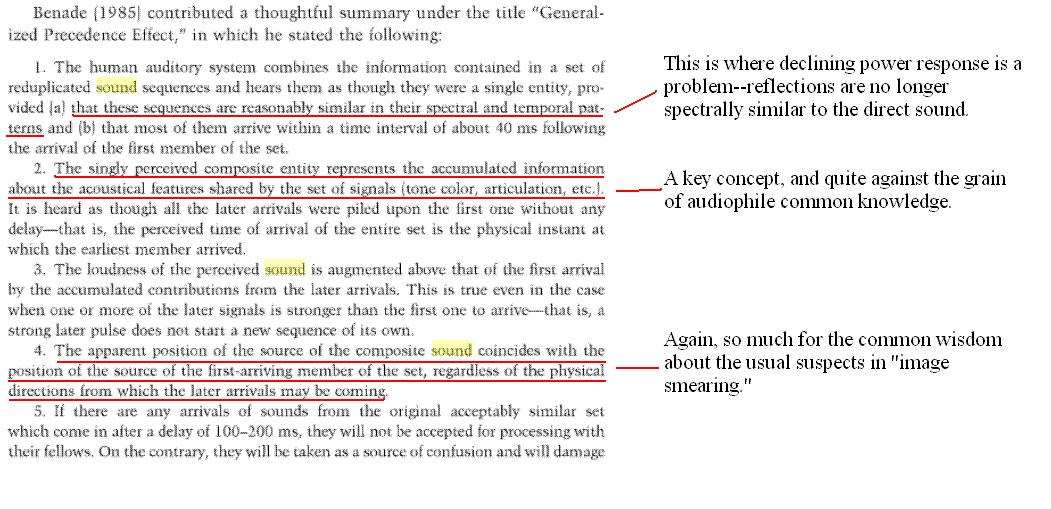

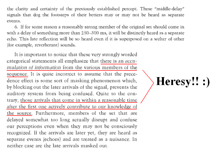

I went to Google Books and was able to glean some goodies between the redactions. This is pertinent stuff to the topic, found on page 76, 77.
(No OCR at hand, so I've attached screenshots of the text with a few of my comments.)
