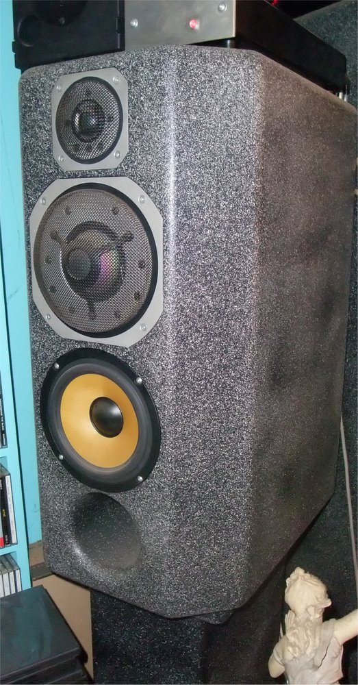

Today i placed the 1000's on heavy stands on there side with the tweeter facing in with a slight toe in.... This created a more stable image with voices being more central instead of the wall of sound effect. Not holographic spooky imaging but acceptable, the weakest point in an otherwise outstanding speaker.
Brilliant speaker, im going to try a diy high end bookshelf with some seas metal drivers in the future to see if they can out perform the yamaha's. To me i cant see any speaker at a resonable price outclassing them completly but maybe im wrong?
I don't think anything will ever beat the Yamaha Beryllium midrange :no: I find it quite ironic that other speaker manufacturers have only cottoned on to this material in the last few years where as Yamaha was using it nearly a quarter of a century ago 😀 Still haven't seen anything other than tweeters us it yet though - they are miles ahead of the curve.
I think the Yamaha's will have much better dynamics than a system based on Seas metal drivers, but if well executed the latter will have much lower coloration in the upper bass / lower midrange area.
I'd tend to agree, there really is quite a bit of cone on the 12" bass to allow reflections from the rear baffle through. The carbon fibre bass unit of the NS1000X (also similar to the NS2000) does a better job in that area. On the NS2000 thay also added extra bits of wood at the side with 3/4" or 1" rounded edges to, which certainly helped with imaging 🙂
