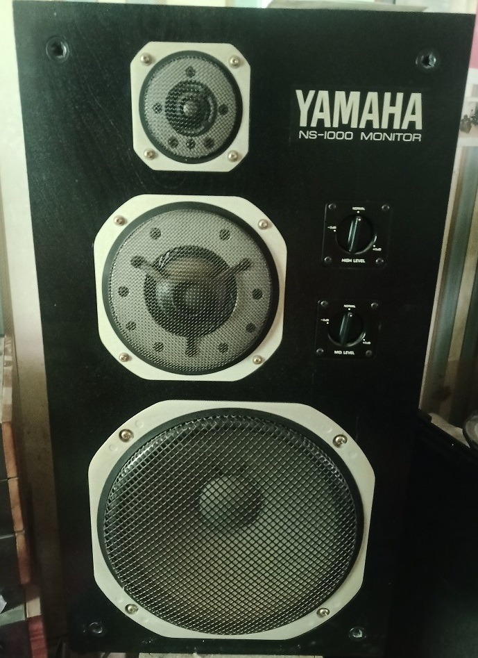

Just rechecking old pictures: somewhat worried by the obviously cold soldering on pots, (and maybe somewhere else) :
Maybe you can add a dab of solder, with a larger tip/power soldering iron?
Those thicker than original wires can certainly suck heat away from soldered spot.
hi, those filters are the original ones and were replaced by newer ones and in perfect condition
I´m talking soldering, not pot quality.
I also see flux/rosin sputter around, that is NOT Yamaha workmanship by any means.

the photo filters have been kept in a box, the new ones don't have those welds, it doesn't matter what was there before because it doesn't have it anymore 🙂I´m talking soldering, not pot quality.
