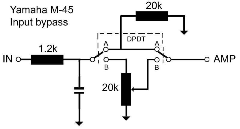

Hi y'all, back again.
Another quick summary of what I found possible at my beginner skill level that worked out nicely...
1) Speaker posts are worth replacing. Mine were cracking apart and crumbling in my hands; cheap old plastic. New posts can then allow for banana plugs. Also the daughter board for speaker C is jumped by something similar to an OK quality but THIN ~20ga computer ribbon.
2) Relay board. A Definite yes. It's worth making your own relay board with nicer parts. You can re-use the other components on the board (inductors, resistors, diodes). This was the fun part.
3) Shorten and improve speaker out wiring (to relay, and then to posts). Easy to do.
4) Hard wire bias to AB. Easy and keeps the amp more reliable. Lots of reports the Auto-A mode worked unevenly between channels (mine as well).
5) Bias pot... I upgraded mine to a 10 turn with no ill effect. A decent quality single turn would be OK as well. In all cases, replace the pot. It's easy. Bias does have a very wide range. Manual states 10ma, but I had finally upped mine minimally to 12~15ma. The auto-A pushed it to 100 from what I remember, but again, unreliable.
6) Bypass the input level pots. My pots were very clean, so no desire, and you'd have to dig deeper into the harder to reach areas of the amp to reach the connection points. Just a matter of preference here.
7) Heavier power cord. I'm sure we all have a drawer (or drawers) full of power cords chopped from dead gear. Didn't take too much effort other than grinding the hole larger (it's heavy steel on the back). Matched the looks better, big cord for a big amp.
7b) Soldered the power wire-wrap points, power switch, and added more bridging wire to the power fuse board, as there were more holes/points available (Yamaha only installed a couple), so why not! If you swap out the power cord, you're already half-way into doing this. Remember that if your amp had a two prong cord, do not connect the earth of the new cord to the chassis. The chassis is connected to audio ground. There is the possibility here of experimenting, by putting a resistor between the earth and audio ground.
7c) Also make sure your fuses are of the proper rating everywhere, especially if you bought your amp used. Also clean off the dried up foam on top of the transformers (looks lots nicer). Check that your transformer mounting gaskets are still soft.
8) Capacitors. Mine actually seemed to be OK (no sign of buzzing. hum) so left them alone. The main power caps would involve a heck of a lot of un-wire-wrapping and de-soldering. The two obvious power caps on the mainboard would be more manageable. These are older amps, so it is about that time.
9) Triple check everything!
That's it for if your amp was already working, and you just wanted to update the manageable parts. As for blown transistors/channels, seek professional help.

I'm thinking of putting in a bypass switch on the rear for direct input
connection vs. pot volume control. No harder than permanent bias AB from Step 4. Make sure you study the schematic so you don't
bypass a critical circuit. The wiper at max ohms is a short to
ground (mute) while the wiper at close to 0 ohms is a near bypass
of the pot.
The input is a resistor to pot and cap to ground. . .after the pot. .
the input resistors and caps before the LTP.
of the pot.

Need two DPDT switches--one for left and one for right: if mounted on
back the input wiring will be longer.

re: Bias pot. Understandable, and I agree 99%. With the M80 being quite touchy, there is a lot more control with the multiturn to get both channels even (remember to tap it when finished, and then re-measure). As for current handling, I'd trust a single turn. (~I'm learning; though no problems so far) Just wondering why quite a few mid-level amps I've seen use the multi-turns for bias (like my old Aragon). Haven't been able to peek into amps that cost more than a car yet... Would have to buy drool insurance....
re: Bypass the input pots. Why not? (real question) When I want to test, I use ground-shunted rca plugs on the input to mute, or use an external volume control (passive).
re: Replace power cord. Although not an advantage electronically, it can just look better, be a more durable type, even a correctly rated modular socket could be nice. Just a matter of preference. Make it your own! Won't hurt any!
Bypass input pots:
just need to replace the same resistance to ground that the
input pot presented in the circuit.
Bypass input pots with switch:
. . .tricky I just realized. . .any switch noise will go on to be
amplified at full scale. Ouch!
