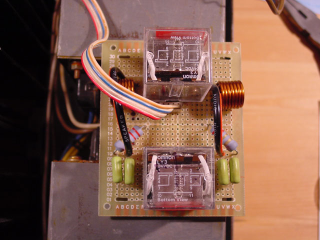

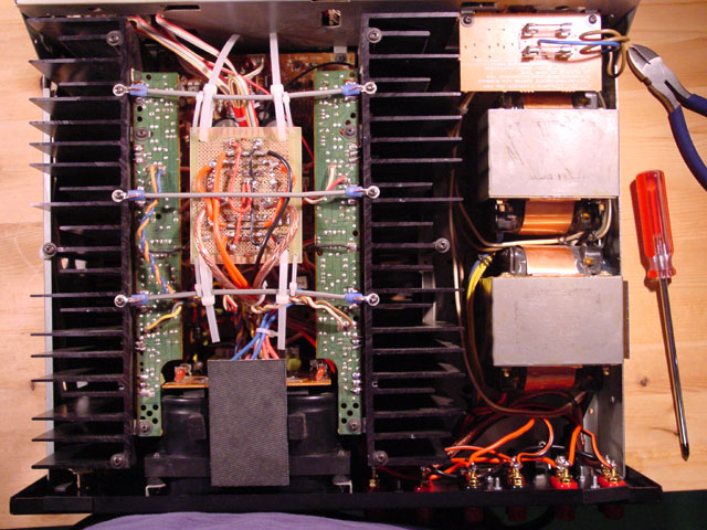

1-Shot, 14 straight hours, no breaks, total concentration, no rushing, and complete success.

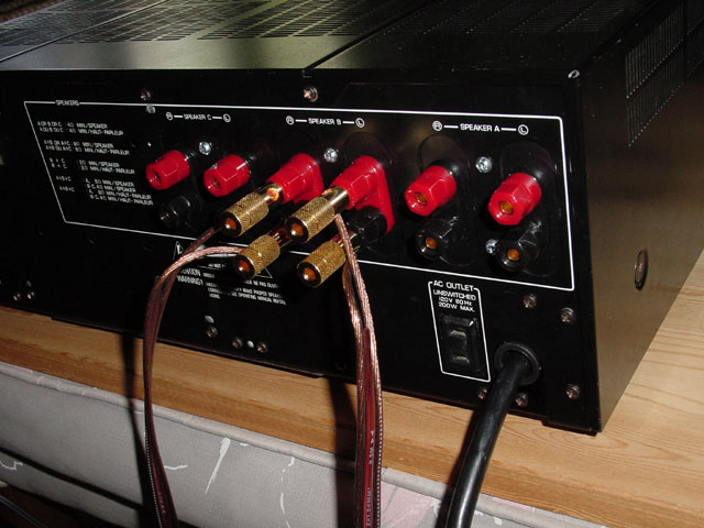

1) Built my own custom relay board, with some relays I had picked up. Hand calibrated the contact pressure, and cut the middle pole (3P relay) so there would be better pressure balance. Prayed that they'd get enough juice to drive them... The prayers worked. Mounting is much more reliable now that I could make proper holes.
2) Bypassed the Auto-A switch. Why have 2 bias resistor feeds travel through 2 feet of wiring??? And leave it open ended when switched on? Unreliable. Stated idle bias should be 10mv, Auto-A 130mv (seems to only do about ~80mv for the amps it actually works on), I set the idle to 40mv... gets lightly warm, but nothing extreme; probably more stable than the Auto-A would ever be too. A good balance.
3) Used heavier wiring from the relays to the posts, Used 12G for the ground and 16 for the outputs. Anything thicker won't fit. 12G is pretty much the limit for soldering.
4) Changed the power cord to a 14G heavy-duty one. Found a great gasket to fit it. Just needed to grind the hole a bit bigger. A modular socket would have been way too much trouble.
5) Wired directly: the power cord to the switch (+fuses) and transformer lines. Removed the wire wrapping posts, and soldered the power wires directly in.
6) probably did more, but it's all a great blur now....
Last things to consider doing...
- Redo the core wiring; No. Yamaha used heavy copper wire for the signal and normal steel for feedback. Decent job, not worth changing. Was easily able to reduce some length on the final output-to-relay section.
- Power/Cap board wirewraps; maybe hard solder. BUT the huge smoothing caps make the underside inaccessable. The wirewraps are very well done anyway. Maybe could solder the wirewraps, but no apparent need.
- Precision pots for the bias; Yeah. I picked up some presicion single-turns, didn't install them. Multi-turns would be better for this amp. The bias can swing from 0 to 200mv+ (I didn't try any higher) with a simple 1K pot. Yeek, big swing! But the original pots seem to hold stable when worked with to the get value you want.
- Transformer vibration gaskets; No. After some poking, they still seemed soft. The tops of the transformers could easily be affixed to a piece of polycarbonate or aluminum with hot glue or acoustic adhesive to add a bit more dampening. Easy to do this anytime.
- really nothing more necessary... Yay!
Final Notes:
- Yamaha schematics seems to be more of a guideline. Some parts aren't installed. Sometimes part order differs (manual: cap-resistor-cap, reality: resistor-cap-cap). Best to follow how the amp was actually made, and add your own touch.
- Yamaha uses audio ground for the chasis. And there is no way to get around this (in order to switch it to earth-ground) as almost every mainboard mounting hole grounds to the chasis. Not a biggie, but I prefer chasis earthing for safety.
- The gold plated Yamaha relays are 4 pole and rated at 5A per, that's why they doubled up the connections. Slightly unreliable, as I had noticed 1 of the poles had some arcing damage. Better to use a simple 2pole 10A type....
- Since this worked, and I didn't set the house on fire, It was quite a fun project.
