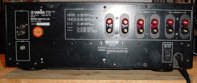

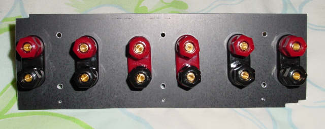

1) Gold binding/bananna posts have been added. Mounted on a very strong anodized black aluminum plate.
2) Twisted feed line length to relay board has been reduced
3) Speaker feeds connected directly to the relay posts! Not through more traces.
4) Yamaha uses different relays for different outputs, so relay 1 cleaned, relay 2 replaced with relay 3 (unused) (relay 1 is supposedly an arc reducing type, relay 2 has gold plated contacts; don't ask me why they chose to do this)
5) Speaker posts A and B are accessed by switch (C is disabled; why connect in series patched through another relay???). Posts C are hardwired in parallel with B, that way if you want to bi-wire... easy!
6) Removed the dried up rubber insulation sheet on the top of the transformers. A possible option to replace in the future if desired.
7) The enclosure may still be a bit scratched up (not my fault; previous owner), but the guts are nice and clean now! Front faceplate is in good condition.

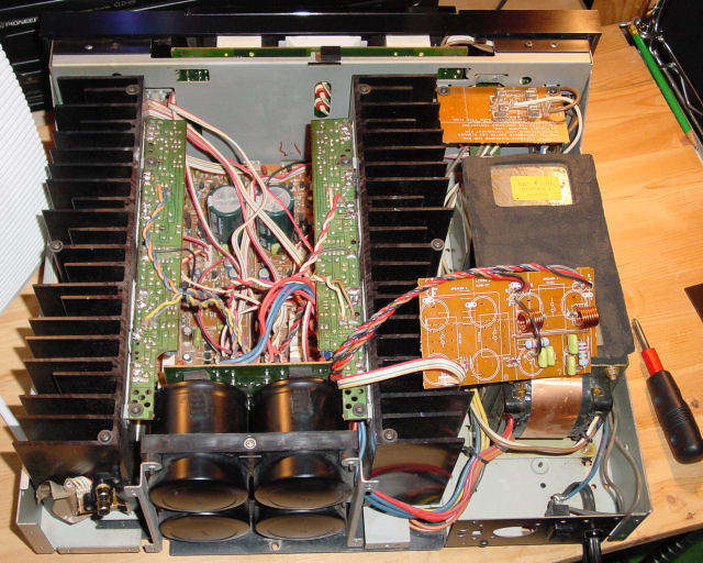

Just getting to that....

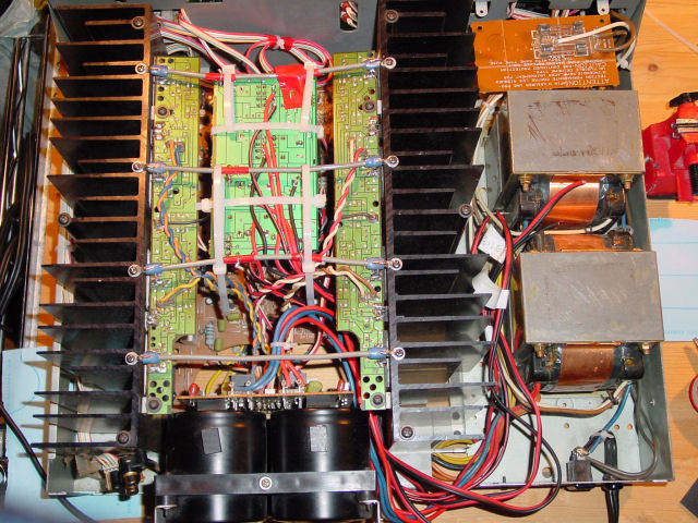

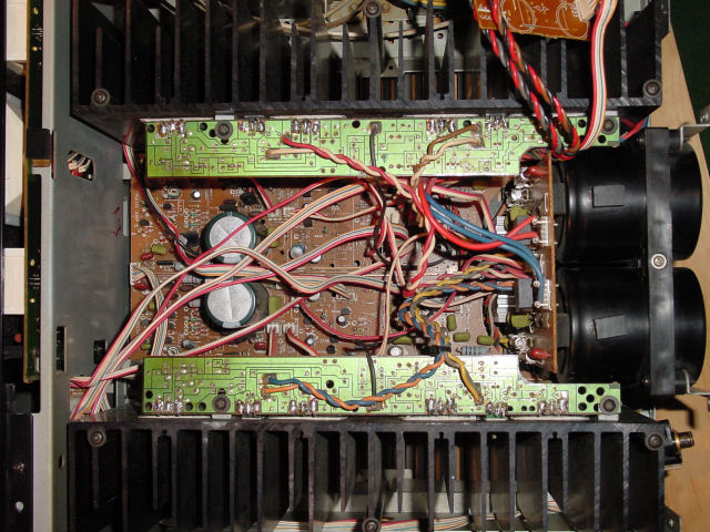

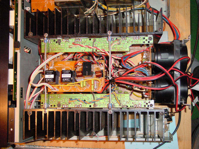

Biggest time waster was trying to figure where to put the relay board, as the original crappy-plastic yammy binding posts suspended the board near the transformers. Found a good spot (reducing lead lengths, and still good airflow.
Thanks free mounting holes on the heatsinks, I could securely bridge the gap to suspend the board. (the 4 grey wires).
Picture 1... guts out!

part 8...

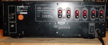

All done! Just a front shot...

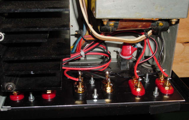

Looks to easy, because you don't see any of the HELL of making a mounting plate for the posts... actually, wait for the next post...
I may toss in a shot of the gold plated relay at some later point. Never took any, but I'll keep the one I pulled as a backup.
There are actually 2 speaker out boards, the one you don't see in any shot was pulled out earlier. It's just square with no useful parts. The jumper Yamaha used for it is just a decent grade ribbon... yeek.

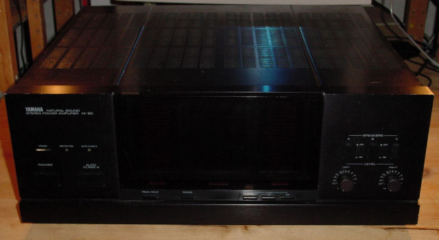

pain in the BUM!
Looks simple... but try cutting metal with a hacksaw with arthritis! And drilling without a drill press!! I had to use a tapered reamer to bring the holes up to size, then de-burr. Shoulda taken a picture of my hands... BALLOONS!!!
But I took care... filed the edges evenly, made sure things were square.
You might be able to see making tape residue line...

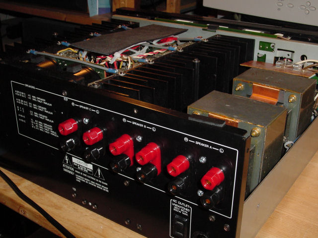

TRUELY THE LAST SHOT
Just a demonstration...

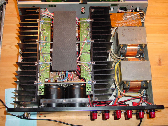

This is the limited space that held the relay boards. The relay board had no actual mounting holes (just the binding post beams held it). So, I didn't want to drill into the board, nor make a crazy clamping mechanism, PLUS I wasn't too into the idea of having the relays close to the transformer in the first place.
Putting the relay board over the main board really reduced the feed lines (3 wire twisted), and a lot of mess. Plus still quite roomy.

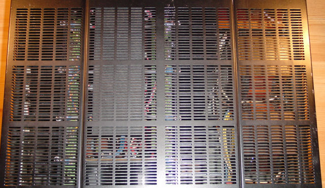

Would have liked to install a modular power socket, but I really wasn't in the mood to carve into the case, especially steel.

In the future no one ends up wanting it, and I have money and time ... there's lots more that I could do.
