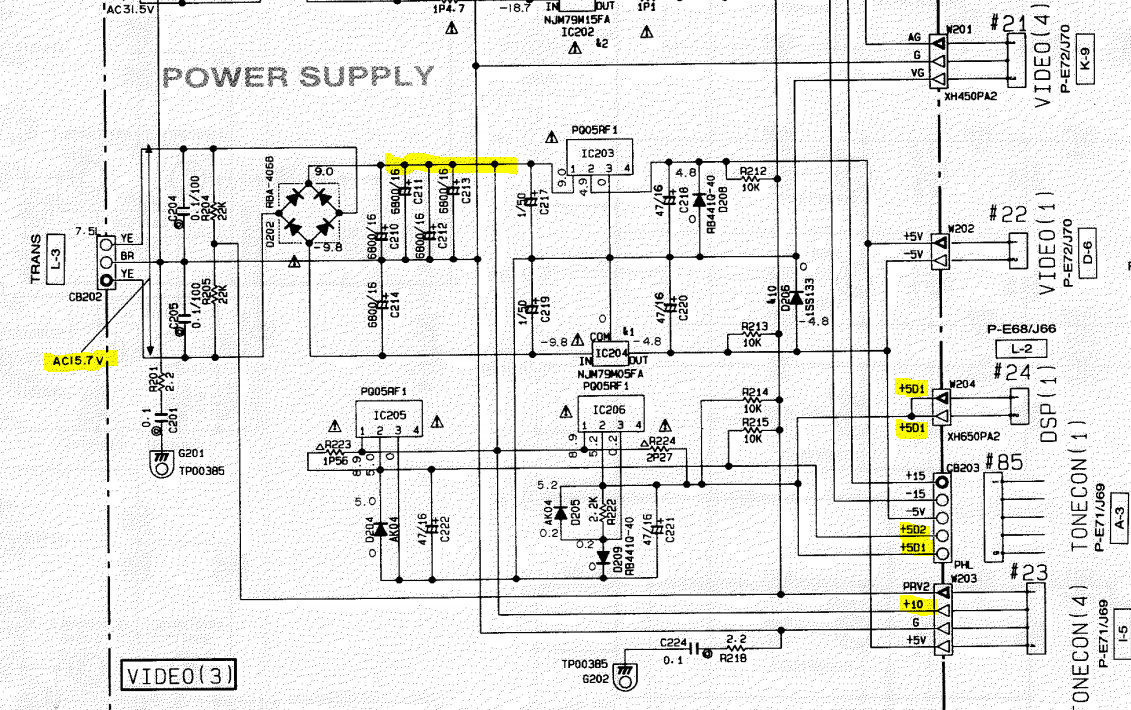

The power transformer have 3 AC voltages.
73.4v RE RE
42.7v VI VI
6.9v OR OR
I have
82v RE RE
46.6V VI VI
6.4v OR OR
What you have is high with 82v and 46.6V. But that seems so Ok: the box is in protection mode, with no load by most of parts, including power parts. So such voltages can get a bit higher.
Then I beleive a litte bit low for the 6.4 you found. Shall be 6.9. Either your voltmeter is inacurate. Or the 5v sections are using too much curent.
6.9 x 1,41 - 1,4 = 8,35, what is needed to generate 5V.
Check some 5V lines, on different boards.
Take care. 73.4v or 82v is letal. Don't touch such sections.

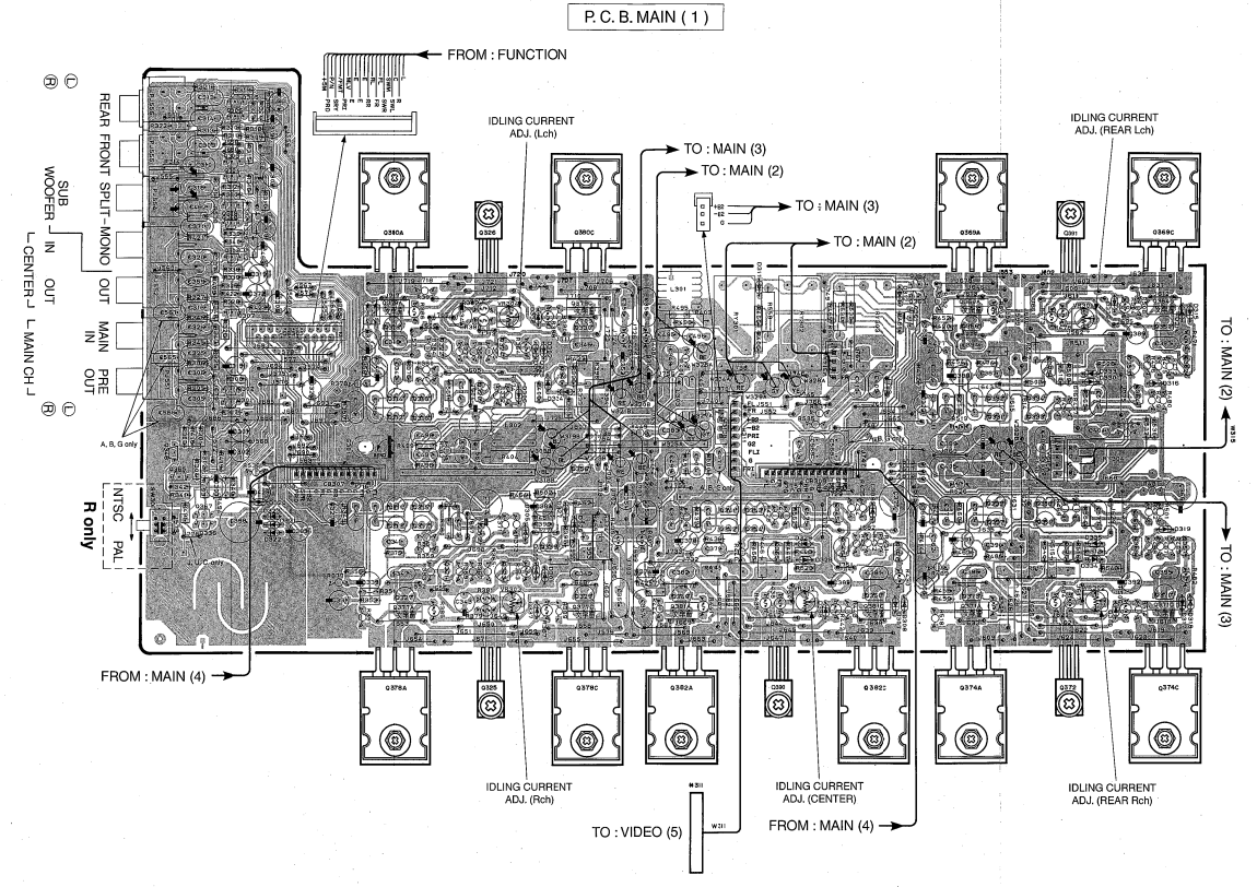

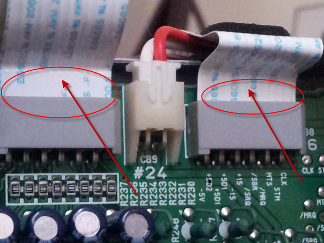

I asked for pictures, saw none. Is this the way boards are mounted?
Can you fully disconnect boards, keeping main, controller and display?
If yes, I would test now 5V rails, then disconnect some boards. To see if 5V / 6.4V rail voltage raise.
If you disconnect power connectors, disconnect also the other signal connectors for the same boards.

Assuming your voltmeter is accurate, 15 is lower than 15.7.
Is any IC (on DSP, so on) a little bit hotter than others?
It may get a bit more complex now, assuming the 5V rails are almost correct (4,95V). I saw test points, but they all need an oscillocope.

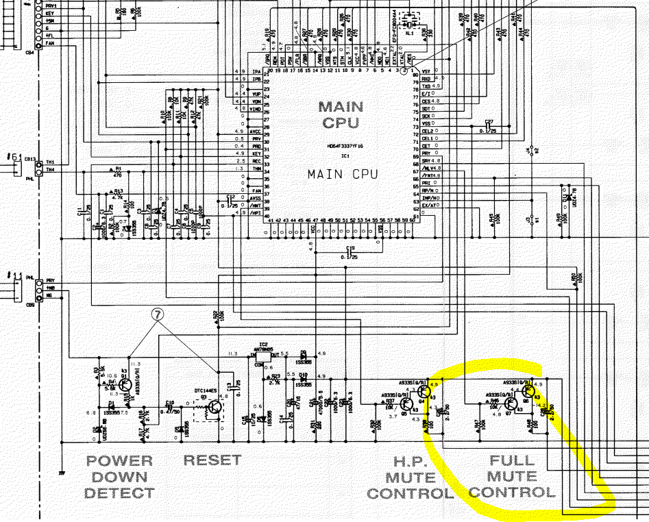

Processor can bring the box to a safe non workink mode, or that mode (dead) indicating the unit needs maintenance, has also feature to mute everything.
I'm not sure that logical part can be debuged in a easy way.

the transformer outputs should be in proportion to the windings as design
but its not here,
two outputs 1/10 higher RE Re, Vi VI, for power amps,
one output 6.9v ok 6.9v is for filaments,
if a Variac is used to lower down the mains to test will be much easier.
or use a dim bulb in series with the mains to test.
unplug all the secondary connections of the main transformer,
if it switch on, measure all the AC voltages if they match the schematic.

Block diagram is on two pages, huge, with a lot of chips. That won't be fixed by testing transformator and output transistors.
If it is old and cannot be fixed, I would think about pulling out the amp board and heatsinks, the tranfo, the amp PSU, for four channels, maybe to be bridged. With all electrolytic capacitors replacement.
Excedent components (not part of the four channels) to be removed.

All is linked inside, and a processor checks the status. How do you want that box to start with part of secondary power lines unconnected?
I suggested to disconnect some boards, to see if the display would start and show any error (would depend of software capabilities).
