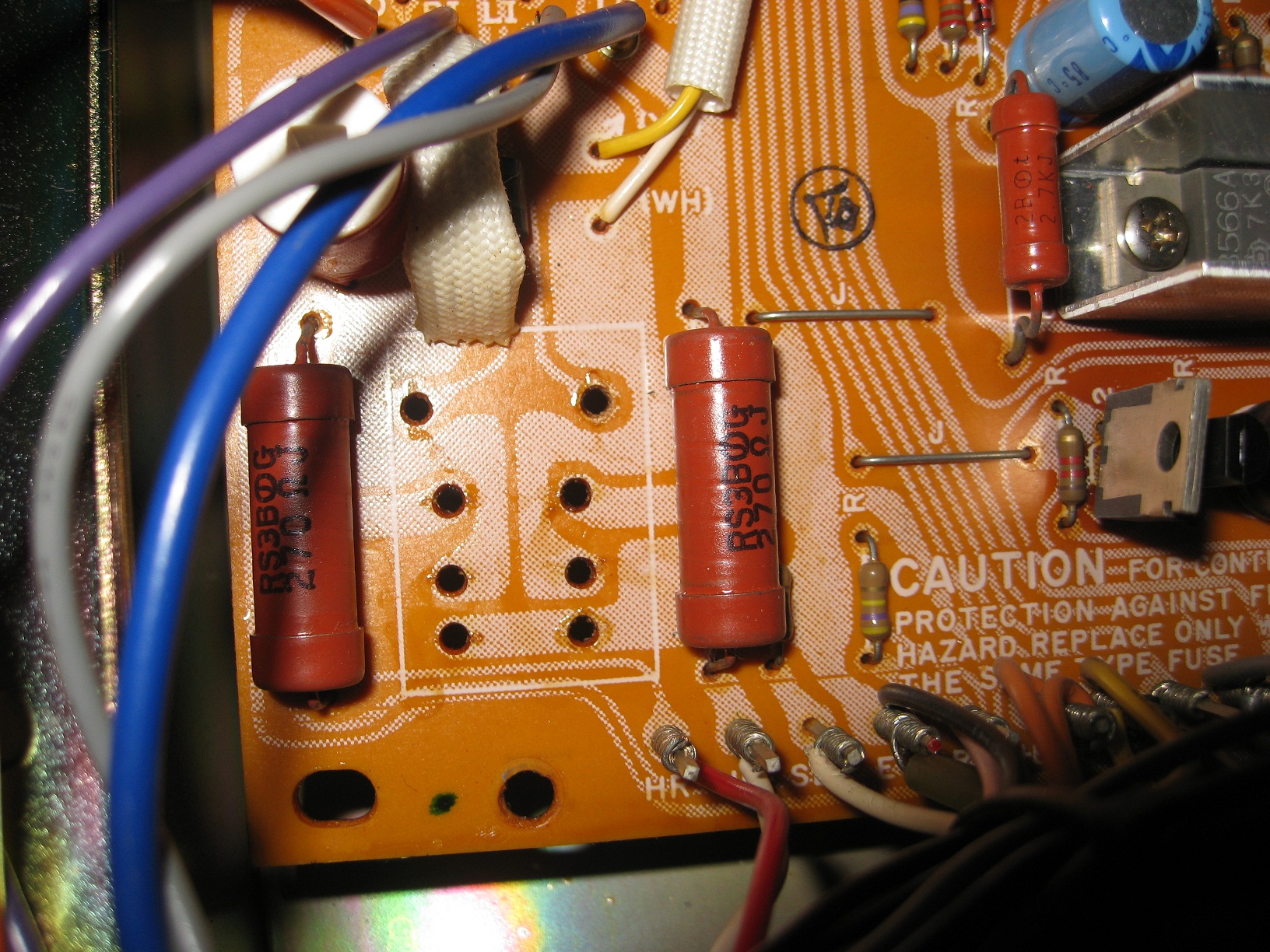

The right channel "disapear" sometimes or i got fuzzy tones from it. I have located a problem
It is a speaker relay underneath the amp.
I have opened it and cleaned with a buisness card etc and the problem dissapeard for a while..2 months
Now the problem is back and i wonder if you can help me with another one.
I have no idea which one do i need.

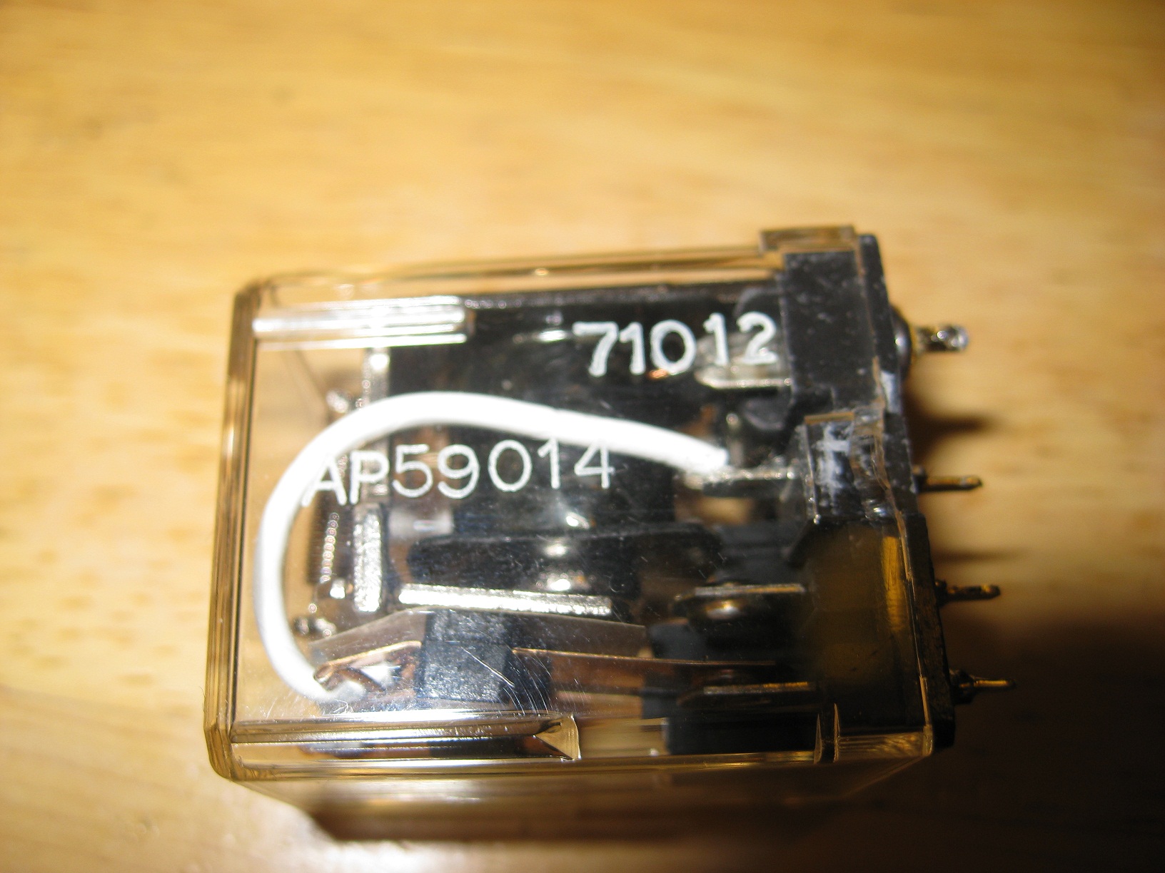

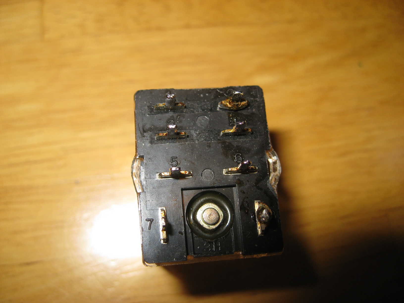

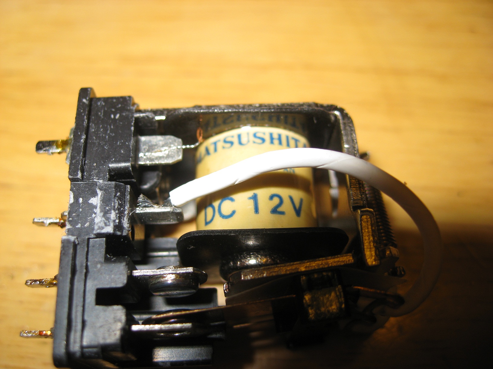

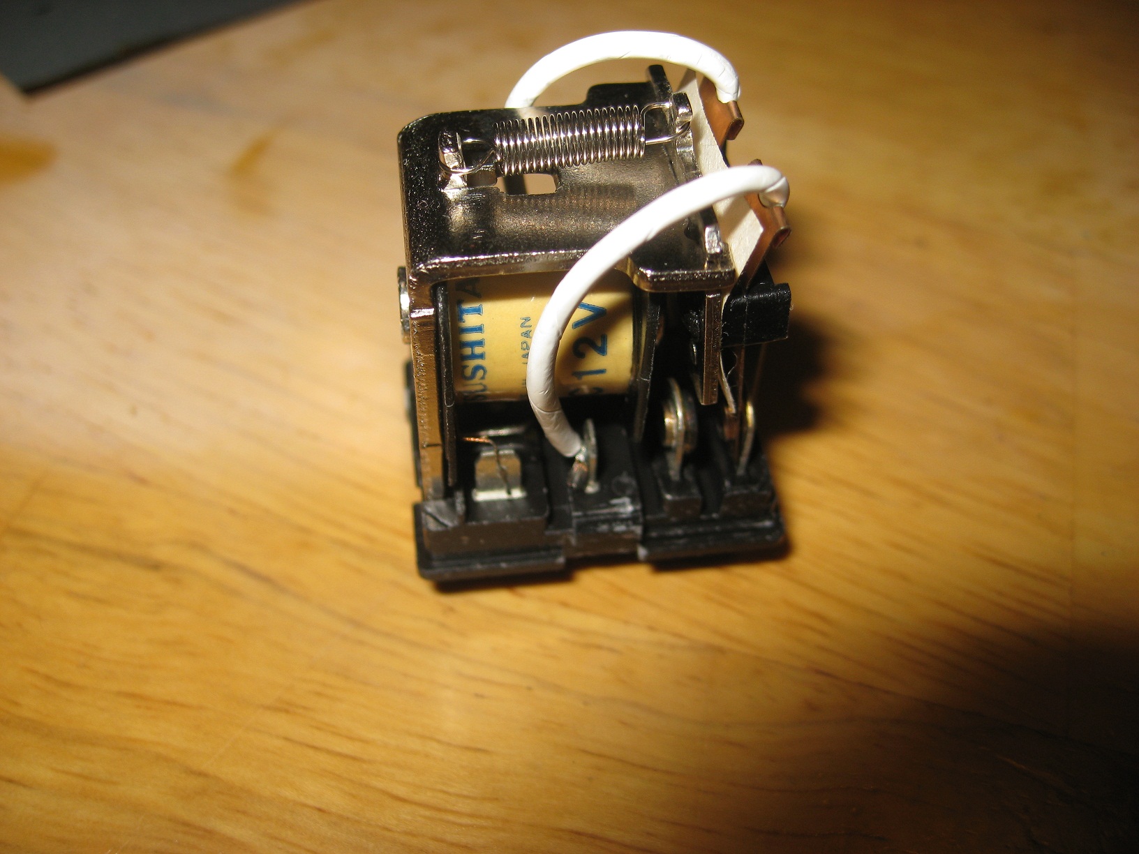

We have 230V in Sweden.
as you can see it says
Matsushita 12V
71012
AP50014
and i´ll send you a pictures
YAMAHA CA1010 have 2 relays
one for speakers and one for CLASS A A/B
Is it a same type relay on both sides ?

cleaning the contacts is also my first idea. Have you measured the 12V DC for the relais? In some old amplifier the voltage lose by ageing of components sometimes. Capacitors for example.
When the voltage is to low the relais pull to weak.
