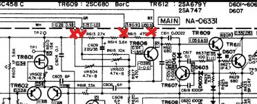

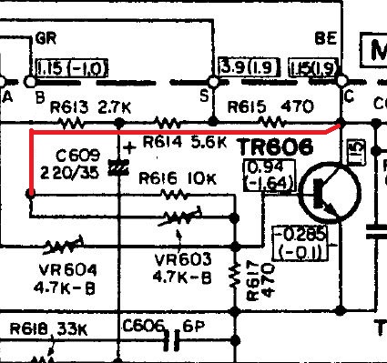

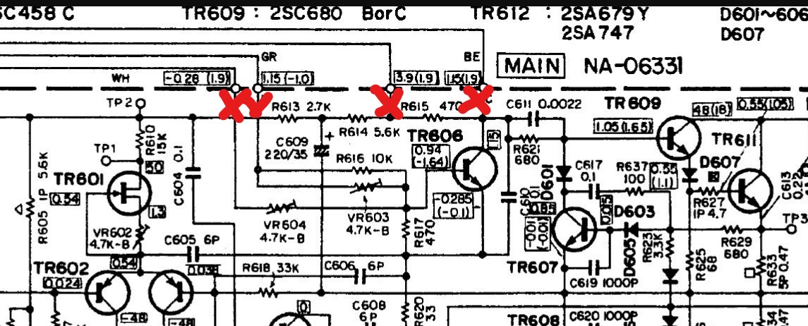

Ok. Not trying to be difficult (or dense 🙄), but if I want to test whether the switch is a problem, why not disconnect the wires for A, B, C and S at the amp board and jumper across the pads for B and C, i.e. which go to the collector and base of TR606?
If you jumper B and C you will just fully turn on the vbe multiplier which should give an identical result to how it was when you linked it out.
You need to set the bias to some test level and check it is stable and that means using a preset. Obviously begin with the preset at a near short to avoid to high an initial test current.
But flipping the operation switch to "Normal" bias connects the wires going to amp board terminals B and C via the sliding switch. If what we're talking about is confirming that there's no problem with the switch, we'd want to bypass the switch connection by removing the wires at terminals B and C and jumpering them at the board.
You have to isolate the switch from the circuit first and just tag a preset between base and collector 🙂
Switch contact can certainly go intermittent. In AB pins B&C will be short. Connecting a jumper between B&C, leaving all other wires in place will take the switch out of play.if I want to test whether the switch is a problem, why not disconnect the wires for A, B, C and S at the amp board and jumper across the pads for B and C?
Expect VR603 and R616 still control TR606 with B&C jumpered?If you jumper B and C you will just fully turn on the vbe multiplier which should give an identical result to how it was when you linked it out.

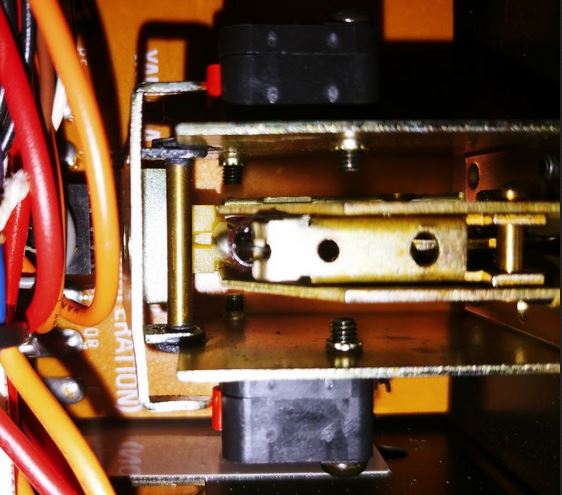

As for the switch , can you show a pic of it?, you described it earlier as a micro switch ?
It should have been able to 100% eliminate it miles ago.
Depending on the style/make of switch you may be able to push it into misbehaving by interfering with it physically (but gently) once re-enabled

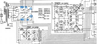

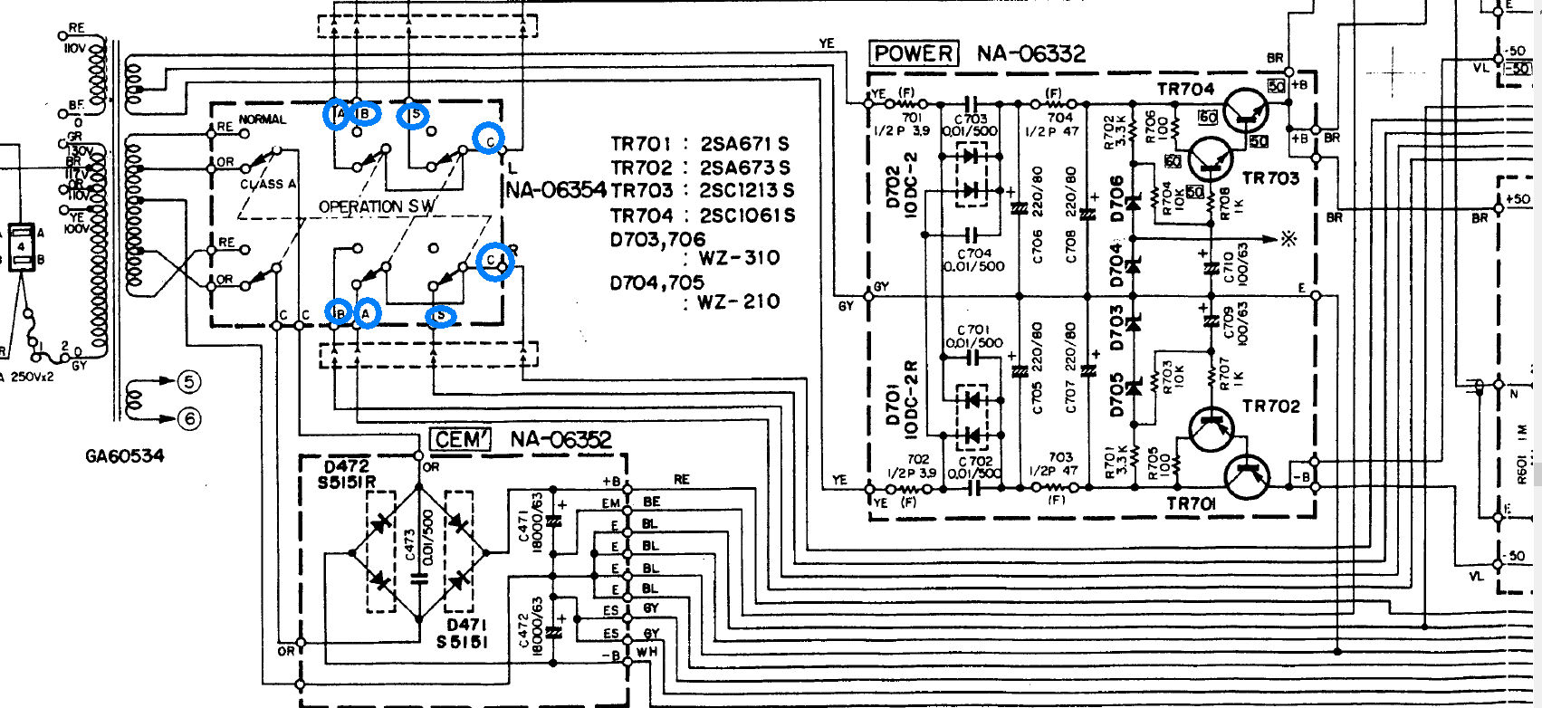

It's a sliding switch that connects and disconnects parts of the bias circuit in each channel and at the same opens and closes two micro switches that go to transformer secondaries. I replaced the micro switches. I desoldered the sliding switch itself and ohmed out the terminals, with each measuring 0.2 ohms.
The whole thing is the "Operation Switch" in the schematic snippet.
Yeah I saw that - just thought I'd recognise it visually too
Although the rail switching element is important the other contacts are more importanter 😀
Check the legs (between body and pcb if you can see them) for signs of blackening/tarnishing to see if it a candidate for being totally at fault as intermittent contact with low current passing over the contacts.
The microswitches will be badly tarnished, you can get various operating force versions, although it won't make much difference to the feel. The stronger operating force versions do have a better contact though.
From expereince after seeing the pic the main switch contacts will be knackered too, I'd always try and overide with relays rather than try and clean them up on an important switching circuit like this ,.... you'll end up with a way better, more rerliable switch.... and you'll take all the streian off that ageing switch by doing all the switching with nice shiny relay contacts.
Checked the new snap switches I had installed (photo shown by mbz isn't of mine). The metal bar that depresses one of the pins did have a slight bend to it, which after straightening pushed the pin in a little further. Kinda doubt that was the issue, but at this point I'm running out of ideas. . . .
