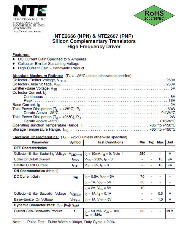

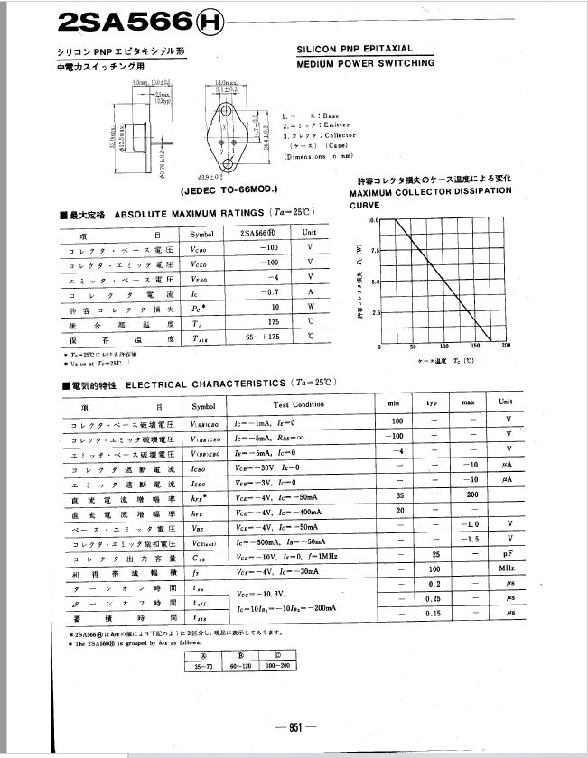

One key component that I changed after the initial damage was the driver TR610. The original 2SA566 is in the obsolete TO-66 package, so I needed to sub in a TO-220 package. Having read that people have replaced 2SA566 with an MJE15033G, I used the equivalent NTE 2667. (Not ideal, but it was handy.)
Another component I changed was TR606, swapping out the original 2SC458 for a KSC1845. (Yes, I should have left TR606 alone, since it was ok.)
  1. Could the NTE 2667 at TR610 cause the crazy bias readings? Or the fact that I didn't replace its complement TR609 with an NTE 2666, and instead left in the original 2SC680?
  2. Could the sub of a KSC1845 at TR606 be at fault?

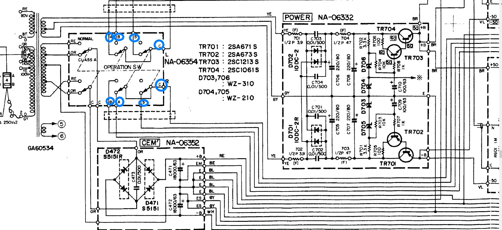

Those connections all go to what Yamaha calls the operation switch for toggling between Class A and Class AB bias. It's what WhiteDragon is referring to in his post and consists of a central sliding switch and two micro switches. This is how it was explained to me in an offline exchange with someone who's worked on several CA-1000 amps:
A,B,C and S are not power supply pins as such, they are more about selecting and connecting the wanted VR for Class A and AB. In normal pins B&C are shorted togher, for Class A pins A&C&S are shorted. These pins are helpful since they provide easily accessible test points. Also, if the voltages for the shorted pins are not the same then need to clean the operations slide switch, next to the snap switches, the slide switch performs the shorting, the snap switch does the high voltage/B+ switching.
Sounds like I should measure low ohms between solder pads B & C on the amp board when the switch is in Normal (AB) mode, and between A, C, and S in Class A mode.
I have already removed the board these switches are mounted on and checked the sliding switch with my meter. It measured .02 ohms across the contacts in each position, so I didn't disassemble it to try cleaning it.
