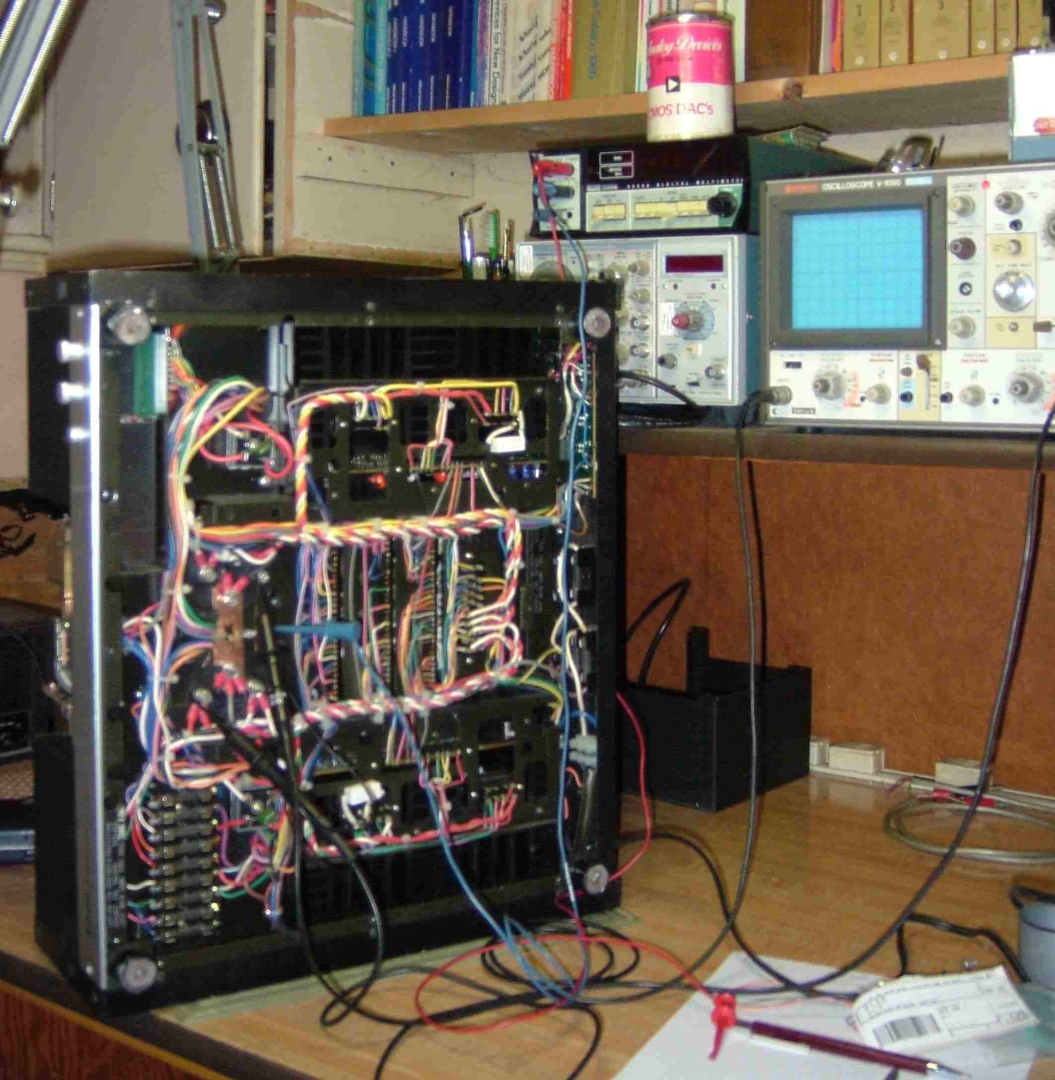

I have two B1. I use them for 5 years and they were working fine. In 1995 I stop using them. I want to use them again. Can they be turn on after sitting for 15 years? Thanks voodolounge
If it were mine I would first take out the driver boards and the output V-FET modules. With those removed I would power it up and check the power supplies for proper voltages, especially the -200V bias supply. Recapping the power supply and protection boards would be a good investment too.

It is possible to repair these with modern FETs instead of the 2SK77's, but it takes a long time (weeks!) due to multiple failures that are consequences of the output devices blowing. The schematics are also wrong around the driver/output stages.
A VFET can be made from a Enhancement MOSFET by adding a couple of resistors. Essentially a 39K from Drain to Gate and 6K8 from Gate to the original gate drive. I used a pair of 2SK1058s to replace each 2SK77. I think fan cooling is also advisable.
You need to make sure that all of the protection circuits are working (in a logical order), otherwise you end up blowing up the repaired output stage. This usually means replacing all of the power transistors that switch the B+/B- supplies in after warm up. The protection circuits for each side are cross coupled, so if B+ is shorted, then B- is switched off.
I ended up with a bag of about 30 transistors that had blown before getting it working again.
The main problem is that the Yamaha has +/- 90 V power supplies, so is capable of delivering extremely high peak currents. Even testing the current limit protection is scary, as the shorting wire can vaporise when you touch it on the B+!. The -200V (from -300V) supply is also scary.
If you just want to use the power supplies, then they are usually too high voltage for most circuits. The issue is getting rid of a lot of heat- though fans help.

My suggestion is to check the amplifier in stages. However, you will need to be an experienced electronics engineer to do this, and there are plenty of lethal voltages inside the B1, some of which remain for weeks. It's a big job, and you will need the service manual, as it has a complete set of ordered instructions. Only when all of the supplies and protection circuits have been tested, and the biases set low, should the output transistors be added. Also, as the Yamaha does not have bleed resistors on its main supplies (which I added), the main caps can remain charged for weeks. Thus, plugging in boards can be dangerous and blow things up. If you are unsure about anything (and the schematics don't help much as there are errors particularly around the driver stages), then beware.
