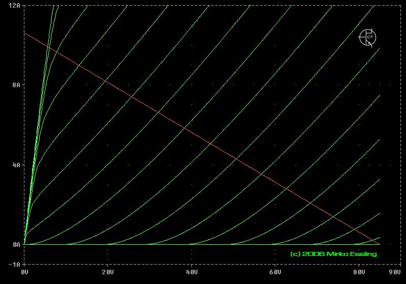

It is obvious, that this stock IXYS part can't be directly used, but with some external circuitry at least at AF you come pretty close.
This was extensively simulated and then proved to work within a real circuit and compared there to a real 2SK77. After some tweaking of parameters I got close, probably less than the production deviations for the 2SK77 (around the operating point as used in the B-I).
Funnily my Cold Triode (TM) even sounded better than the originals in my B-I, so my emulation was probably not as perfect as I thought ...
Please find transfer curves appended. IMO more linear than any SiC device or any thermionic triode ... 😀

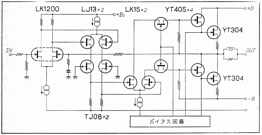

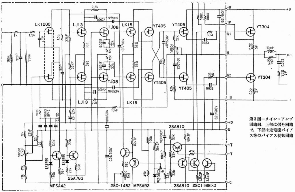

That's somewhat inaccurate but largely correct, it's a 'SEPP' arrangement where the diving voltage is bootstrapped to each source.
I'm attaching two images to this post, the basic topological layout of the B1 in the first, and the actual schematic in the second, this is from the prototype documentation.
For reference, YT-405 was the original prototype marking of what was later to become the 2SK75, and YT-304 was the prototype for the 2SK77, although the YT-304 had a bigger die and was capable of drain currents up to 30A, whereas the 2SK77 is slightly reduced to 20A, with corresponding reduction of the input capacitance (which was most probably the reason for the reduction).
As can be seen, it's a triple differential design, with the last differential stage cascoded from a rather high negative voltage rail in order to provide the necessary negative bias to the output stage. The ouptuo stage itself is a VFET 'darlington' which means the negative bias voltages of the 'darlington' stages add up to quite a few volts. The important bit is that the gates of the 'darlingtons' are connected through resistors to the corresponding ;darlington' source, so the voltage between the gate and source of the VFET 'darlington' combo can at most be zero. The 'darlington' drivers CAN actually drive the YT-304 (2SK77) into a positive gate region but the current is inherently limited not only because of the series 39 ohms resistance, but also because any positive voltage on the YT-405 source, while the total 'darlington' gate-source voltage is zero, means the YT-405 sees by itself a negative Vgs, limiting the current. On the actual schematic we can also see that the YT-405 that are in the VFET 'darlington' have their sources pulled to a negative rail through current sources.
Although the whole thing does look symmetrical and the top and bottom half of the totem-pole outputs have their driving voltages referenced to their respective sources, this does indeed suggest (and bes describes the operating mode as) common source connection. But there are a few points which make the output slightly asymmetric - for one, the upper half provides current for it's driver (as it comes from the output) whereas the bottom half driver current comes from the output stage negative power rail. Although the driver stage itself is cascoded, the cascode elements are VFETs, which have a triode characeristic, so their gain/transconductance depends on Vds, which is different for the upper and lower half driver - constant for the lower half since it's referenced to the output stage negative power supply, and variable, but on average higher by the magnitude of the output stage negative power supply, for the upper half driver. Because of the cascode arrangement this does not manifest itself greatly but it's still far more present when compared to pentode characteristic devices in the same place.
Neither of the above 'asymmetries' are really a big problem in practice. and are more of the academic kind, but I mention them here because they are actually typical of topologically similar tube designs, for instance a Futterman OTL.
