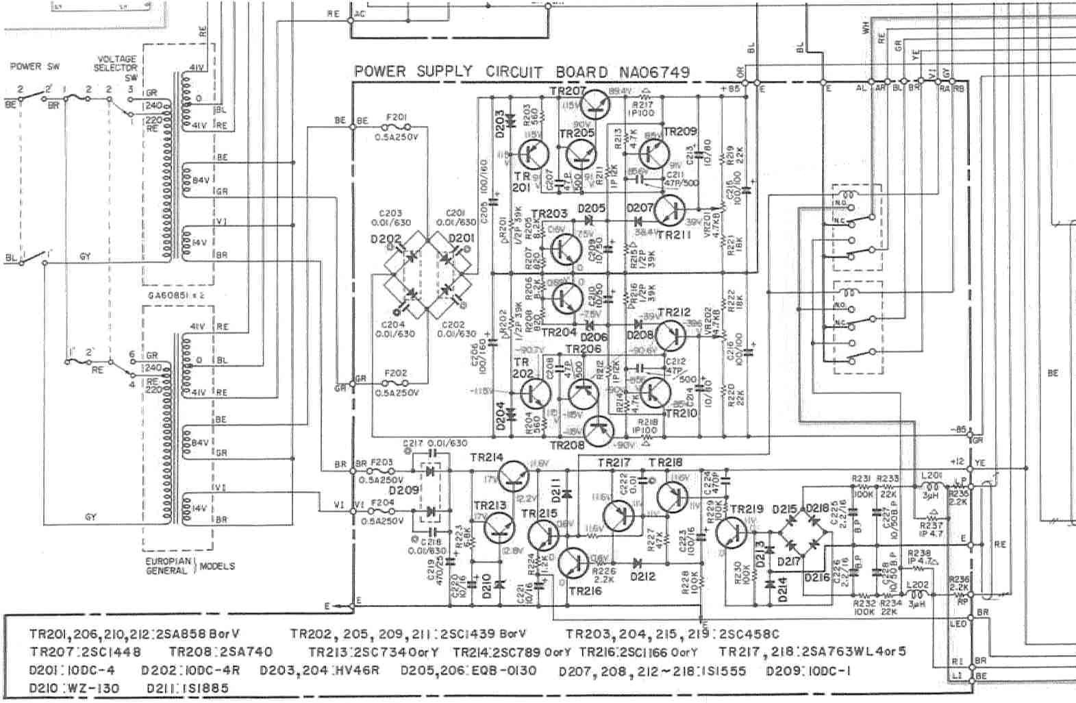

Hello!
I can't adjust the bias and DC offset on my Yamaha B2 amplifier.
I have a problem with the +/- 85v power supply. On the negative rail I measure -60V and I can't adjust the voltage from the trimpot in any way.
Can anyone give me some advice?

yes, the advise is to shut the power off and say a prayer or two that the vfets are still OK.
  1. make sure the unit is unplugged, bulk caps are fully discharged.
  2. test the vfets individually without mixing them.
  3. If the vfets are still OK, look for someone to rebuild that unit. After ~45 years of service it should not be operated without proper restoration.
