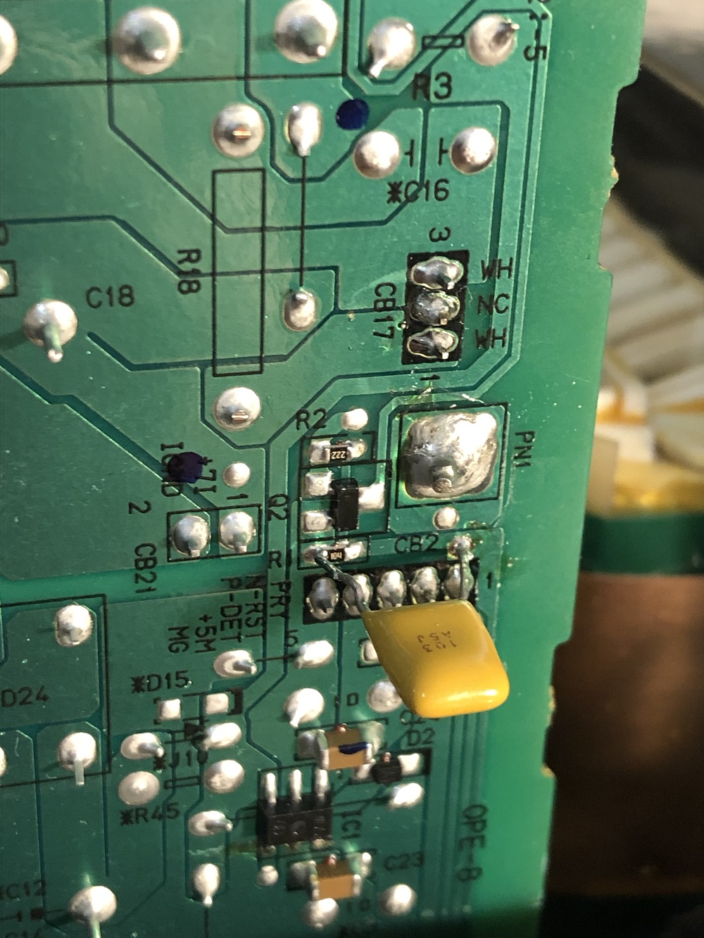

*It can help to add the smallest you can find so 2.5 mm pitched 10 nF cap over the contacts. Had this with other devices that randomly switched on and off and/or refused to either switch on or off.

Never opened this exact version as I just replace this type (it is used in many devices) but they may have gold plated contacts. Gold does not corrode and sanding makes no sense then. It may have corroding contacts and then sanding is a temporary measure. The replacement has silver contacts but exists in gold plated silver contact version. Sanding contacts is from granddads time and was mainly done with sturdy power relays, it does not make things any better for decades now with placed/coated contacts. If pitting occurs the wrong relay/switch is chosen. I have had Sony amplifiers with comparable problems that switched when a smart phone was near. Then the cap helped. The cap also helps when the contacts bounce but it may then be necessary to use a 100 nF.
