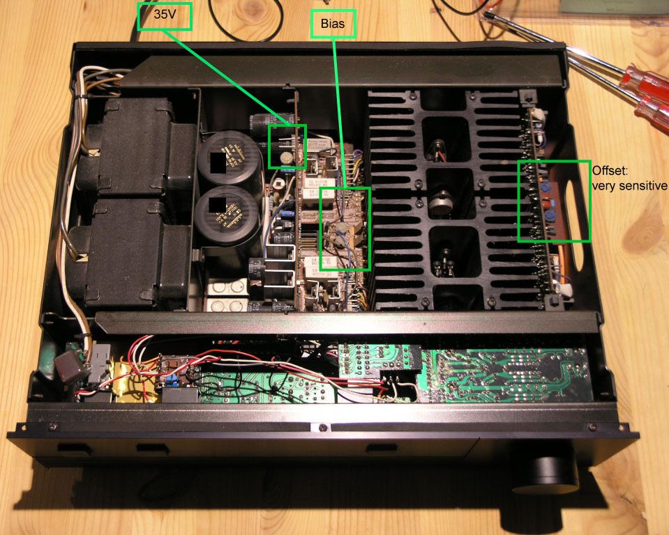

Offset is minimal at the speaker output. 2mV (left) 12mV (right)

Some interesting notes:
1) The 100ohm (VR501/VR502) offset pots (on the NA07040 board) are incredibly sensitive. Not because of their age, but the fact that they swing from +/- several volts. Is there any way to decrease this range and make it more precise? I predict multiturns would not be of help. I've been able to get it set within a ~10mv deviation from zero, but it differs greatly from when adjusted with the cover off.
2) Bias adjustment is VERY stable. One channel was 8mV, the other was 12... Got them both to a rock-solid 10mV.
3) Regulation/rectifier board was spot-on 35V at the test points. Interesting that the board is installed an an easily removable pin header, making for an easy task of replacing most of the electrolytics when necessary.
4) My output board (NA07130) does not match the NA07039 in the schematic. Wondering if it was an upgrade. My board actually has test points, as measuring bias off of the resistors is relatively impossible.

i recently recapped the power supply on mine (the only electrolytics utilized if you're not using the phono or tone circuits). if you like the sound now, well...
i risked it and bumped up the smoothing caps a lot, partly because even 27000uF Panasonics are still too small physically but at least workable. i'm pretty sure the transformers do run warmer now, but it's been a few months and i've noticed nothing untoward. i'm sure it would be a good idea to beef up the rectifiers, and someday i might have that done.
results? (the rest of the new caps were ELNA Silmic II's, btw) bass is definitely more solid though it's not a night and day difference. the main result of the recap was removing a layer of haze from the sound that wasn't totally obvious before, and this has really let the tonal accuracy of the amp shine through. i've heard some pretty good vintage gear, including some of the better Yamaha TOTL, and overall this piece is right up there if you ask me. it's not in my main system, but honestly it's just as enjoyable to listen to!
