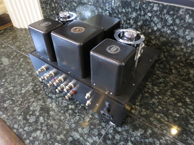

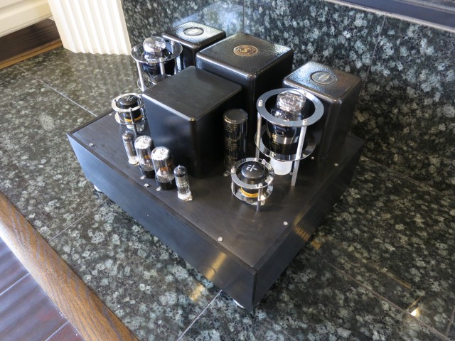

Input switch done and tested. Now it is time to connect and fire the amp.
That is a beautiful amp and I really LOVE those meters. Where can I get a pair of them???
Those are USSR NOS stock one can find on same flea markets in Poland. And golden rings comes from Ikea.
Thanks for your kind words about the amp.

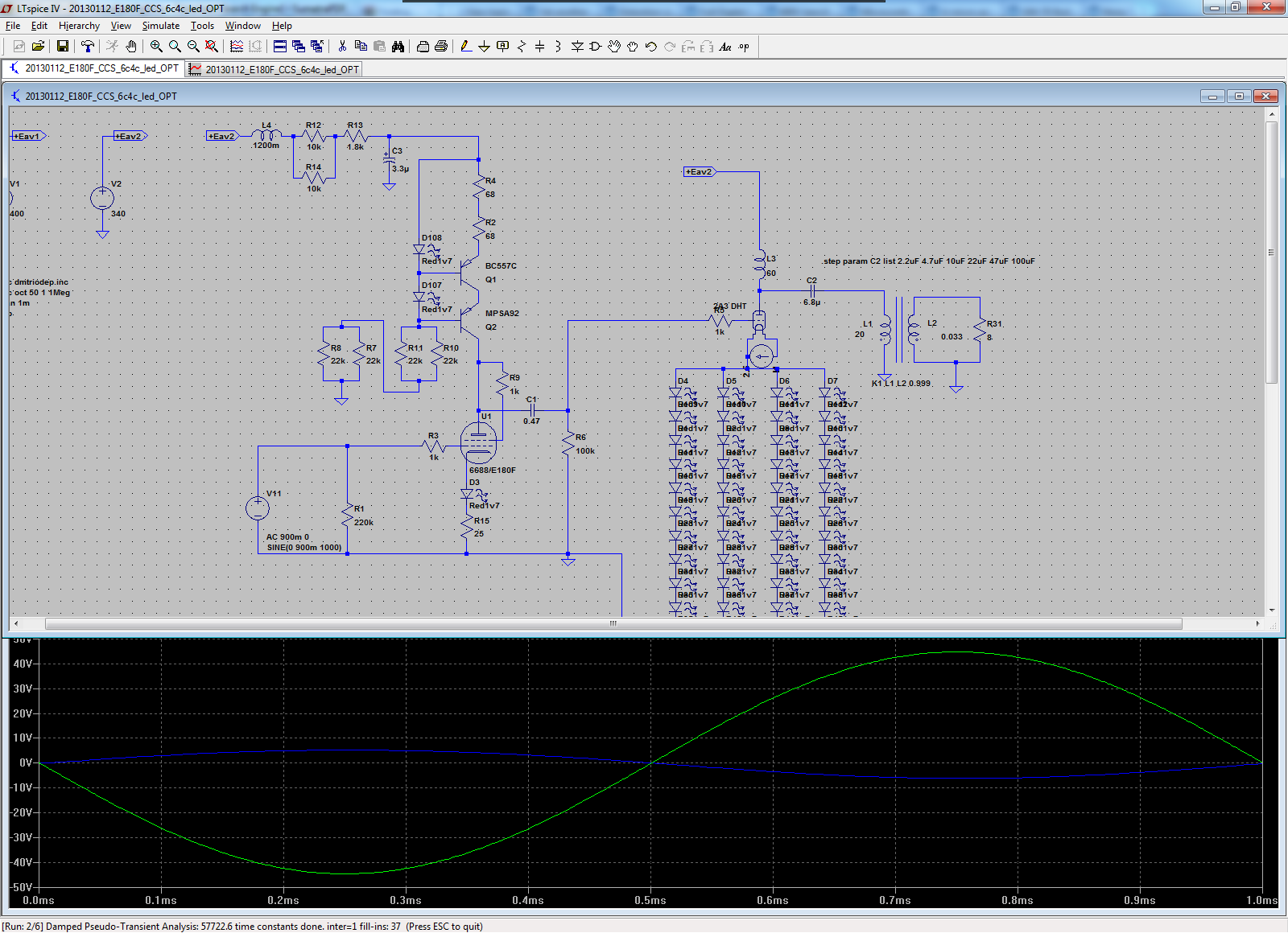

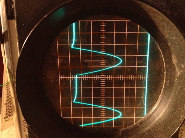

I used yellow LEDs for cathode bias. Vg1 measures 1.9V both tubes. Anode DC voltage is 145V and 147V. If I read the trace properly, tubes goes into cut off. Right?
Fired the amp with E180F BJT CCS and 6C4C
Still things to be corrected, yet fine results right from the start.
There is no resistor in the cathode - I used yellow LED which gives 1.9V, so needed additional voltage drop due to lack of proper model.
MPSA92 is replaced with F241.
