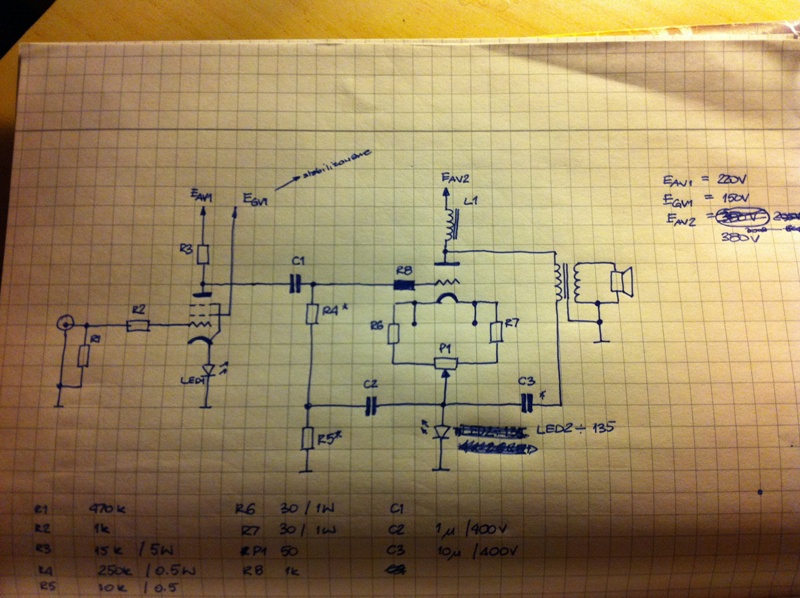

Trying hard to come back to tube amps after some busy time since my last build (RDL by SY). I had collected a lot of tubes and decided to build something easy, small. Must be SE, parafeed and with Po not more than 10W. I have Svetlana 300B, 6C4C, C3g, 6H9C, 6C4Pi, 6C45Pi among others (GM70 as well, but still too little place to build such monster and too scared).
Ok, I am designing C3g+300B SE Parafeed with LEDs in cathodes.
I would like to read your opinions on the posts while making progress.

Schematic - ver.0.1
Schematic - first approach
I think of replacing R3 with CCS in the future.

... and convert C3g to triode connected, of course.

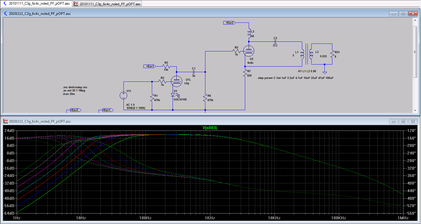

Started some output stage simulation with LT Spice. It seems that OP xformer params are critical to bandwitdh. And there goes the question: a transformer is represented by a couple of parameters, one of them is K coefficient - what is a good method to measure one in practice? My transformers were wound a few years ago and there is no chance I can find specs.
A critical factor in a parafeed stage is the type of core you have in the OPT. The best type is the amrphous core because it doesn't store energy at low frequency. Never forget that decoupling cap + primary inductance = resonant circuit! The type of core is just critical as the cap.

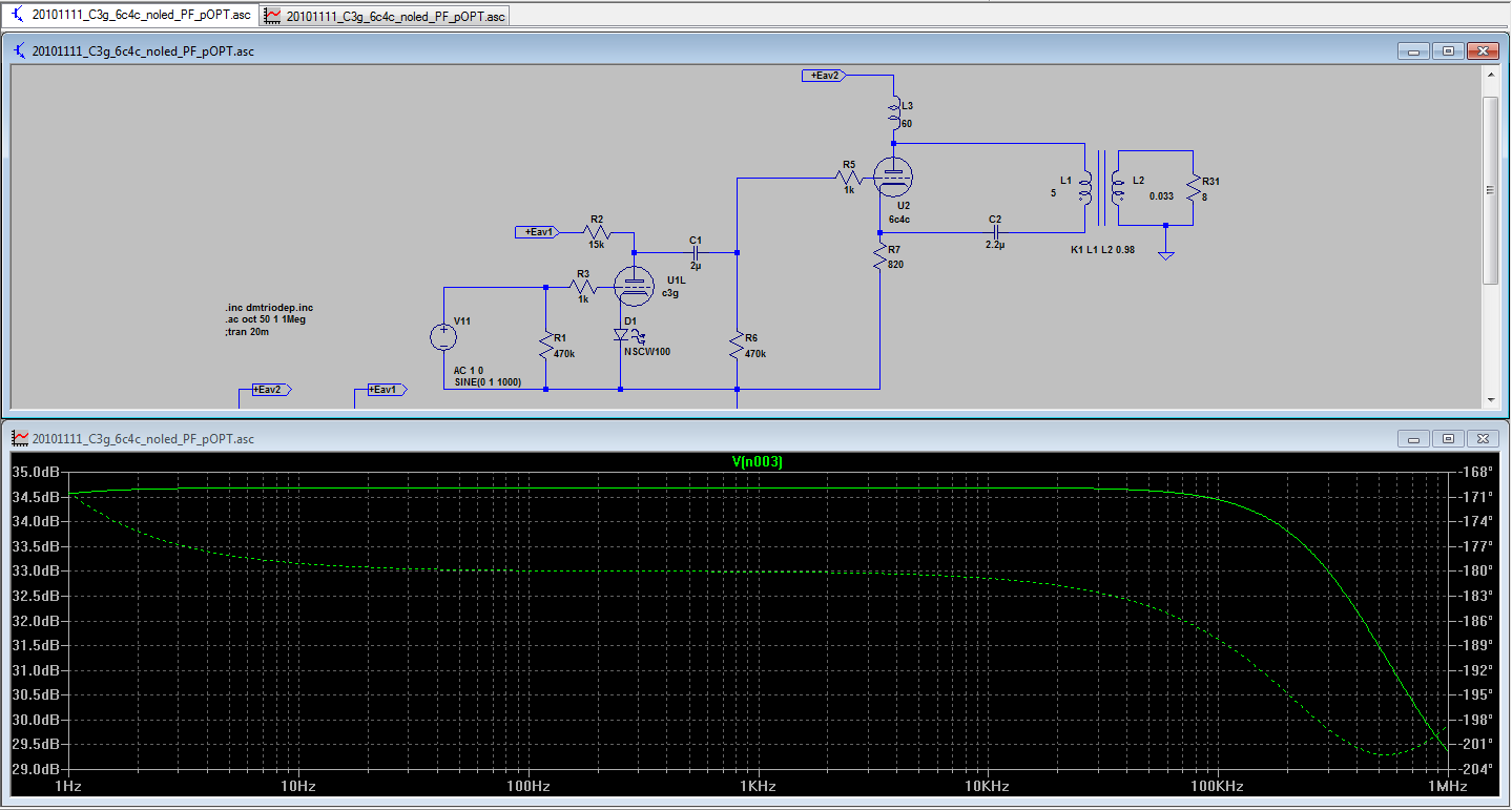

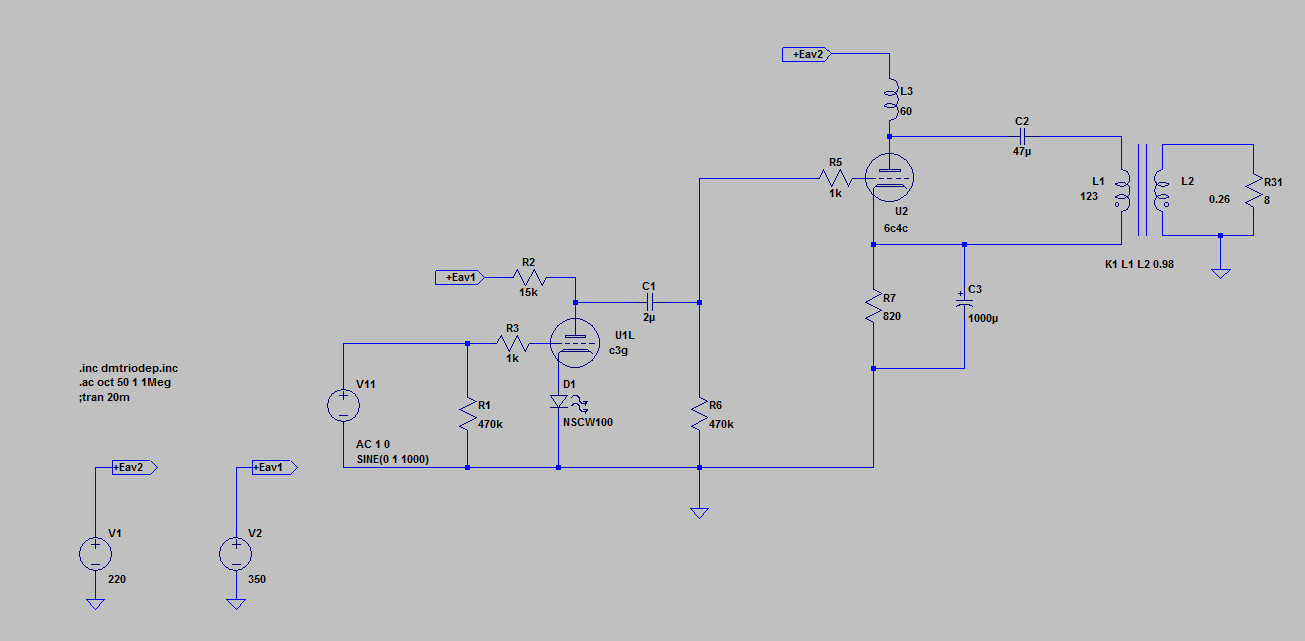

Kids are at their garndmother, there was a national holiday in Poland and at last I had time to proceed with the work with an amp. The result is the below shown schematic.
On one Polish forum I found interesting discussion on using mains transformers as OPT. www.trioda.com • Zobacz w?tek - trafo sieciowe jako g?o?nikowe. I measured inductances of primary and secondary windings of one toroid mains transoformer (50VA / 230V / 9V). The values are shown on the schematic.

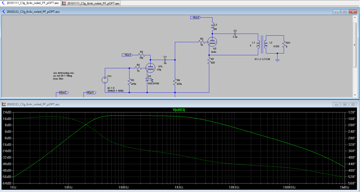

On the next picture frequency response is shown, as simulated in LT Spice IV.
I also simulated the circuit with LED biased 6C4C (4 x 26 LEDs), yet the outcome is not satisfactory. Still some analysis to be done.
Comments are welcome.

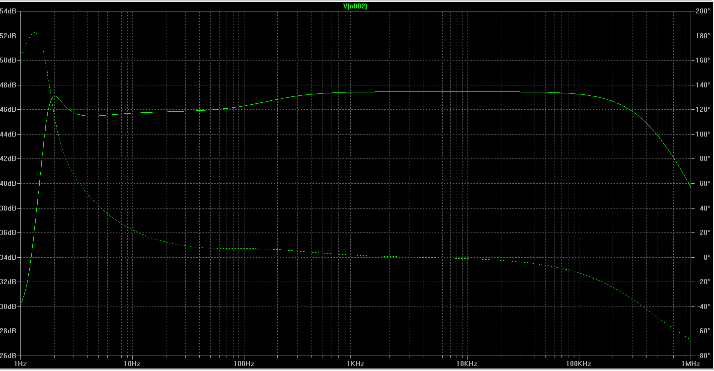

The frequency response attached in the previous post seems unreal. What is worse, I cannot replicate the result. 😕
well, I was about to say that the ones I have seen had the cap connected to ground
and shouldnt the cap be bigger ?
what does two secondaries mean ?
