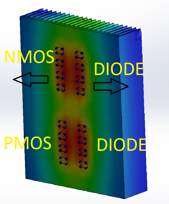

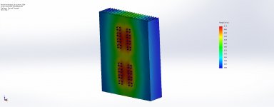

From before i have estimate a total power dissipation from the mosfets, but how i need to weight the diodes ? (from a thermal perspective)
Every channel has 8 mosfets and 8 diodes, in the attached simulation i have calculated with a total power dissipation of 140w (and an ambient temp of 30degC).
I think i can push a little bit more on this chunk of aluminium.

in moments of peak currents , current is practically subtracted from mosfets , and given to speaker
so , sum dissipation on heatsink is declining ,so you can ignore dissipation on/through diodes
if you're going full bang , counting on heavy AB class work of F5T , then you really need to carefully calculate everything .....

In your opinion, there's a practical way to guestimate the power dissipation that comes from each of 8 diodes (mur3020). I want to optimize a little bit the placement of the whole board assembly on the heatsink and i am thinking to shift a little bit the board to get the most "hot" components (mosfets) in the center.

i was talking about centering in the horizontal offset rather than vertical.
If i can estimate how much the diodes dissipate on the heatsink i can simulate more accurately where to fix all the assembly in order to maximize heat distribution.
The bottom PMOS will run cooler than all the others.
The upper group of NMOS will run hotter than the lower group of PMOS.
Within the lower group the first will be coolest, the second will be warmer, the third will be hotter and the 4th may be about the same temp.
In the upper group, there will be a similar gradation of temperatures from 5th to 8th.
Heatsink manufacturers give spacing advice for groups of devices. See what you can find.
Yes, the simulation confirms that.
but i was talking about centering on the horizontal plane (look at the photo).
i need to know the heat output from diodes so i can keep the mosfet as centered as possible if the diodes dissipate less.
but i want to do this optimization via the simulations, and a rought estimate of the heat output from diodes will help
the F5t diodes should not pass for normal/average outputs.
The diodes are there to reduce voltage losses when transients peaks are demanded.
i.e. they turn on ONLY when the current demand is approaching current clipping.
When they do turn on it is for very short duration and should be at a very low duty cycle.
This method of setting up the diodes means they do not generate heat. The heatsink heats them up.
I think i got it, they are used like a dynamic bypass for the de-gen resistors.
The principle of when they conducts or not is still a bit foggy for me... needs more investigation/explanation.
So in the end i will center the active devices in the heatsink for a more even distribution and let the diodes heats. (i think they will need to stay thermally close so there will be less thermal drift... i guess).
