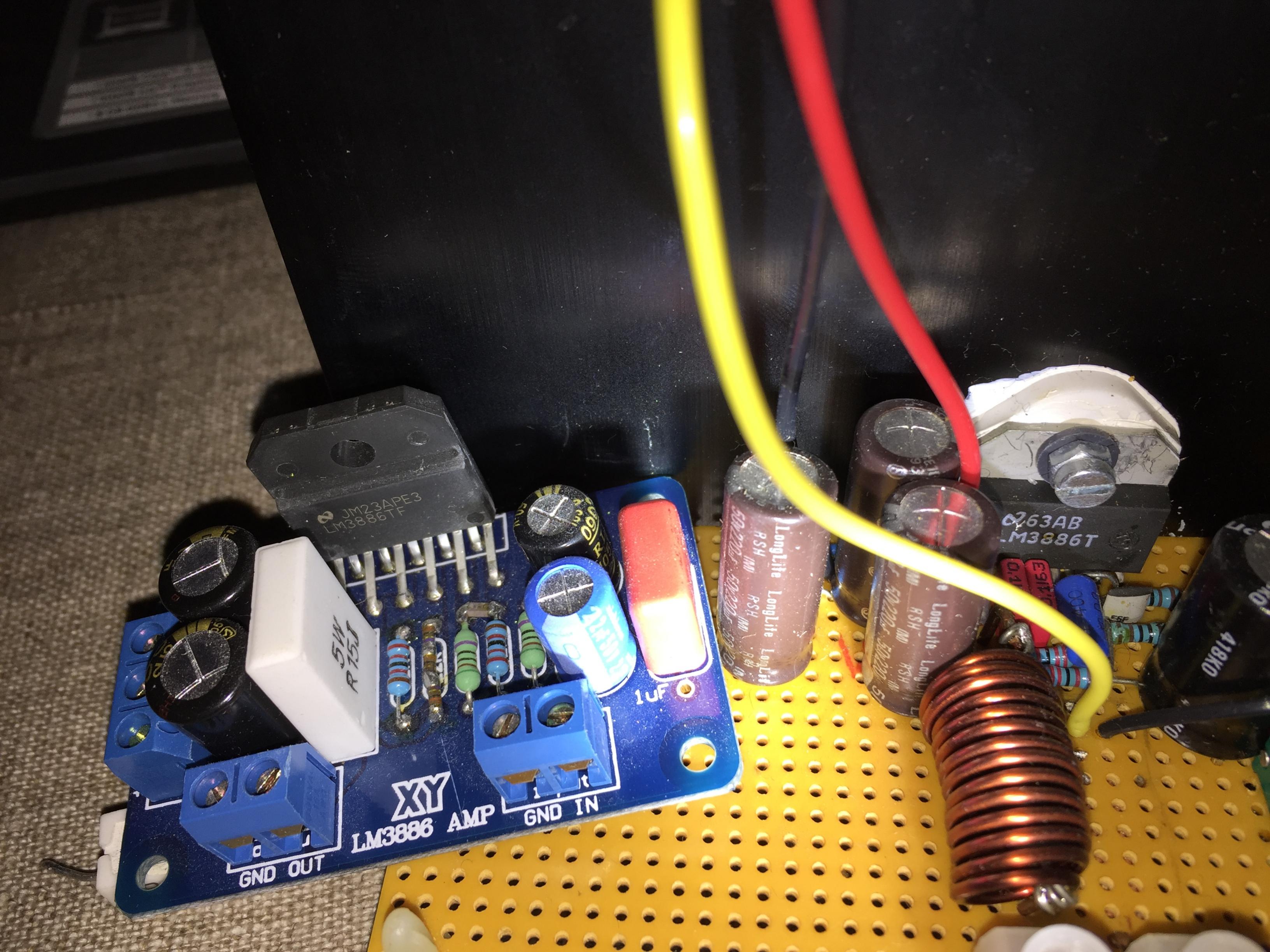

Well its getting there!
Connected all the dots now and the XY just went pop and buzzzz. He he.
Reconnected the cut traces for signal ground and it was fine.
Will cut them again as soon as the amp is in a chassis with proper ground.
Guess a separate ground cable must go from the point of cut traces?
Anyway - it sounds great! Turned the volume to max whit no input signal - no noise. Got <0,6 mv dc on output.
Gonna compare it to the Juanjing gainclone when everything is in place.
If you are following my advice, you need to connect the grounding point of the 22 uF, now disconnected from the bottom ground plain, with a short piece of wire to the ground terminal of the loudspeaker output.
If you are following another recipe, good luck, it will make matters worse.
Did you cut the input ground trace like vacuphile suggested? The amp will only work if there are multiple boards with at least one board with the trace intact.
It may work to reduce hum caused by ground loops. The problems are bad input grounding (using other channels ground connections), chip inputs are not referenced to the same point (feedback&input) and floating chip ground pin when no is source connected.
No, I cut the traces as did in this thread. The ones connecting signal ground to C4.

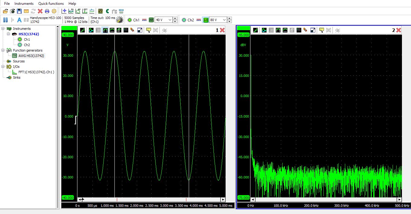

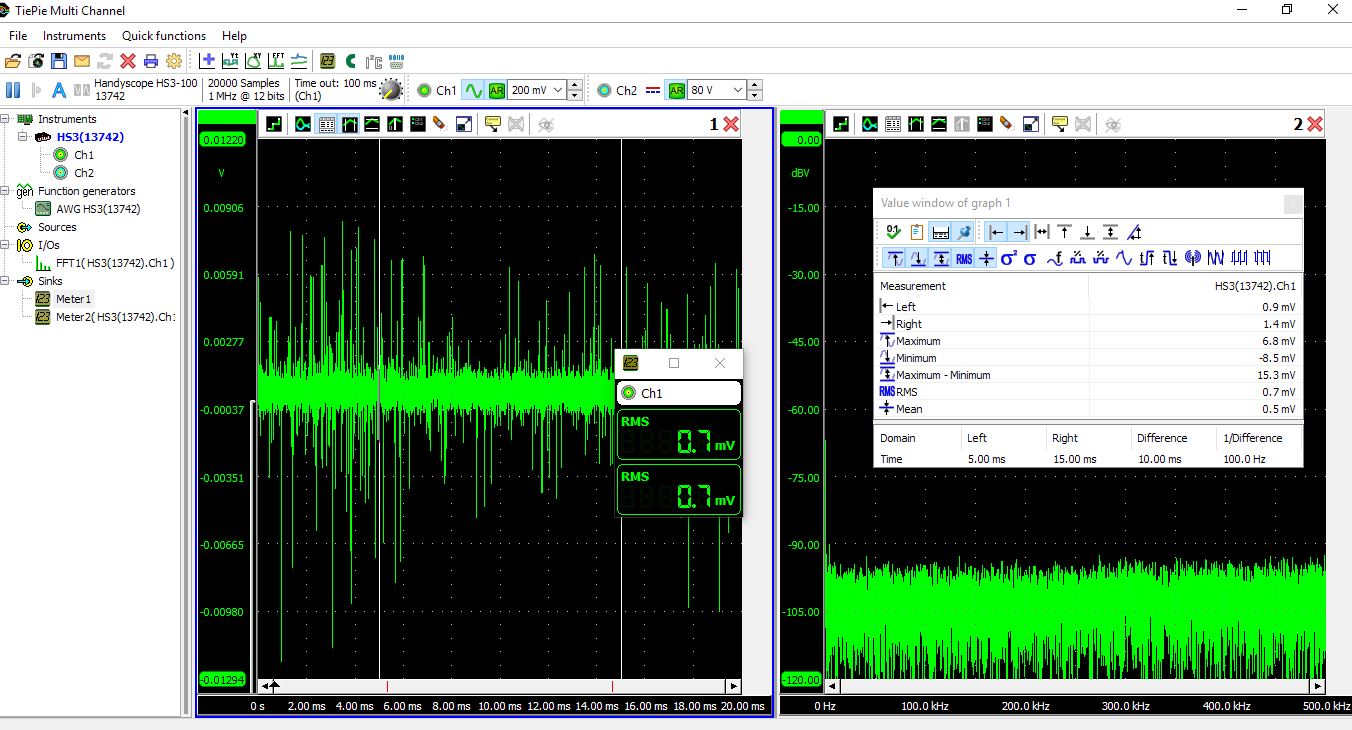

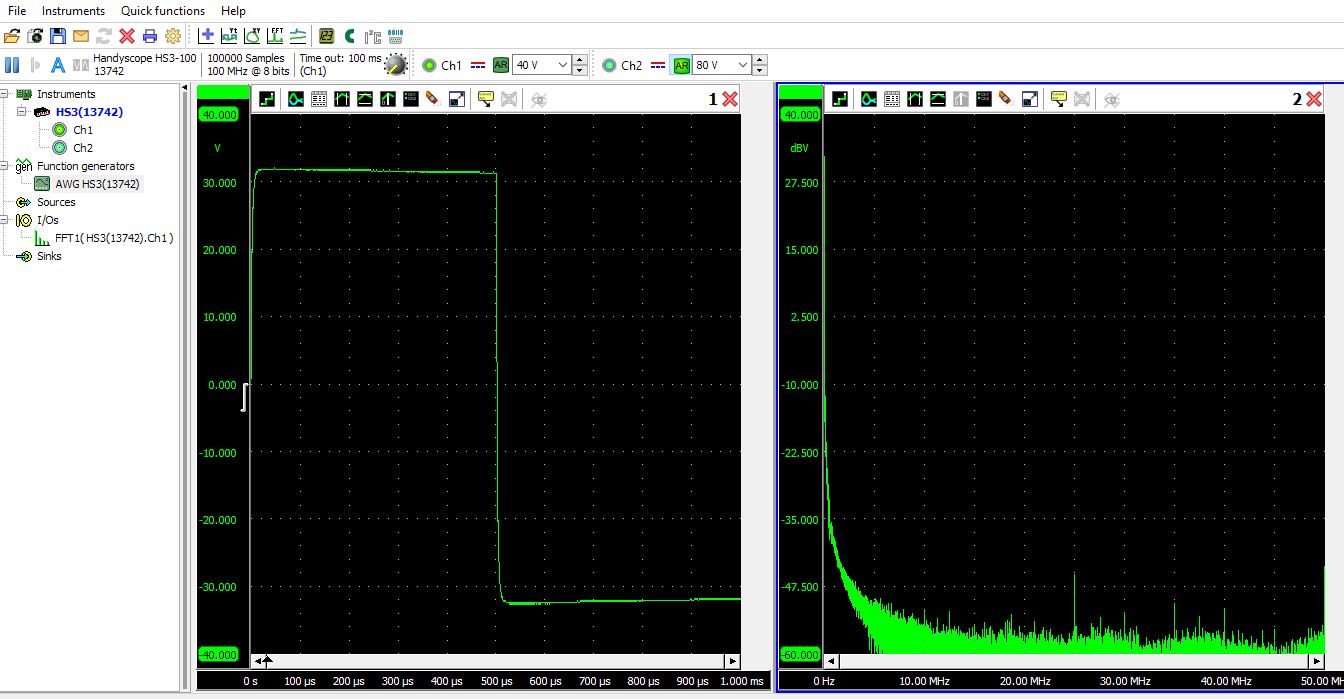

Found my 10+ year LM3886T veroboard amp.
I might have a try of some measurements this weekend? Well see.
Still working. Noise with no load at under 1mV with TiePie scope.
