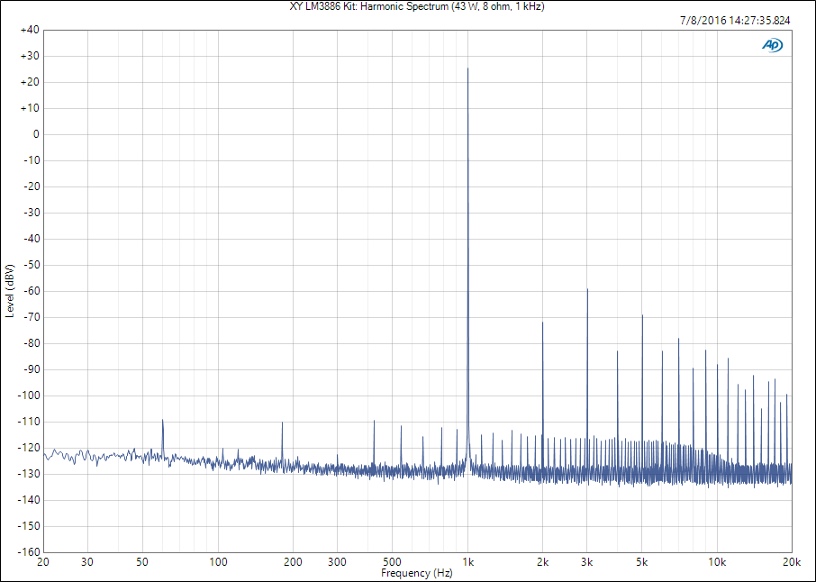

The suggested measurement will only show how much the "fake" part violates the original spec.
And "everyone" can measure down to 0.002 distortion. You don't need Audio Presicion to do that.
By the way, I am impressed with the XY kit noise floor at 43watts @ 8 ohm. That measurement is not so easy to do on a hobby measuring workbench, so thank you, Tom, for documenting.
Do anyone know legitimate parts that can do this at 10$? (sine at +25 db, noise residue at -130dB) and harmonics at only -60dB.

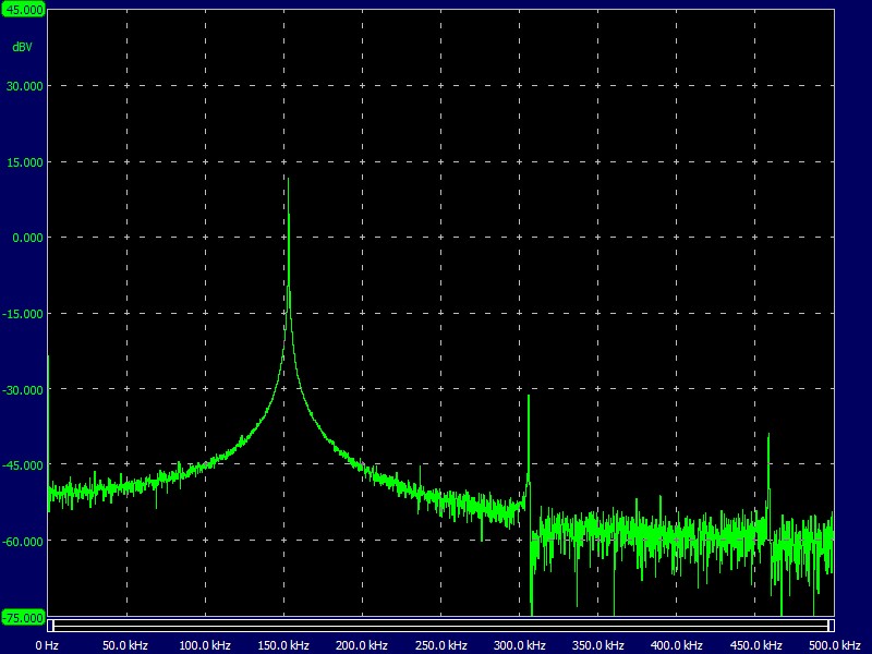

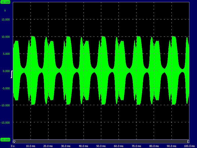

I made a nice 150kHz unstable oscillator with a XY kit. 4 volts RMS into 5 ohm. +/- 26volt. (Found a 18V transformer in my parts drawer.)
By the way: no fumes from the chip. Just a little warm🙂
Guess i should not have tampered with it, see if I can get it to work...
Off topic:

Interesting with the 150 kHz power oscillator. Too bad the phase noise isn't all that great... 🙂 I've never seen an LM3886 oscillate on its own. In a composite loop, sure, but never on its own. Then again, I work with good layouts and real chips.
Tom
Tom
I made a stupid mistake of putting a cap across the +\- instead of to ground. Hence the oscillation.
