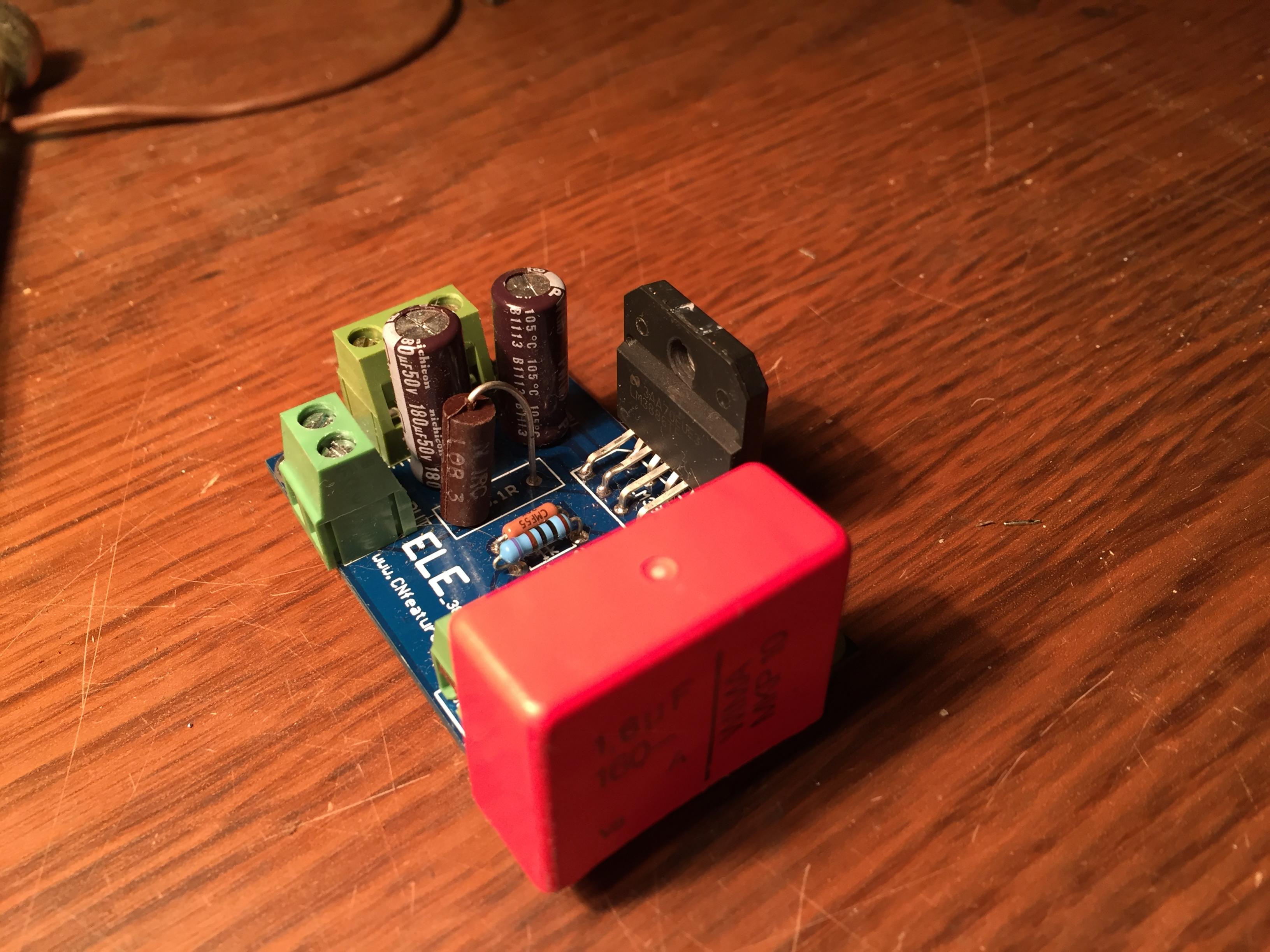

Great xy kit amplifier review you got here. I remember that I built one of those long time ago, I'll post a picture if I find it in the garage.

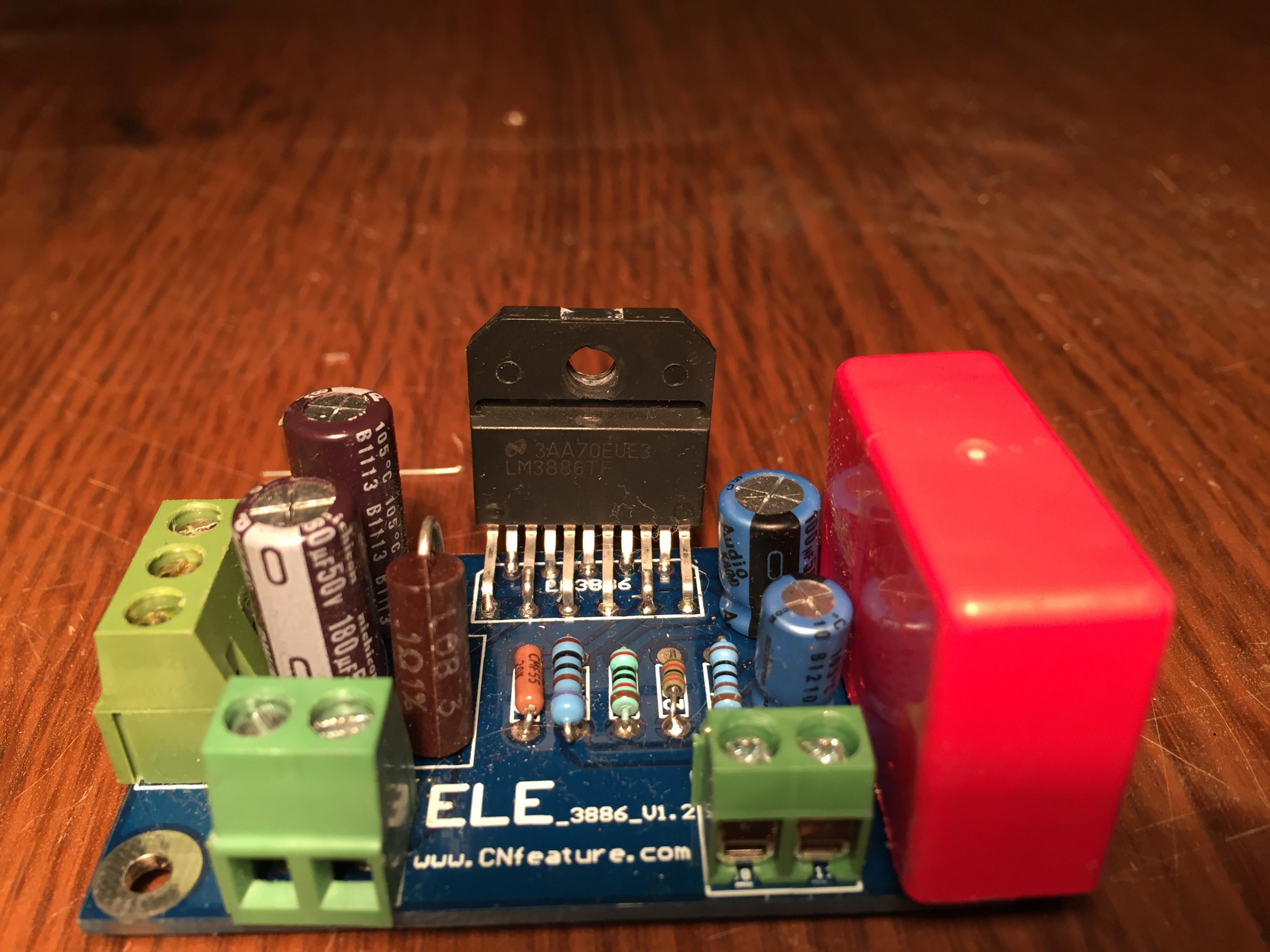

Use zobel instead 0.1r on output and 100-200p in input. Solder 22kohm resistor direct under board from output to input pin....why use so long snake line. I dont see any 100-330nf small capacitors on supply line near supply pinsf. On input solder at least 22uf MUSE green under the board. For better bass response.
There is an XY Thread. It lists some of the faults and fixes for the Old XY pcb. It also discusses briefly the New XY pcb.
There may be two XY Threads?
The XY pcb is cheap and small. That makes it attractive. But it needs to be fixed to improve performance.
Fitting a fake chipamp and publishing those results does no one a service.

You test a chinese pcb with fake components, and yours with genuine ones. How can you then attribute the differences in distortion to the PCB? You know that you can't.
It would only be interesting if you had tested both PCB's with known good chips. Now it is marketing.

It's a complete kit that you buy. Not sure I see the problem personally, as the seller claimed it was a 3886. It would be useful to also get a data point with a known to spec chip, but is anyone willing to paypal Tom a few $ for the cost of the parts and his time? He will test anything you want on his AP if you pay him a small amount, which is a much needed service for those of us without access to state of the art labs.
I'd bung $5 to see this happen if anyone else wants to actually know. Sort the seekers of knowledge from the peanut chuckers

I never said that the differences in distortion were ONLY due to the effects of the layout. Of course the fact that the XY board was delivered with a fake IC plays in as well.
I compared Kit A with Kit B.
I disagree. Judging from the many "is my device fake" threads here, there are clearly many who buy parts on eBay and expect to receive real parts and well engineered products. Otherwise, why buy the products in the first place? All I did was comparing the kit as-ordered from eBay versus the kit as-ordered from me and Mouser. I don't understand why that's an invalid comparison. Would you please elaborate?
I don't understand the idea that I should buy components on eBay and throw them away because they're "known fakes" and then build the circuit with different parts. That seems like strong hindsight bias to me.

Because there's only one of me and only 24 hours in my day. I was curious to see what kind of performance one would get with the XY kit, so I bought one, assembled it, and measured it. I volunteered my time, money, expertise, and test equipment. I am currently out of volunteering time as I have paying projects lined up. I will focus on those along with the projects that align better with my business strategy and focus. Should you wish to have the measurements performed on your schedule, you're free to purchase my measurement services through my website.
I have already committed to measuring the XY board with a real LM3886. It will happen. However, it will have to wait until the next time I have resources (money and time) available to volunteer.

Sorry Tom, everybody who read this thread knows you attributed the better measurements to your lay out skills. We'll see what happens with a genuine chip. In the meanwhile, the XY board is not bad at all as I found. On easy loads it delivers up to specs.

Does it? Not according to my measurements. You may want to read the first couple of posts in this thread. While you're reading those posts, I'm curious for which part of them made you conclude that I blame the lacklustre performance of the XY kit on the layout alone.
