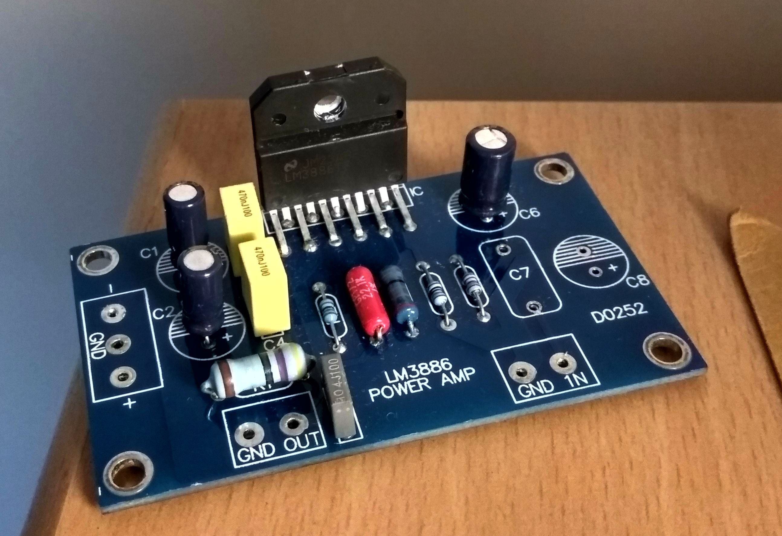

Those look the real deal. The lettering is aligned to the left and the case design is quite different from the TF, which is as it should be.
All the TF versions I have ever bought had laser etching, never the white paint in my memory. This was even true for (some) Chinese sellers, which was the only option for 3rd world-ers like us.
Ignore the PCB. It's part of my past sins, which I keep as a reminder of how not to do things. At least it has nothing connected to it...
And the quality of the photograph, which was taken by the camera module of a Chinese phone. So it's not just amplifier PCBs...
It's not just a matter left/right alignment and ink/laser. Please read Post #1 and check out the websites I link to there for the lot code details. That's not to say that the copycats can't copy the lot code, but at least in case of the LM3886 I received from XY, they just made up one.

I bought a pair of the XY kits from one of the Chinese ebay sellers, planning to install them in an old Crown D60 chassis. The plan was to ditch the output resistor, add Zobel and Theile networks, input RF filter, replace all the capacitors with my own parts of known provenance, move the feedback resistor, fix the grounding issues, and happily carry on.
Tom succinctly addressed the sanity of that approach in post #25.
Now, I think I'll just get a couple 3886DR boards to play with, and relegate the XY's to a speaker test jig or other test bench amp.
The LM3886TF that came with the kits looked good- nice clean mold and leadout, left-justified clean laser etched labeling. Looks authentic for sure. Except, the lot#/date code ID is: 3BA2NRUE3
That doesn't jive with any manufacturing code format I could find on the TI website. They might as well have silk-screened "LM3886FAKE" in fluorescent green ink.
