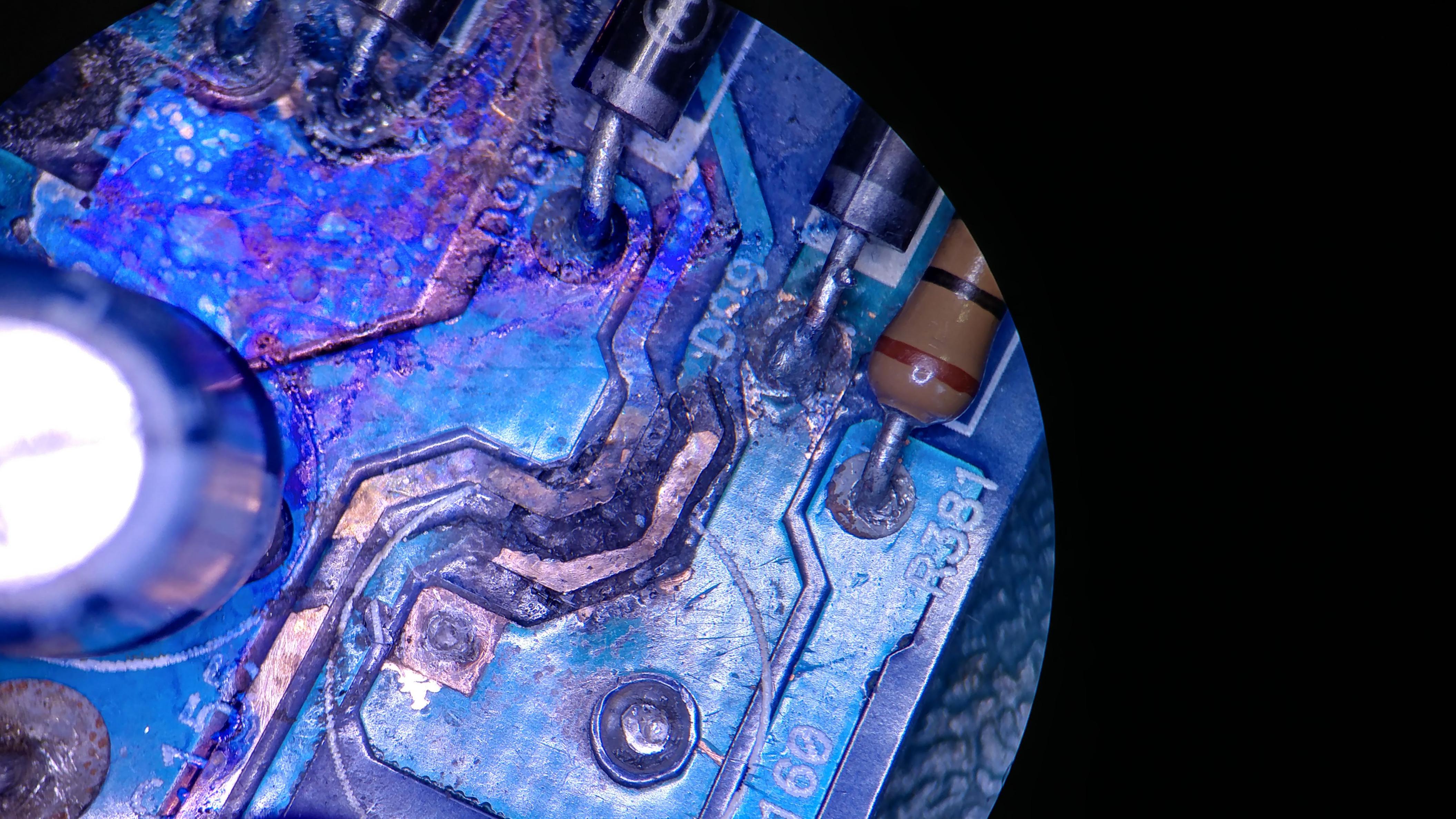

Took my amplifier to work. Found XFR 60-20 power supply that can deliver 60V up to 20A. Set the current limit to 4A. Connected the amp, powered on and boom. Spark and smoke... Link to the video.

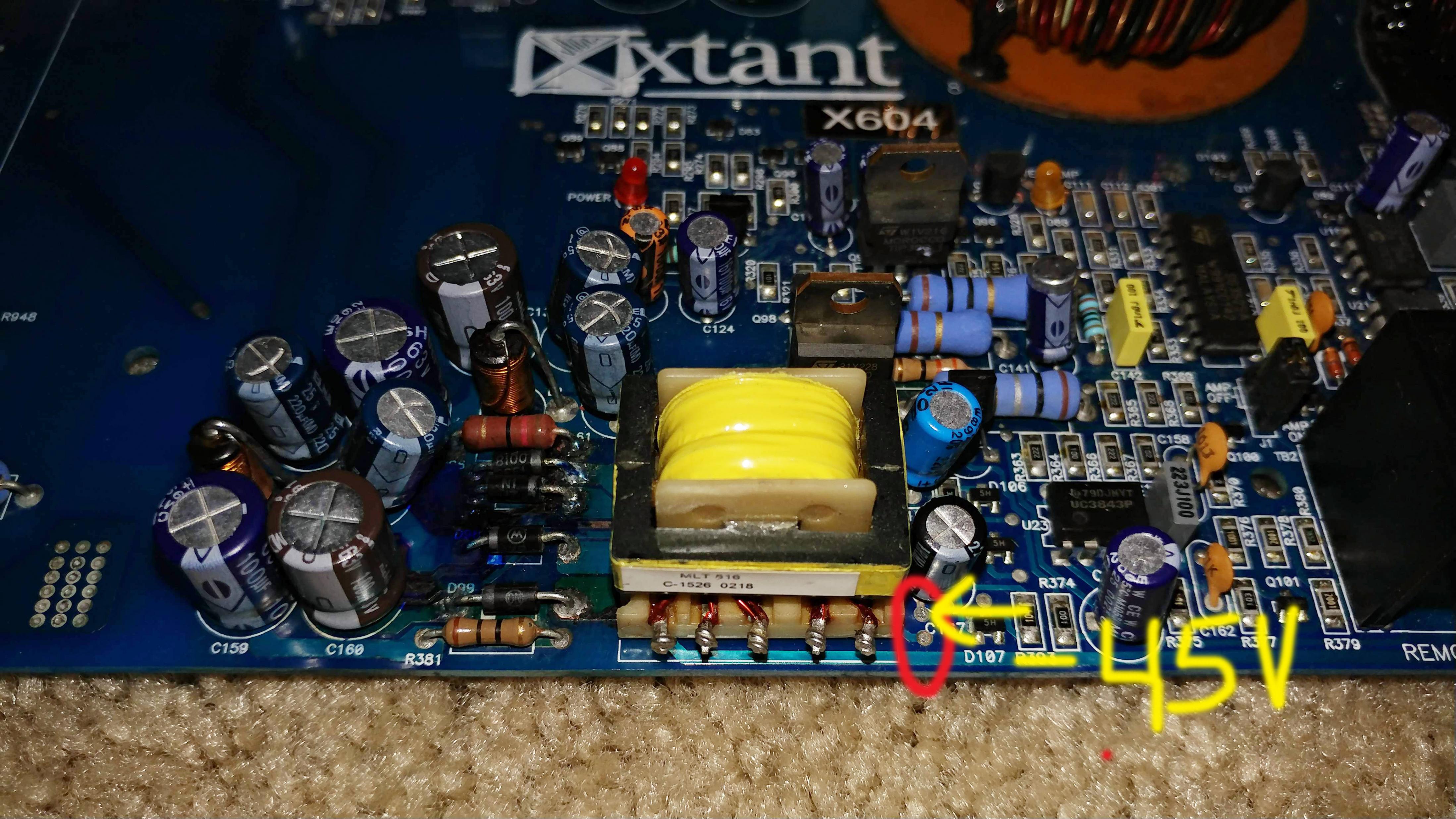

Removed C160 once again and cleaned it. The two traces the spark is happening across measured ~50 Ohms. I measured it with C160 loaded and removed. It may look like the cap housing was shorting the traces but it is not the case. One of those 2 traces is -45V.
Can you guys check the resistance across the two test points I have circled in Red? The discharged occurred across them. Also knowing the resistance of various rails with respect to ground would be helpful (there are test points next to speaker output terminals).

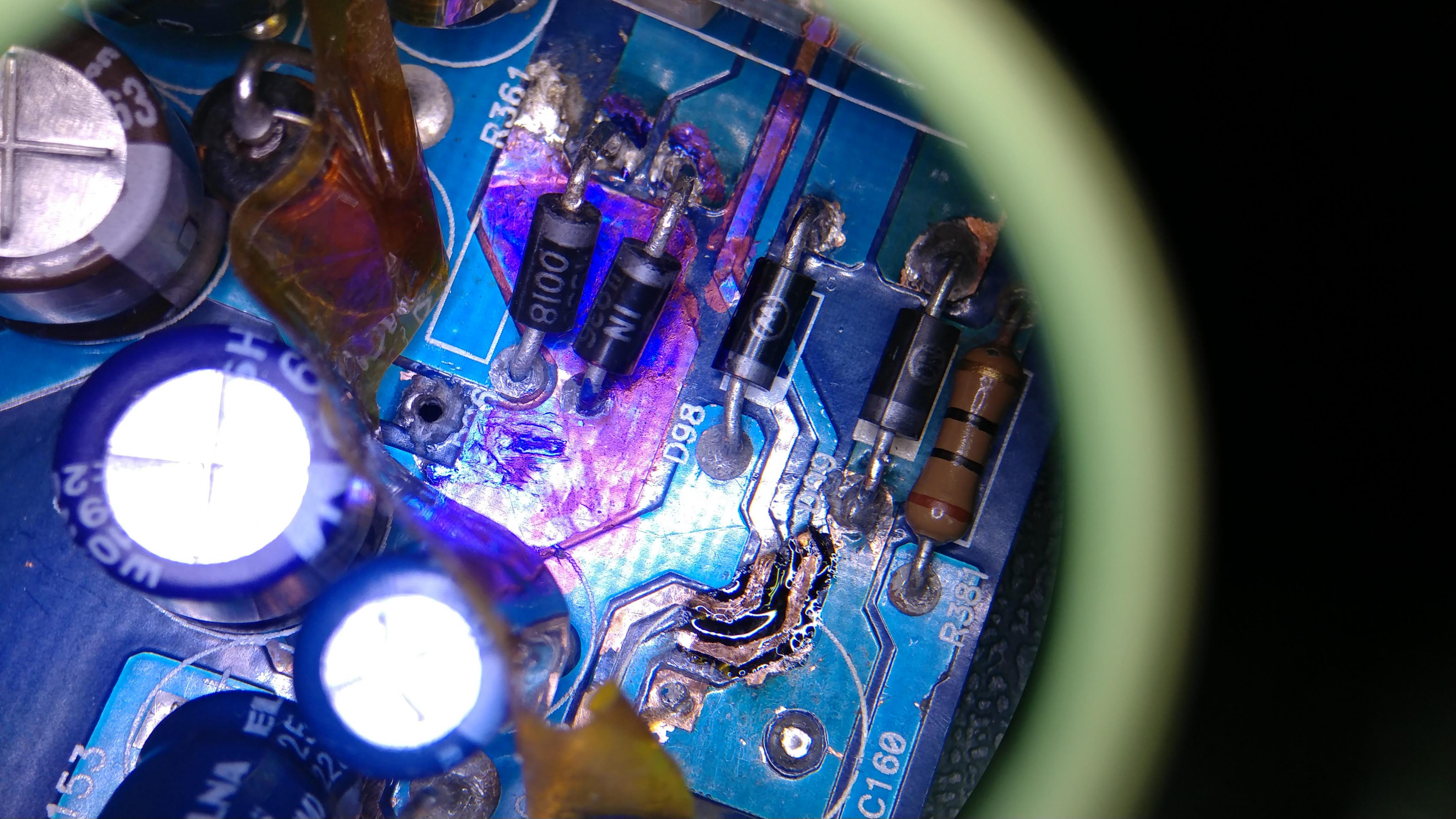

I found R815 10Ohm resistor that looked like had severe overheating problem on -45V rail that measured 16Ohm (little 1206 guy). I had it replaced.

Thank you Perry. I suspect it was sparking in the area of the least resistance since I haven't cleaned it good enough. Thank you for the advice. The PCB burned out pretty bad there (formed a little crater). It would be fantastic if it is such a trivial repair...
If someone could ohm out the two test points I have provided it would be helpful. I will remove the cap and scrapped with the knife.

You should stick with Perrys advice. The carbon crater is your #1 issue right now.

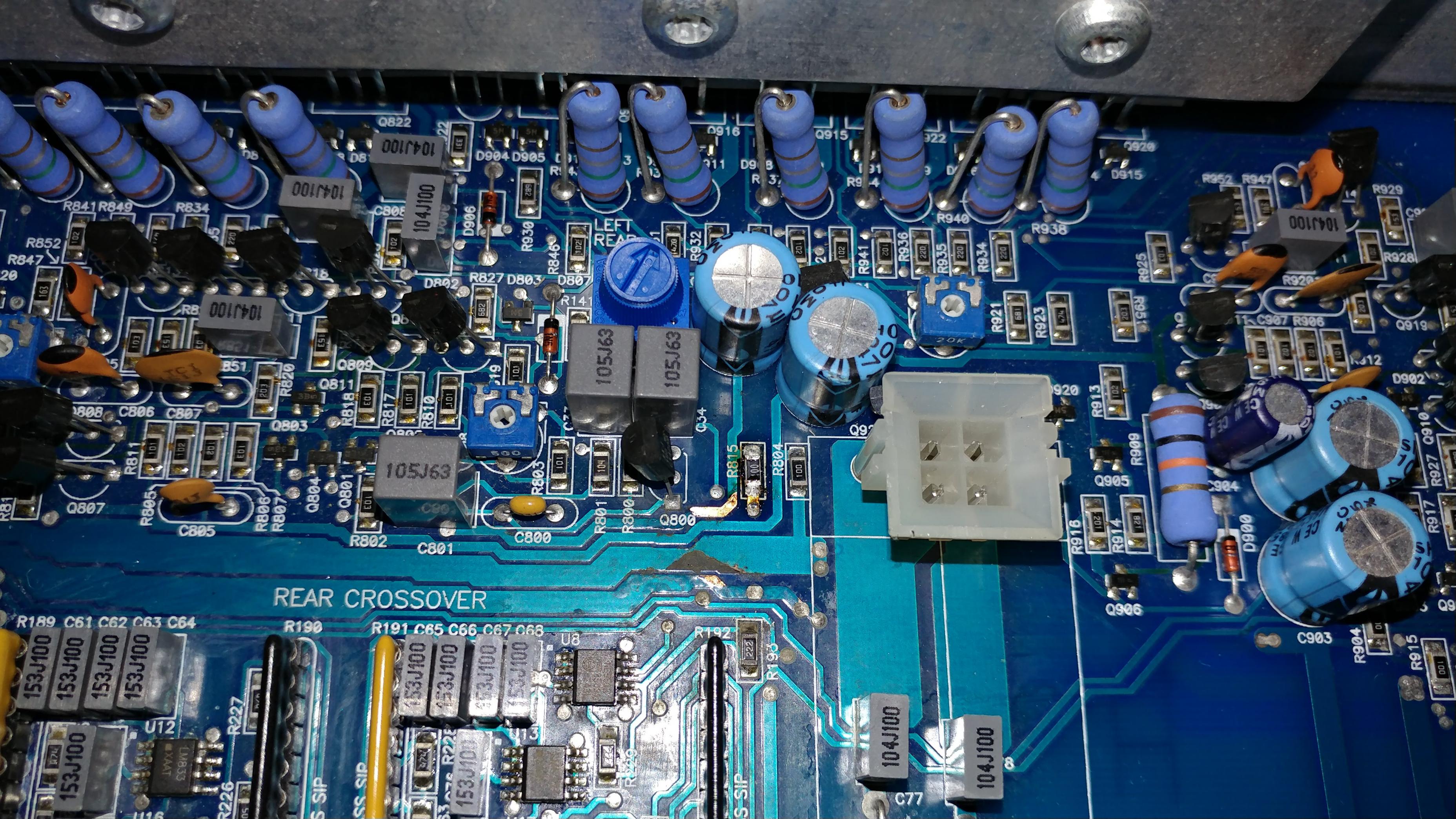

The bias pots are 20k. I have found it by trial and error by monitoring power consumption on psu and DC offset. I don't know what bias is supposed to be set to though. I return it back but I would expect it drifted on all channels since the amp is quite old.
I also found another post for x603 that referred to 500 ohm rpots.

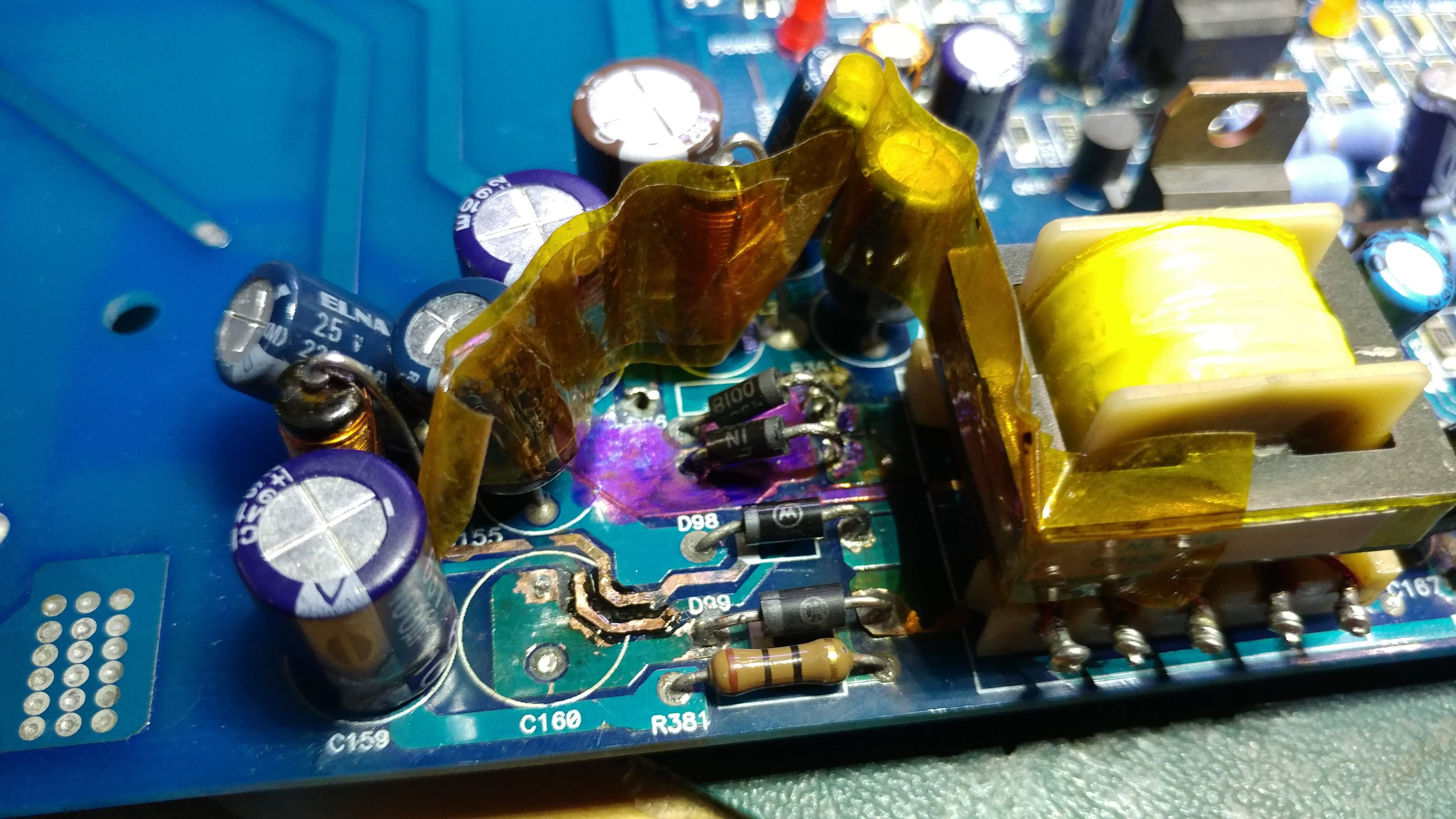

So here is my story about repairing this fellow.

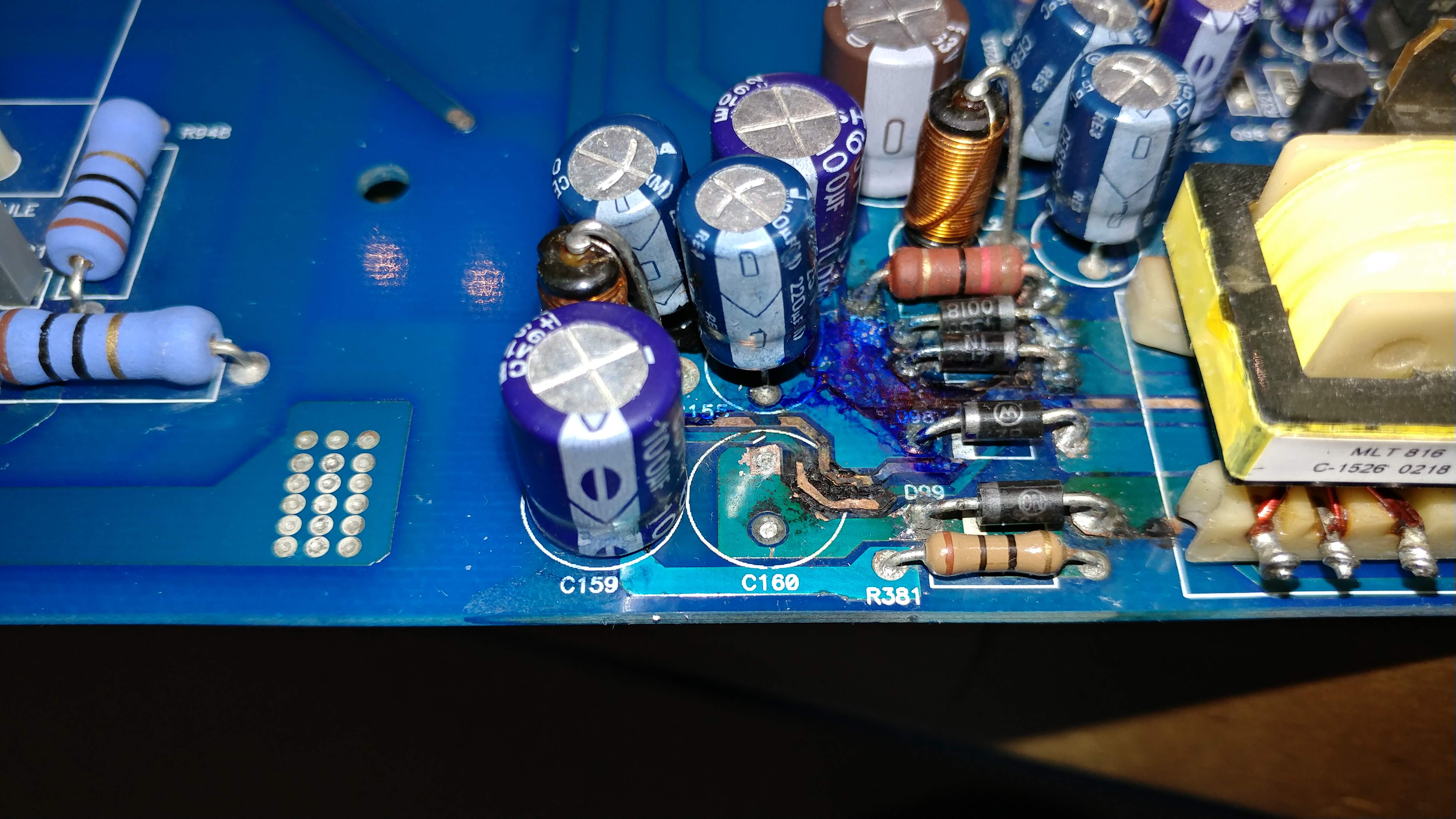

1. I went back and started scrapping. I thought little more and I will have a hole in that PCB. Traces were up in the air by the time I was done. I ended up pouring super glue to fill in hole. 50 Ohms I was measuring across those two points turned into hundreds of kOhms or something like that. Can measure if anyone is interested.
2. Swapped 1W (or 2W) 12Ohm resistor with 0.5W 10 Ohm. Not sure what the original resistor is rated for but there is very small voltage drop across with no music playing. I may regret this later will see...
3. Connected to power supply and set current limit to 5A. Powered On, voltage is sagging to 9.5V while pulling 4.1A - 4.2A of current. No more sparks in the area I was working on previously. Checked voltage rails on the test point and there is no +45V.
4. Disconnected everything and brought back to soldering station. Used microscope to go around and clean any suspicious area with isopropyl alcohol and scrapping between traces in the area where water leaked.
5. Back to power supply, this time 12.5V and 4.1A of current load (DMM reading 11.9V at the amp terminals as I have used skinny wires).
6. Checking +45V at the test point, still missing it... Started ohmic out where -45V is going. It goes through 10Ohm resistor, then connected to another cap C159 and then further down the line. Apparently from the previous water leak (not severe) when I was cleaning the board I managed to damage the trace that goes to the test point (but nowhere else). I didn't bother fixing it (it would look uglier that it already is).

8. Discovered that offset on the front channels was quite a bit off (130mV, -89mV) and rear channels were lower but still quite a bit off. Using trial and error method discovered that 500 Ohm rpots adjust the voltage offset. 20K rports adjust the bias. Later on found post on diyaudio that I needed 500 Ohm rpots (reference X603).
I didn't see Perry's post about: "After you adjust the offset, monitor the offset with your meter and blow on the area where the drivers for that channel are located. What do you notice?"
I let the amp run for some time (30 minutes) and adjusted the DC offset (<5mV). This those rpots are really sensitive. When I finished adjusting the last channel, went back to check and offset drifted to 20mV or so. Readjusted again, checked - they are in <11mV.
I guess the DC offset is temperature dependent. What is the proper technique to get it adjusted? This amp is mounted in the trunk (sits above X1001) and is used to drive my front speakers (bi-amping). In the summer it gets really hot and I wonder how much DC offset is going to drift.

Attached are a few pictures. At the end I ended up using super glue to seal the exposed copper traces (after I used blue sharpie someone conviniently left at the rework station). 🙂

That's the problem with DC offset on these amps. Don't get too worried about it. It will not remain constant.
Using superglue or fast curing epoxy is a problem if you ever have to apply heat to either. If you have to fill a board, use the 24 hour curing JB Weld. For small areas, something like a drop of E6000 or GOOP works well.
For those two short traces, I'd likely have scraped away the solder mask back to solid board and overlaid a leg of a resistor over the length of the trace. Another option would have been to cut away the 'flying' part of the trace and jump them with a small gauge wire. Multi-strand (not the single-strand) ribbon cable works well. The wire could have been fixed in place with the adhesives mentioned above.
These suggestions are for future reference. There is no need to undo what you did.
When you scraped/dug the fiberglass out, did you take it back to where there was NO darkened fiberglass?
