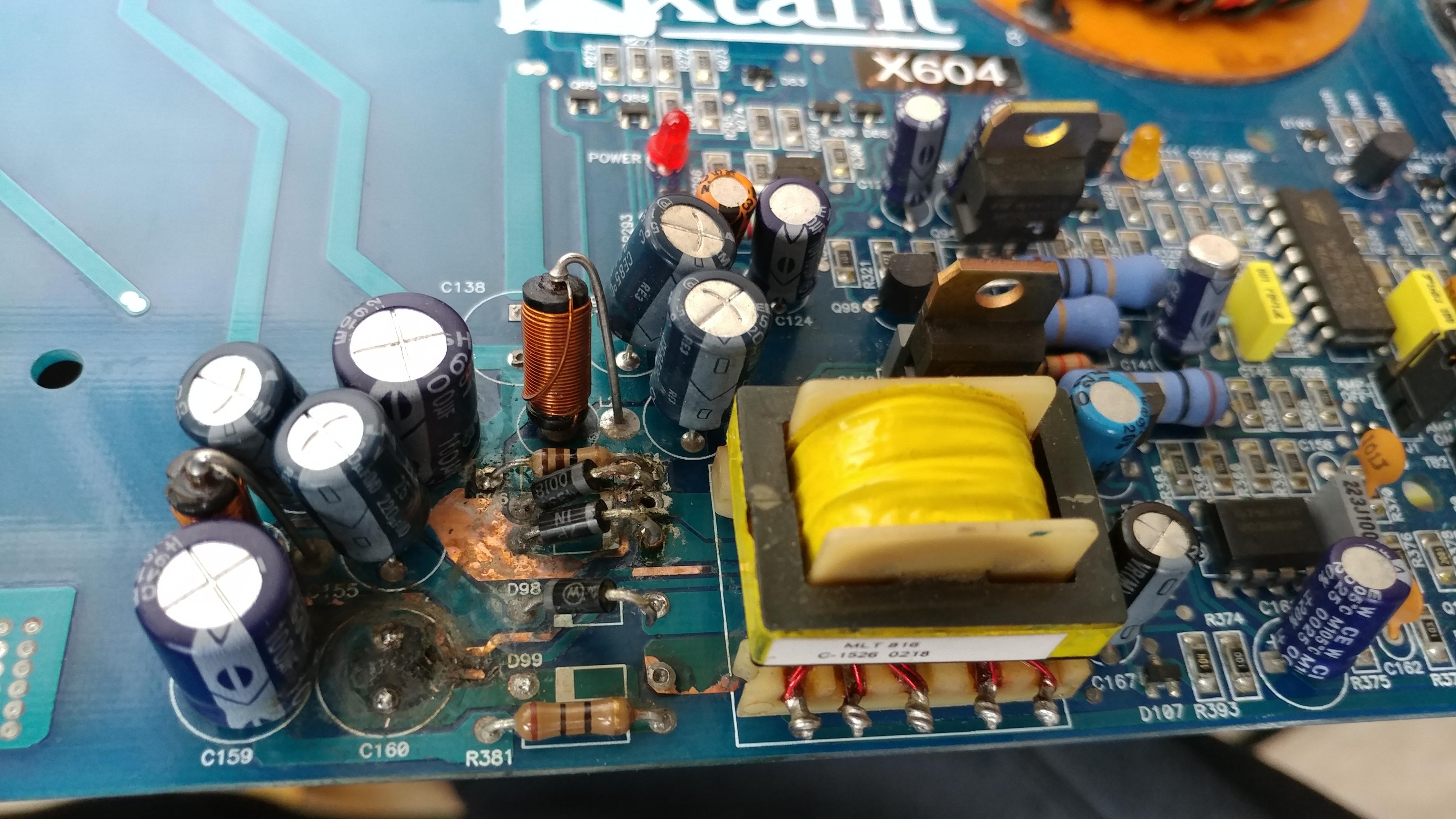

My trunk had a water leak and damaged that made its way in Xtant X604 amplifier.
Does anyone know the part numbers for D96, D97, D98 and D99? If not can you please provide the voltage drop across them with DMM (both directions) and perhaps supply voltage while ON?
Also need to know the R361 value.
It appears the power supply has been damaged. C138 cracked opened and R361 is blown.

You can still read the numbers on the diodes.Wipe them off and read the numbers. From the 4, you should be able to get a reliable number.
R361 and R381 are the same.
If the bottom of the board is as corroded, I'd use a fine wire brush to get back to clean solder (don't breathe the dust, use a vacuum to pull in the dust while brushing) before I'd try to desolder.
I found 1 shorted rectifier D99 diode. Lift one side on the other diodes as well.
With D99 removed I am still seeing 320 Ohms and raising up.
R381 is 10 Ohm resistor. Looks like 1/2W resistor.
I am going to order replacement parts. The diodes are Motorolla 1N4936.
Any advice on how to proceed further would be highly recommended. Does anyone has a circuit diagram or at least a portion of it?

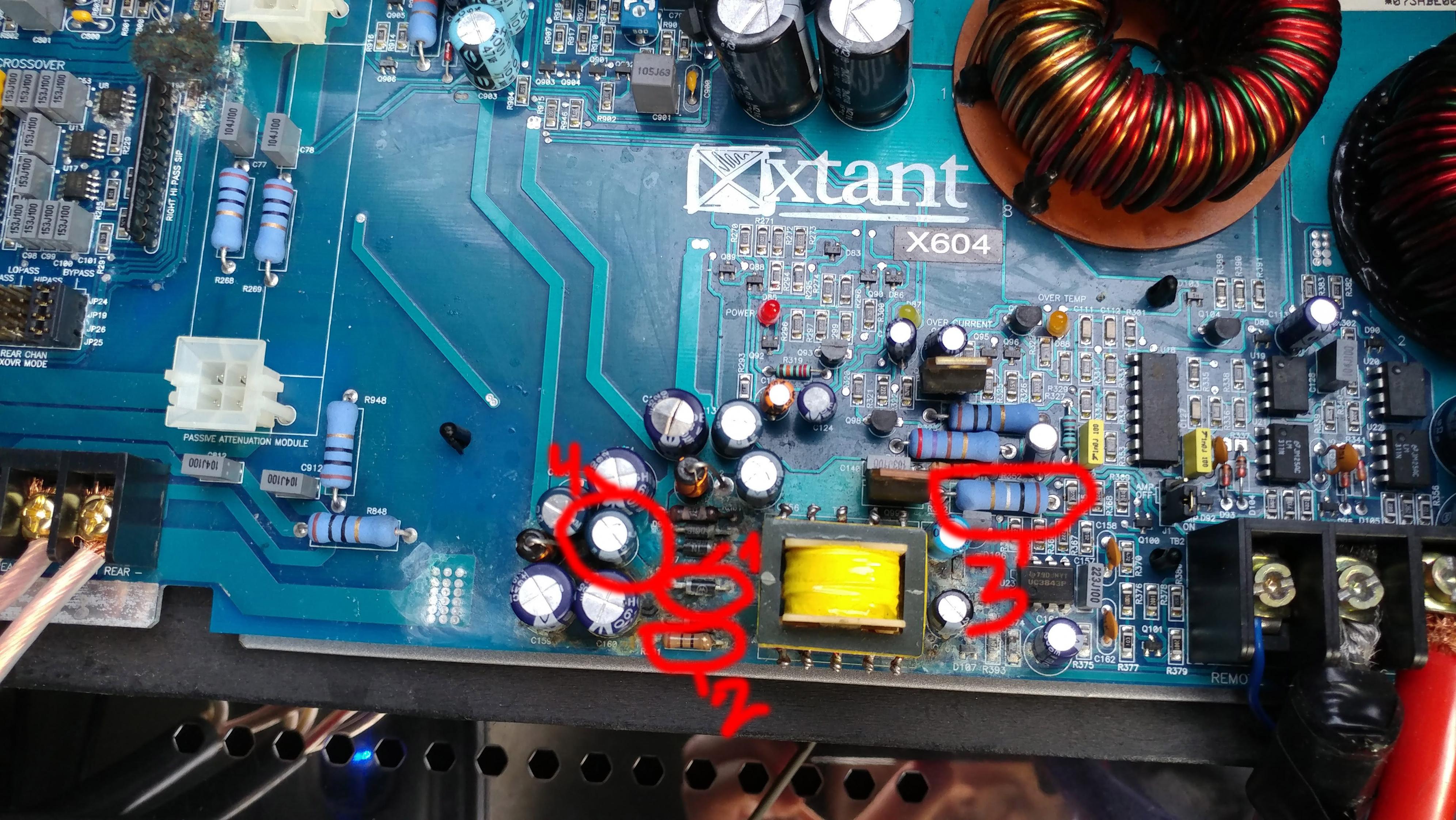

Grabbed thermal camera and identified components that are heating up:
1) 10 Ohm resistor R381. Measured voltage across resistor 1V. temperature gets to upper 30 deg C and slowly climbing up. For reference R361 had 1.2V drop (as I have mentioned i was using 12Ohm resistor instead of 10Ohm when I replaced it).
2) Diode D99. Same as R381 temperature gets to mid-upper 30C right away and slowly climbing up.
3) R362 0.2Ohm resistor (56C). Note that capacitor that sits right above has a bald head (insulation is missing).

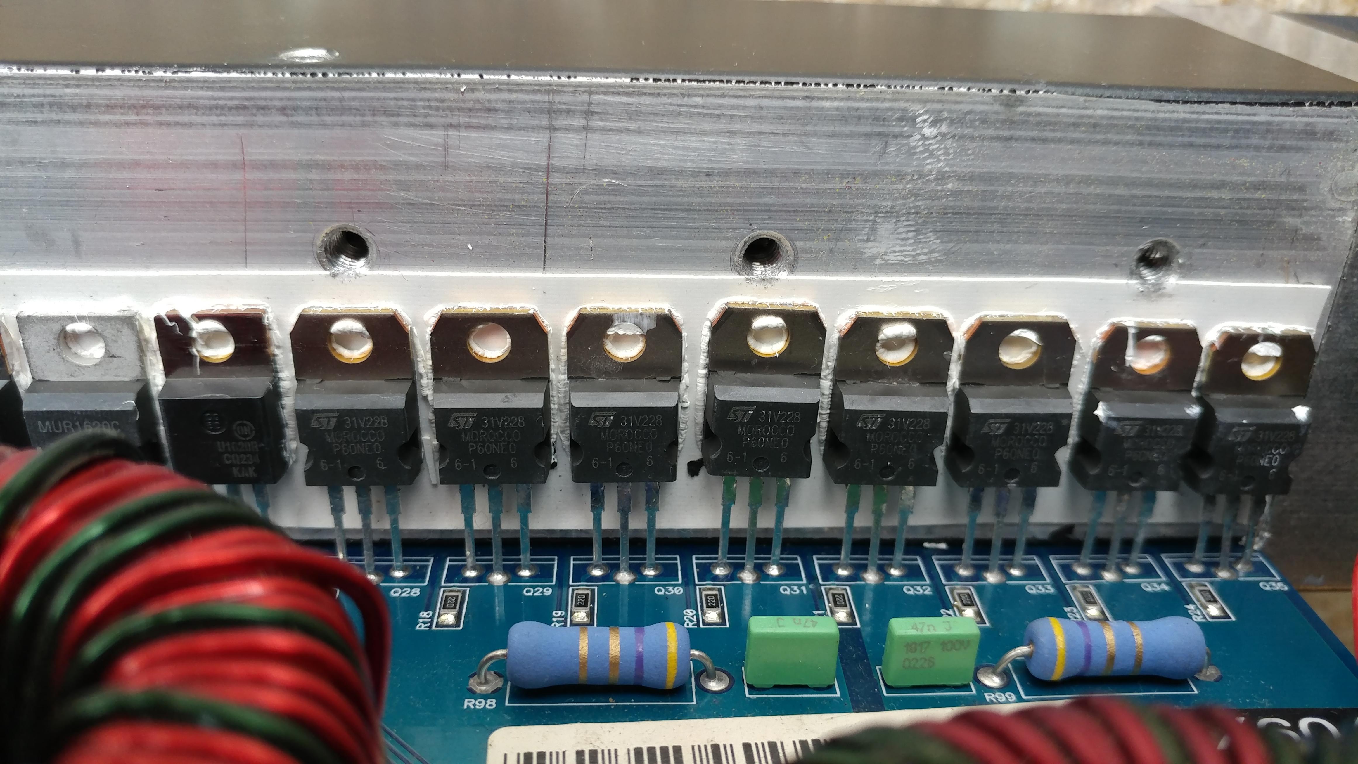

Used test point and figured out +45V and -45V rails were down (perhaps not enough current to power on the amp section). I didn't take a note of all other voltage rails when I checked them. I did check all output transistors and didn't find any shorts. I thought I did but the parts needed up being rectifier resistors with 2 diodes connected together on one end.
Obviously I haven't fixed my problem with ad hock approach. The power supply was switching to constant current mode likely due to excessive current load (voltage was reading about 8.9V with current set to max 3A).

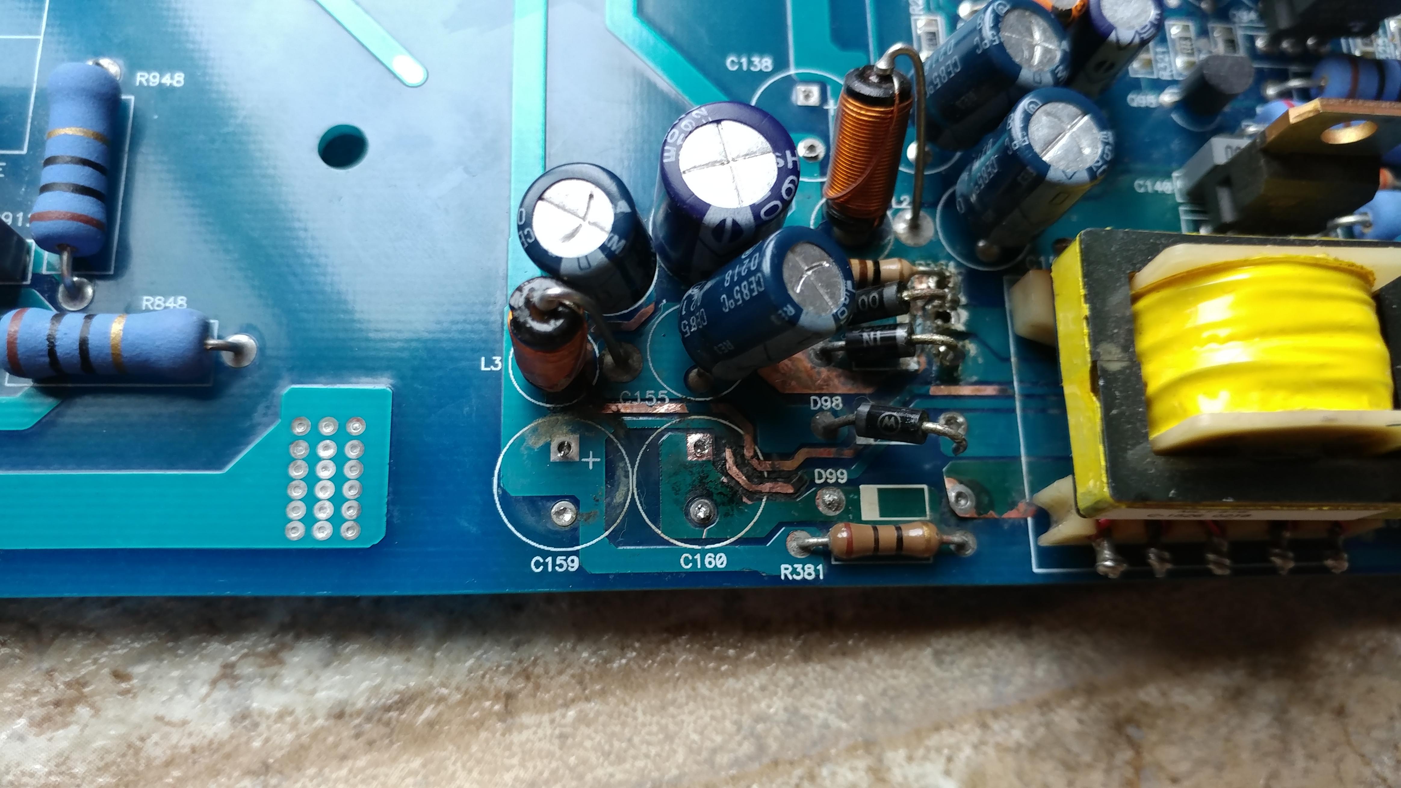

I took some pictures as I was going through. Unfortunately I had to use degreaser to clean the PCB as rubbing alcohol wasn't strong enough to remove debris. Though the traces got hot and the silkscreen washed out very easily. Attached a few pictures before and after as well as additional picture showing transistors and diodes where I thought I have found a short. I would have removed all components but soldering iron I have at home is not powerful enough and I end up damaging traces. This amp has 2 parallel wires (rework) soldered on the back that have almost no service loop and makes it very difficult to replace components. I applied capton tape to prevent wire insulation damage. Though when I am at work I can remove those wires to gather additional space (picture attached). You can see on the picture the area where power resistor got hot.
I would be interested in your resistance measurements across various rails on the test point with respect to ground. Also resistance at the test point Perry provided would be very helpful (rectifier diodes with respect to ground). I only have 1A capable power supply that is part of rework station at home so cannot really do much experiments without going to work and I don't even stay at home now days (working remotely), moved to my moms place as it is much closer to the hospital I have drive her to daily.
Since I had 1 diode and 2 resistors heating up it gives me the clue as to where to start looking. I already started deriving the schematic but had to stop due to lack of time... I feel it will be a long project.

The 'rework' wiring is factory. If you don't have a good soldering iron, I don't suggest trying to temporarily move it.
Which test points exactly? And which ground reference? Primary or secondary?
It definitely looks like factory wiring. I guess they ran out of real estate on the board for power rails or something.

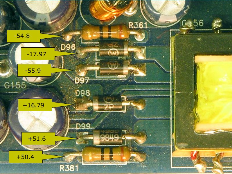

I am interested in the secondary GND reference. Attached is the picture that shows various voltages that Perry shared with me. Resistance measurements would be helpful. I believe I have measured -27 and +27V on C160, C138 or those next to them. I had to replace one of those caps (actually swapped 2 for matching) as one was blown open. Those caps are rated 63V so Perry Voltages seem right and what I am measuring is likely due to some short... I didn't have a clear plan of attack. Brought the amp to work as I couldn't even solder diode back at home and then figured out I still have a problem and almost no time to really think anything through. Didn't want to keep the amp cooking too long either.

If i'm understanding you correctly, you'd like resistance values between secondary ground and each of the points on Perrys voltage diagram. The trouble with that is the capacitors in circuit. Anything sub 100 ohm would be a red flag for investigation, if that helps.
I noticed in one of your posts that you were concerned about heat on these components. All of these parts should be good up to 85c (and some beyond that). None of the temperatures you posted raised any red flags.
c/o that post:
'1) 10 Ohm resistor R381. Measured voltage across resistor 1V. temperature gets to upper 30 deg C and slowly climbing up. For reference R361 had 1.2V drop (as I have mentioned i was using 12Ohm resistor instead of 10Ohm when I replaced it).'
These readings are fine.
'2) Diode D99. Same as R381 temperature gets to mid-upper 30C right away and slowly climbing up.'
Also fine.
'3) R362 0.2Ohm resistor (56C). Note that capacitor that sits right above has a bald head (insulation is missing).'
I'd call this fine, too. There will be differences between our equipment. But I get about 50c on this idle.
Lastly, I set my current limit to 3a and the amplifier was able to power up and stabilize. That does NOT mean yours should and will if there is a problem post-supply. Have you tested the outputs in the amplifier?

I only checked all output transistors and diodes for dead shorts that are mounted on the heatsink. I have compared the resistance across caps connected to diodes and found on one side it is lower. I think I was measuring 320 Ohms and raising up but after I cleaned all the gunk it went to 1.5K or so if I recall it correctly. I am surprised only one rectifier diode is getting hot. I have installed 2W resistor that is more beefed up than original (likely 1 W) and it is not heating up as much (better heat dissipation).
