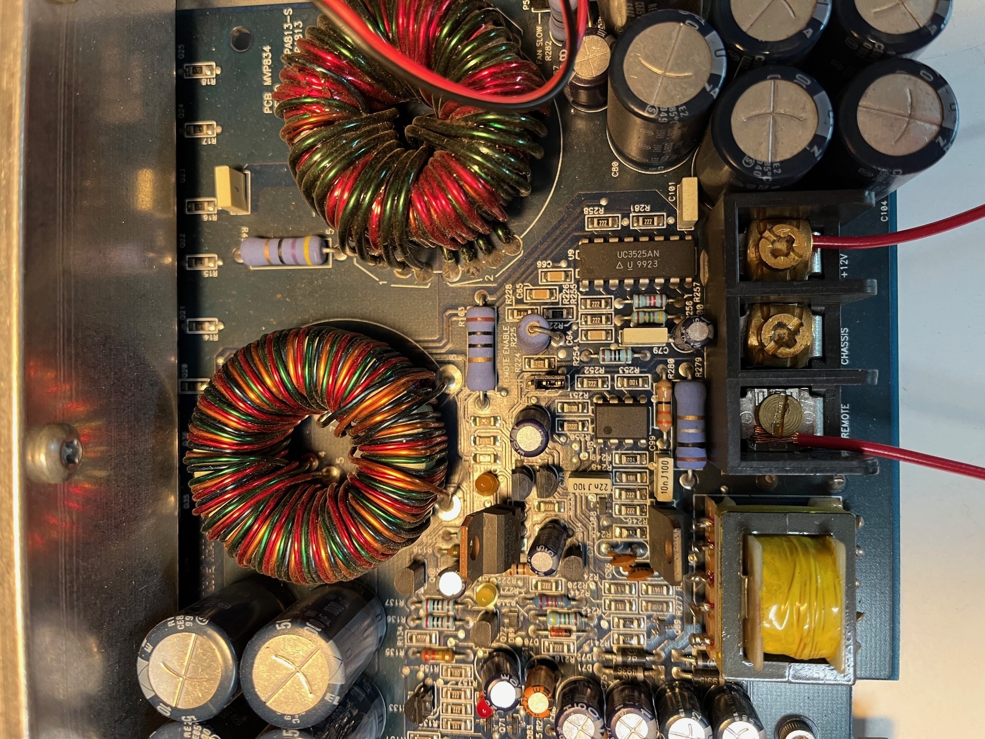

Hi, I am having trouble with this Xtant 403A amp as it won't power on. I also having another working one of this amp so I am able to compare. I did check all power supply diodes and mosfets and they seem to be good. No obvious burnt components.
When checking voltages I am not getting 12v on the power pins for SG3525 (pin 13) and UC3843 (pin 7). I trace these back to Q61 which appears to be the source for the power. My working unit shows 11.8v coming off the collector and 0v on the non working unit. In addition, when I trace voltage from the remote enable jumper it goes to R219 and D78 and I get 12v here but 0v and other side of each device. In the working amp there is ~6v on other side each device. D78 goes on to feed Q83 and Q71 which appear to control red power on led and feeds back to the base connection of Q61. Not sure what R219 is doing.
As I don't have a schematic hard to know what to look for, any help would be appreciated.

For the transistor that has its collector directly connected to pins 13 and 15 of the 3525, place your black meter probe on the emitter. What is the exact DCV on its base and collector?

It looks like it is a MPSA56. I am getting 0 vdc across emitter to base and -13vdc across emitter to collector. For the working amp I get e to b -.08vdc and e to c -.079vdc

Oops, yes you are right it is .8 v E-B. The protect led is not lit up but not sure how to further test. And yes, all the Fets are clamped to the heatsink.
You said that you checked the dodes but on a similar amp, there is a 6.3v Zener. If that is shorted, that will give you 6v on one amp but not on the other. Does your amp have that diode?
If so, is it OK?

Yes, I think that is D78. When I check with diode tester I get ~600 ohm in one direction and really high ohm reversed direction on each amp zener. When I check the voltage with power on I get about 7V across working amp diode and 12v across non working amp diode. Does that probably mean zener not working as it is letting full 12v thru?

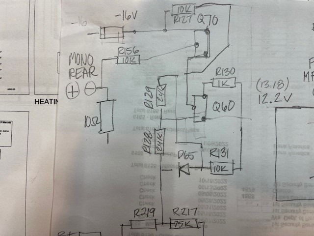

Could you draw a diagram of this small section of circuit?
An alternative (not quite as safe), would be to bridge the transistor feeding pins 13 and 15 of the 3525 collector to emitter to force the amp to power up. With all FETs clamped and a 10-15 amp fuse in the B+ line, there shouldn't be much risk to the amp. If all channels work, you know the problem is in the control circuit. If you see a problem with one or more channels, that will lead the troubleshooting in a different direction.

Here is what i traced out not sure what the other transistors are as they are small surface mount. The second image is what branches off from resistor R219 at top of first image. Not sure I completely traced that one out all the way.
I did double check A56 and it isn't shorted and measures resistance same as working amp one. I will fuse the supply and bridge A56 to see what happens.

And forgot to mention I noted test voltages on the working amp and the ones in parenthesis are non working amp.
Ok, I did jump E to C on A56 and that seemed to fire it up as the amp starting pulling significant current off my bench power supply to it, and the cooling fan started running.
