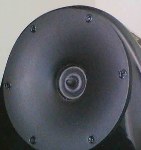

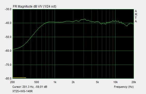

So I finally got the 3D printing done. The faceplate is off but the adapter is essentially the same size and thickness of the faceplate(same thing really) so depending on who advice from the above posts is correct I might have the problem of the throat being too long.
I did putty between adapter and the waveguide which sealed very good, the slight tint of brown colour you see. But, there was scaling on the 3D printing along the throat so I attempted to seal that with some type of thick substance(nail glue) and it didn't end very well getting some close to the tweeter. I can potentially use a tiny sand paper and try and clean it up a little. Not sure how much it will effect the sound.
After checking out Dcibel's normalized polar plot,(although uses a different tweeter) it seems very difficult to find the correct crossover point but somewhere around 2100 and 2200 would be the best bet.
Now, for testing and working the Hypex filters.
Thanks for everyones help.
