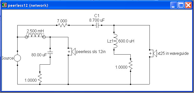

2 Spatz, yes, I sawed off throat of waveguide.
this is final crossover for this speaker.
