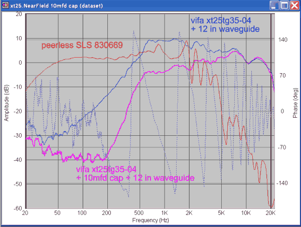

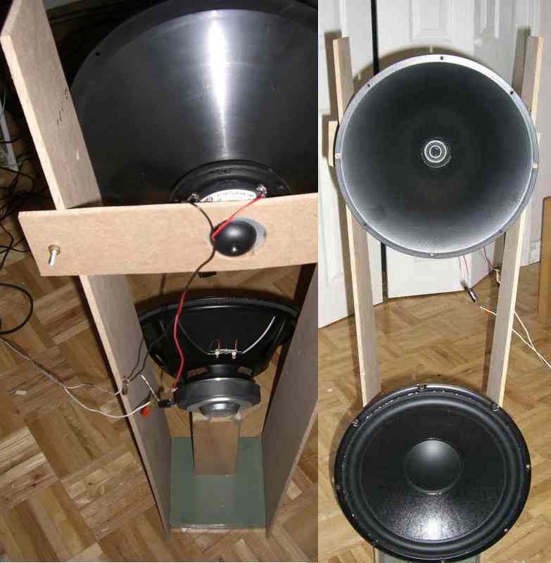

xt25 in 12in waveguide experiment
looks like I can crossover xt25 in 12in waveguide at 500hz 🙂
I don't know how loud it can play with such low crossover point,
at low volume tweeter sounds pretty good.
woofer measurements are near field. this woofer will need bass boost.
for now it's baffleless, later I'll probably add baffle.
for amplifier I'm going to use 4 channel t-amp
and equalize woofer with graphic equalizer.
i second jay here, it's not cause it's still playin that it's good, or not distortin. You should add a second pole to your filter, to make a crossover around 1khz, and even then i doubt it will be ideal, but it will be good enough i think

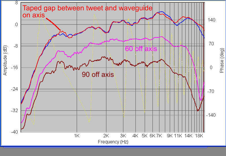

I taped gap between tweeter and waveguide with electrical tape, now it's almost seamless. I tried to play tweeters louder, It plays louder than I expected before becoming shouty. it's hard to evaluate tweeter alone. after I add woofer, I'll test them with good amplifier and let you know at what volume sound becomes unpleasant.
unfortunately I don't know how to measure distortion in speaker workshop. I haven't measured TS parameters either(will do it later).
you are all referring to Zaph's xt25 measurement, but he
tested G30 model, I am using G35(with ferrofluid)

Same 12" driver, 4 channel Tripath amp, with a Selenium compression driver on a 12" waveguide. (Why? 'cause I have them).
I agree with the other posters here. You will probably want to mover you x-over point up. You might be hoping to get out of the Peerless 12 as soon as you can, but you really don't have to. Crossing up higher will likely sound better. Or using something else on the WG.

the problem of xt25 is not the motor i think , wich is quite nice, it's the very small radiating area. You should try somethin like one of the seas tweeter or the peerless SLS , or the Dayton RS52 tweeter if you really want to cross that low.
Very good idea appart from that, i wish you the best of luck

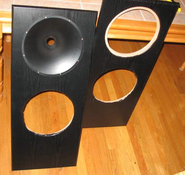

thanks for comments everyone. TurboFC3S, those are very nice looking speakers you made.
I'm going to work on crossover later. I just checked how tweeter works in 12in waveguide, I'm impressed how well it sounds off axis. First of all I need to make nice looking baffles (well, maybe not as nice as in TurboFC3S link 🙂 )

Thanks, they did turn out incredibly well ... better than I hoped. The waveguide literally changes everything about how a 1" dome tweeter performs. I think you'll find that it's an addictive sound 🙂
