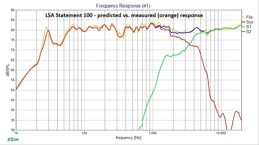

Here is an example of how well Xsim can do in predicting the response of one of my speakers vs the actual measurement using a production crossover PCB (orange is actual measurement and blue is prediction by Xsim):

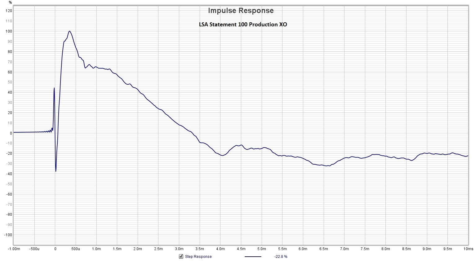

The predicted Step Response matches perfectly also - but here is just the measured Step Response - a very nice behavior close to the ideal right triangle shape:

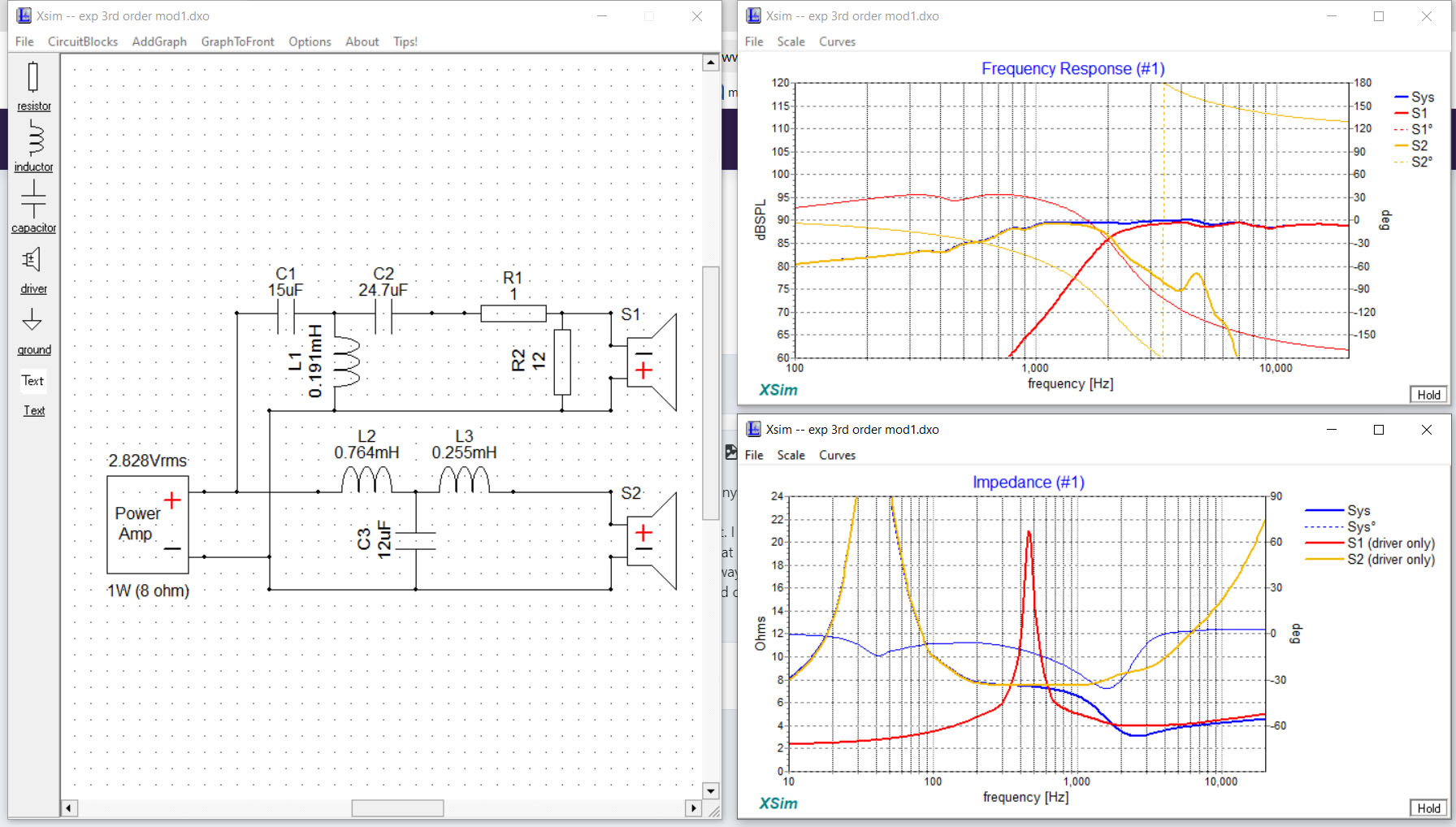

I have this 3rd order crossover project just as an experiment. I constructed the FRD and ZMA as text files from manufacturer graphs, so I realise they are a bit theoretical at this point too. Component values started out at Butterworth then drifted with adjustments in capacitors. I was just wondering if you cast your eye over it, and feed back your observations, so I can learn my way around 'steering' it, and what needs steering to get what effect.
I am still learning around what makes a good graph vs a bad one, what statistics are the vitals, and which are the less dramatic.

Look for a base sensitivity (level). Your response rises towards 1kHz but it would ordinarily want to stay where the lower midrange is. Make it fall slightly towards the top.
However the outside of your box will probably raise the upper midrange and treble even beyond this. The inside of your box will also raise some of the lower frequencies.
Thanks, that's interesting - so if I were to target more like bringing the overall level more around the 80 to 85bB line?
Is that dip under 4ohm on the system impedance any cause for caution? small impedances make something inside me say 'don't short circuit stuff!'
The process of reducing the tweeter level will probably tend to ease the impedance dip
Did you include the phase responses of the SPL and impedance responses of the drivers? That would likely have been done using a minimum-phase transformation, but some manufacturers include the phase data with their impedance curves.I constructed the FRD and ZMA as text files from manufacturer graphs, so I realise they are a bit theoretical at this point too.
It would be handy to know which drivers you are using, so please provide some further details.
