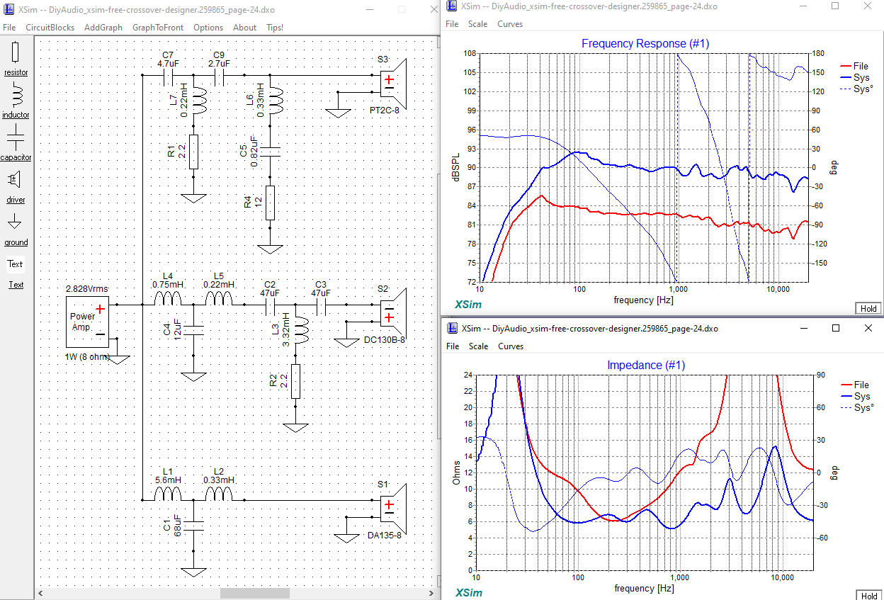

Post your Xsim save file and describe the trouble you're having. Some of us may find the reason.Is it a case where I need to comprimise between the two, do I need to add components,

As requested though, I've attached the XSim file. There may be many issues, I only see what I see, but as you have previously pointed out, the phase traces are an issue. I can't correct them without comprimising the frequency responses, which highlights my lack of knowledge.

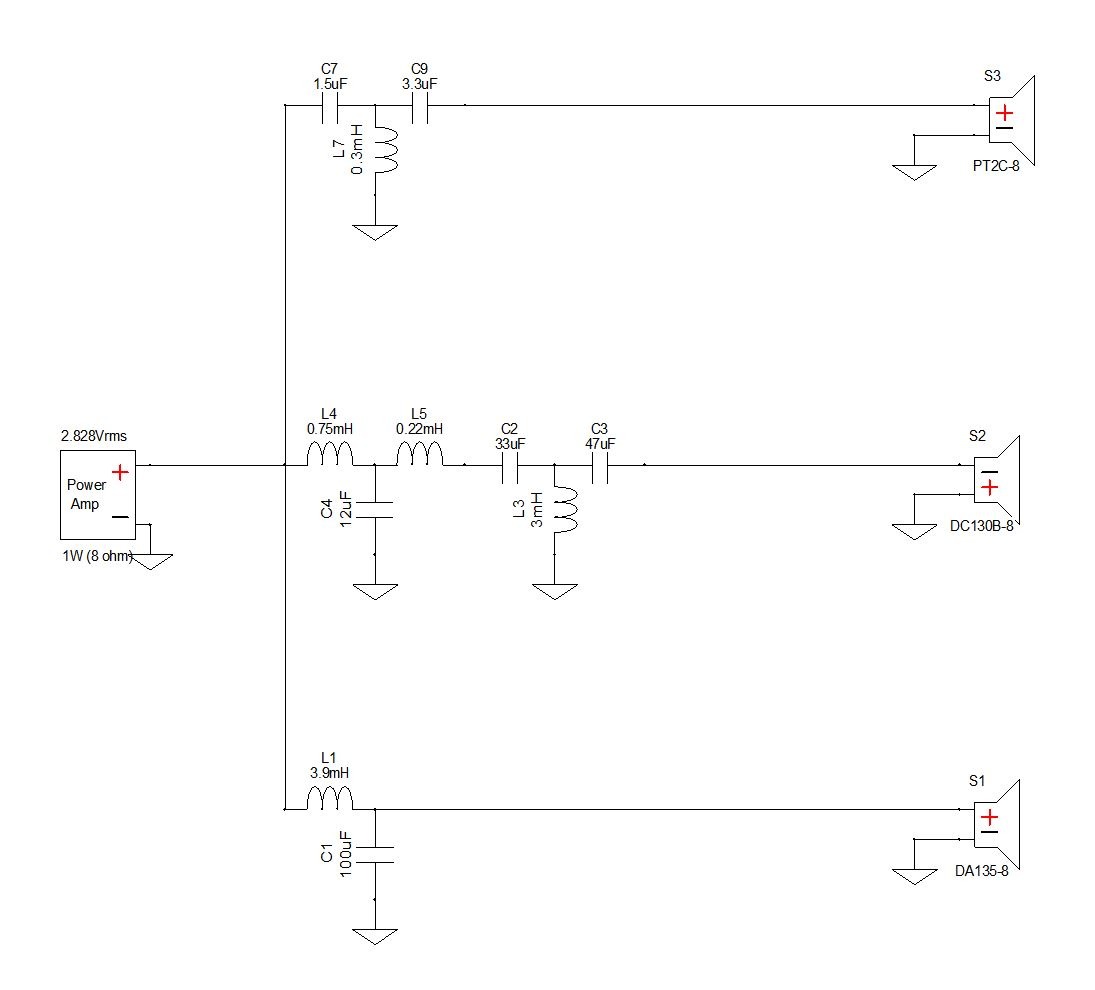

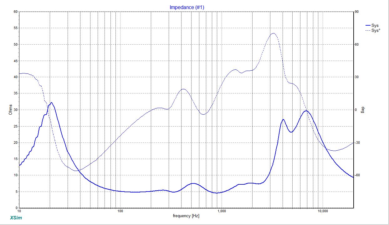

That's definately simplified, but looks good. My only issue with it is the 4ohms load, as I have an old 80w Sansui which wasn't designed to run those loads, it can, but only running a low to medium volume and ideally not for very long. I'll be upgrading next year, so this might be a moot point, but I do like your work, it's definately giving me something to think about.
There's also much more sensitivity which makes the peak current demand milder (for a given SPL)

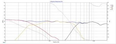

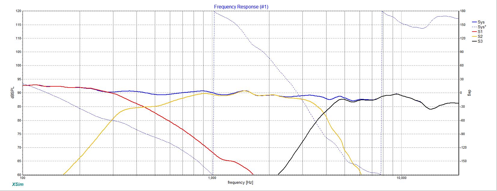

Not real work, was just a quick twist on Stormbringer's work. As an example in simplification and trade-offs. BTW here's pictures for all to see without having to run Xsim. Also L1 C1 values further altered a bit for better Zmin nearer to 5Ω.
