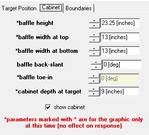

There is a YouTuber named ImpulseAudio using x-sim 3D. It has bafflestep and driver location input fields. I cannot find this. Anyone know about this version?
Thanks.
Greg
Just be aware that XSim 3D was never finished and has some bugs. And as Ryan (aka ImpulseAudio) pointed out, the baffle step calculation isn't implemented. See the attachment for clarification.

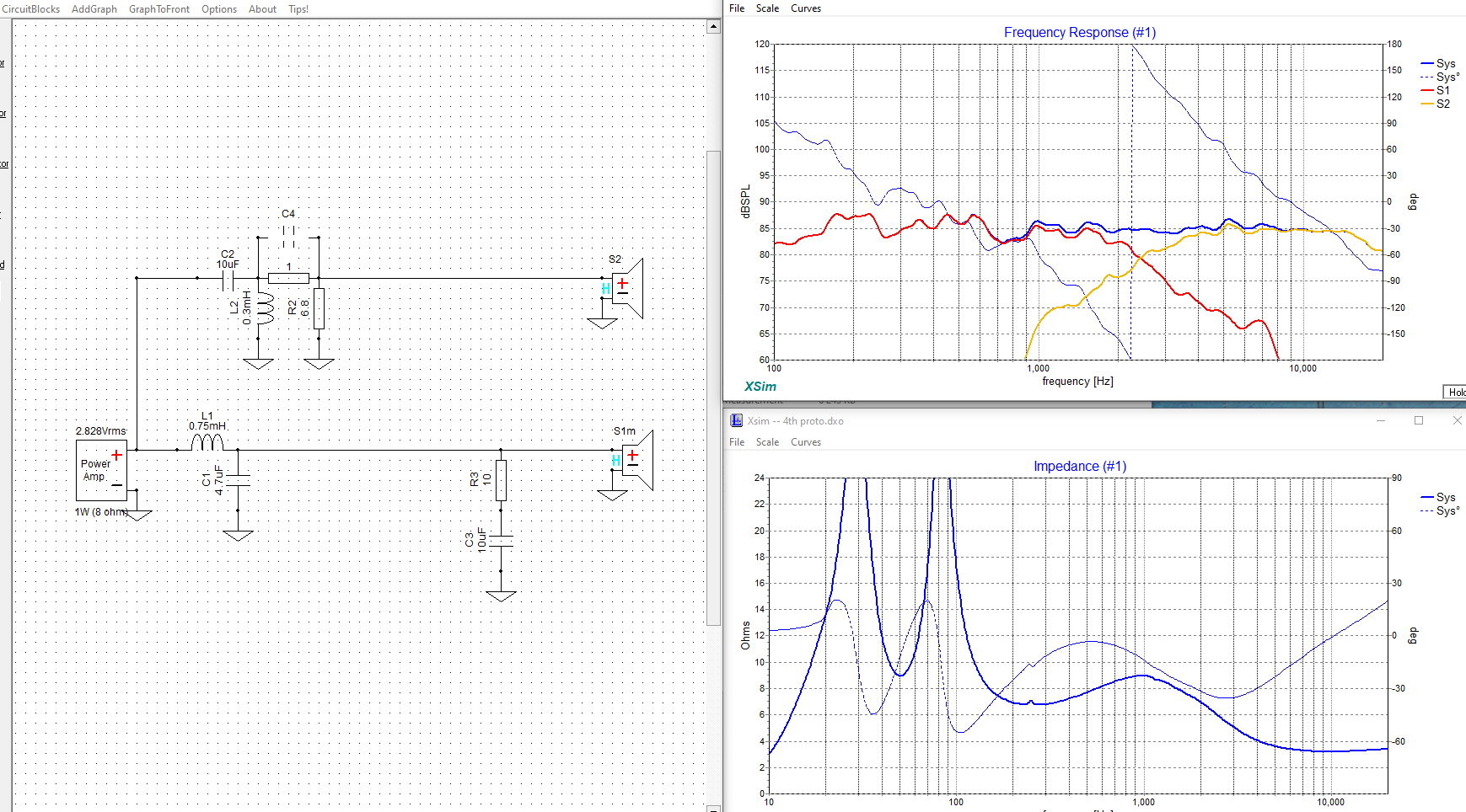

Hi everyone!
I am building an on-wall kitchen speaker. It is 2-way speaker with shallow boxes, 1" dome tweeters and 5" woofers. They are SB acoustics sb13pfcr25-8 and sb26stcn-c000-4.
I made measurements in the position they will be installed in and also sketched crossovers in Xsim, please see pictures.
Does it look reasonable? Any comments welcome.
Probably power response is bad and sound unbalanced with that axial response. Should not design by axial only.
Kimmosto, thank you very much for your comment.
Unfortunately it does not help much due to my limited experience with speaker building and Xsim software. I made measurements on the position the speakers will be placed on the wall, about 1m from the speaker and 3-5 degrees off axis. I have not calibrated the power to 1 watt, so the db/watt ratio is not appropriate. However, it is consistent between the woofer and the tweeter.
May I please ask you to be more specific so that a newbie like me can understand what is not correct and how to move forward.
Thanks again.

^I don't like to hijack this thread and advertise some other design philosophies, methods and software too much. At least design axis should be higher e.g. about 15 deg to design with single response per driver, or more off-axis measurements per driver captured and speaker simulated at least to half space in horizontal and vertical planes to get some estimation of power response and listening window average etc. which define overall/average sound balance in the room. My signature has links to different approach.

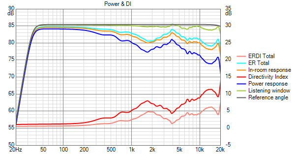

Next example is worse case than your project due to 6.5" woofer and box shape, but shows how bad could happen to "sound balance benchmarks" when optimizing axial only with too steep XO, without knowing anything else than axial measurements show.

I think it is a good start. I would consider rounding the edges because it is close to the wall. This helps where diffractions may double up by reflections from the wall. I understand that at lower frequencies this can turn into a benefit.Does it look reasonable? Any comments welcome.
I think your Xsim crossover is a good start. By using a low crossover you are making sure the power response is better. You should see if the treble is the right level for you, some may like a small downward slope.
