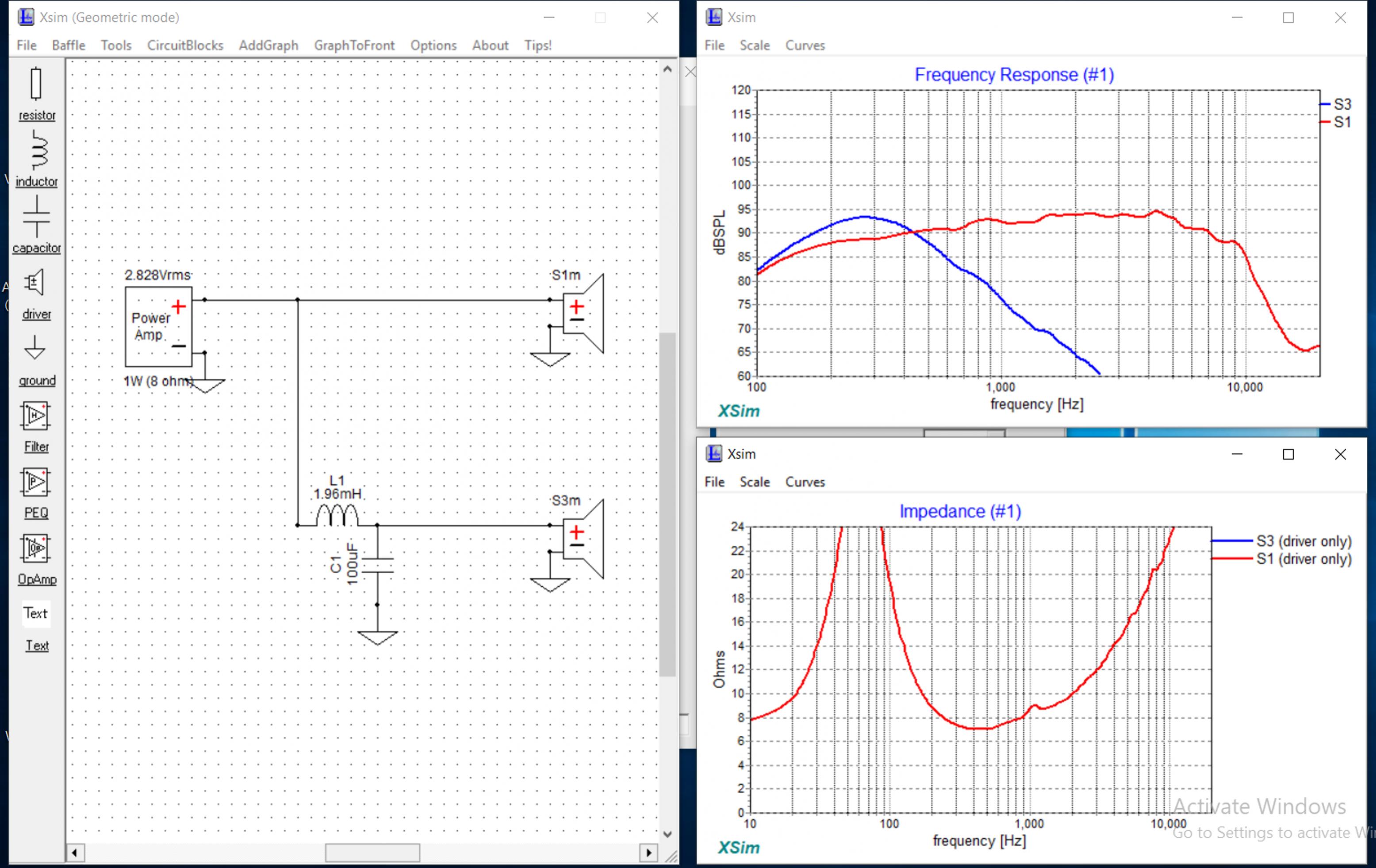

IS there any way of converting manufacturer's t/s parameters (like .txt) or those obtained by DATS2 program into usable files for this program?

XSim doesn't do anything with t/s parameters (those are for box design, not crossover design). You can use the ZMA exported impedance data for XSim's impedance curves of drivers being designed for, though.
Carl and woody, you can get great help here to use this magnificent software, however first there are a few things you need to do.
As I understand speaker crossover design you need to get your drivers in your enclosures and measure the individual driver frequency response and impedance. You also need to measure the combined frequency response of your drivers.
Once you have your zma and frd files the crossover magic can begin!
So for an open baffle I have to measure frd and zma with the drivers already placed in the baffle? Maybe is a stupid question but I never used this kind of software...
Correct. Applies to any speaker, not just dipoles. You measure the response of the drivers from a reference location on the baffle (or in the enclosure) they are used in / on.

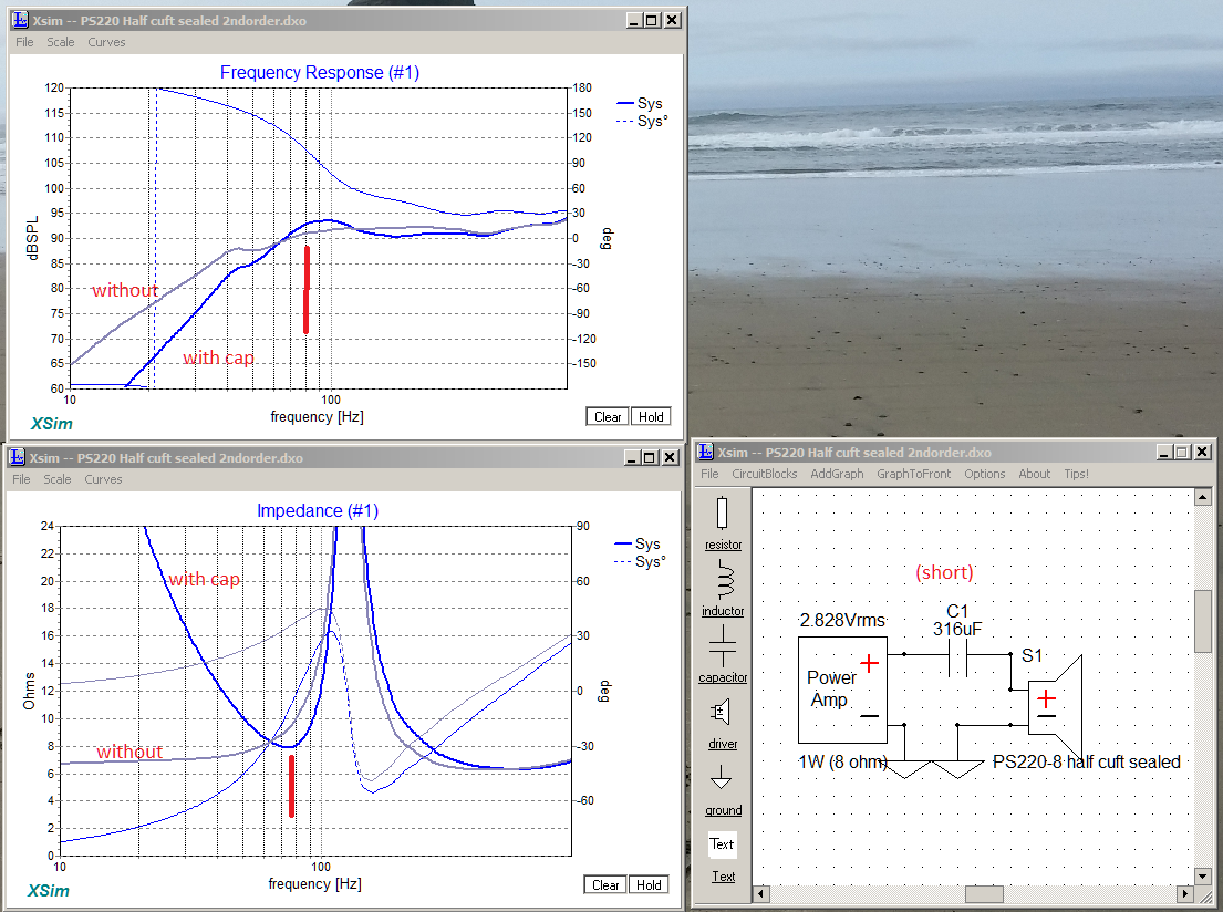

Nope, that's real. The inductor and capacitor form a series resonant circuit (narrow band impedance transformer), making the voltage at their connection higher than the power amp's voltage, so more power is applied to the speaker near the resonant frequency. The tradeoffs are (1) it makes the load impedance drop at the resonance and (2) it only works over a small frequency range and drops the level at most other frequencies.
There's a similar trick you can do with some woofers where you can feed them through a large series capacitor. The cap resonates with the inductive part of the woofer's impedance and pushes a boost into the response at resonance, similar to venting a box.
