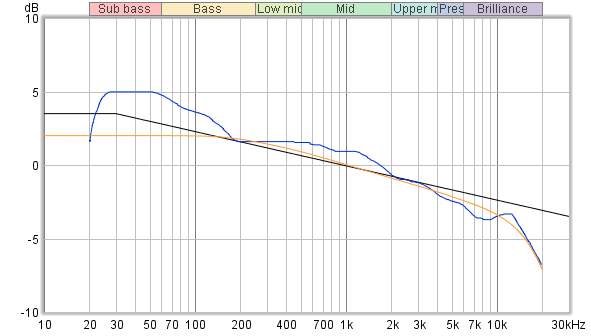

While optimising curves with actual loudspeaker curves as input (2..3m distance) I am aiming for a sloping down room curve (and perhaps it's in XSIM but I am not aware of it so I ask)...so it would be nice if in XSIM you could load a "Speaker" that is actually a sloped down room-curve (The B&K?). After plotting this in the graph, one could push the "HOLD" button and use that curve as a guideline to map the actual total curve on. Does this exist in one way or the other (or would it be a good feature to add)?

Hanged on below in three zip folders is frd target files for a 7dB curve (+3,5dB at 30Hz and -3,5dB at 30kHz) and the JBL F. Toole curve for trained listener and final curve is the B&K. One can load them in Xsim "Curves" meny but in they centered on vertical axis around 0dB point its smarter as you say load them on a temporary aux driver where on can offset them to whatever sensitivity number using Xsim dialog "mod sensitivity" and push "Hold" before dismount of aux driver.
Used them....and it's great...! Makes life a lot easier.

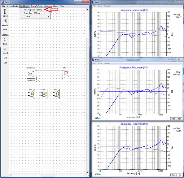

Is there also a feature to store/hold several curves in 1 graph?
...Is there also a feature to store/hold several curves in 1 graph?
In a way there is in one can in Frequency Response window load one more FRD file via "Curves" meny then "Get File" but one can't offset its vertical axis scale up and down on the fly so you have to prepare that curve to the right SPL area, for example first load curve as a AUX driver and adjust vertical axis to area of interest, now in Frequency Response window pick "File" then "Export system FRD file", and finally load that exported FRD file via menu "Curves"/"Get File".
Probably if you have plenty of screen area its more easy do as in below visual where the three target curves was "Hold" in each their Frequency Response window, see red arrow : )
