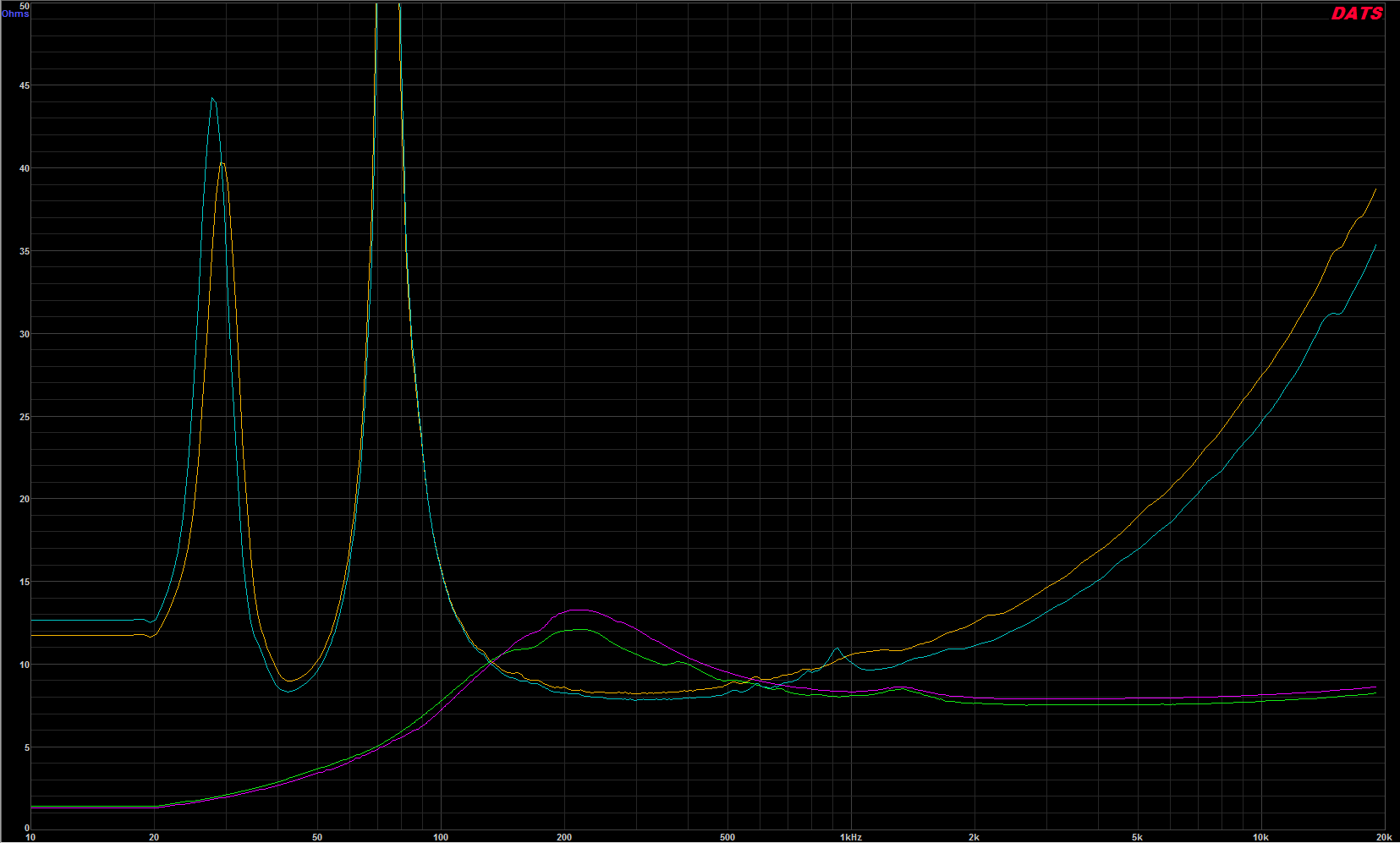

First I want to thank Bill for this excellent little utility, just what I've lacked in the past on previous projects! 😀
I'm attempting to use it for the first time to redesign and optimise the crossovers for a 2 way project and I've just completed doing detailed measurements of both drivers using ARTA and LIMP and have exported that data in FRD and ZMA format - both including phase data.
Unfortunately when I try to import the driver data into XSim while the FRD data imports perfectly I cannot import the ZMA files - I get a cryptic "file load error! -- Coral Left Impedance" followed by "File Load error: ----------" where --- is the path to the file. I get the same error with both ZMA files.

Using REW to import ZMA files can reveal error in it tells that line one and two is in conflict in they use exactly same frq point, so opened them with a txt editor and bypassed or deleted one of the two lines helped. Below is viewed into DATS because it can overlay them all in one shut, a note is those Aurum Cantus looks taking scary direction below 20Hz be a short down at DC.
Thank you! Well spotted, I had not noticed that at all. 🙂Using REW to import ZMA files can reveal error in it tells that line one and two is in conflict in they use exactly same frq point, so opened them with a txt editor and bypassed or deleted one of the two lines helped.
I've deleted the first line and sure enough it now loads correctly. So it looks like this is a bug in ARTA's export not XSim's import, although a more useful error message would have helped find the problem more easily.
I'll report it in the ARTA thread.
Perfectly normal and not scary - they're ribbon tweeters with a built in step down transformer, so what you see at DC is the primary resistance of the transformer...Below is viewed into DATS because it can overlay them all in one shut, a note is those Aurum Cantus looks taking scary direction below 20Hz be a short down at DC.
The transformer deliberately has very few turns per volt to minimise saturation problems which is why it only works down to about 500Hz. From about 1Khz to 20Khz the impedance is much flatter than a normal dome tweeter so very easy to work with in the crossover. The tweeters own resonance is the slight bump about 1.5Khz, and the larger bump at 200Hz is a transformer artefact.

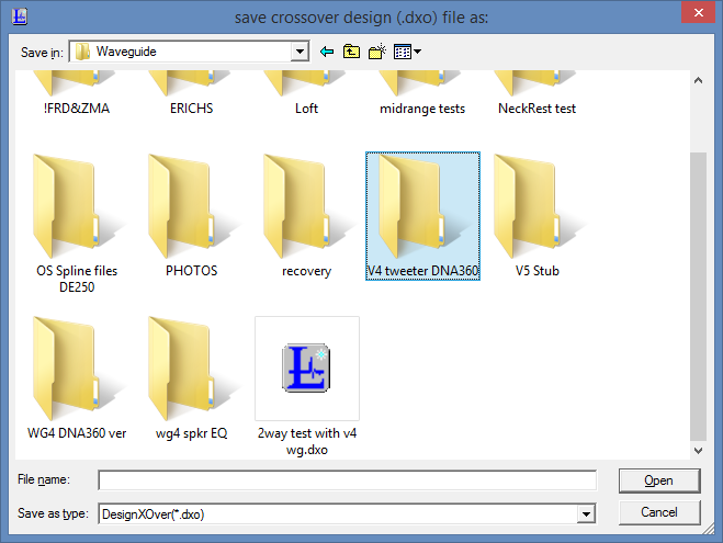

Sorry Bill, I used the wrong term, I meant the filter elements. If I save the project in My Documents then when I go looking for crossover elements to plug in, XSim now looks for them in My documents. That means navigating back and forth thru layers of folders each time.
Maybe I should put a shortcut to the users/public/xsim folder into My Documents to speed up the navigation. But it would be nice if XSim remembered 2 locations: Where the files are saved, and where the elements are saved. Or should I just move all the elements into a more convenient place?

Pano, I don't think I understand what you are referring to as "filter elements" -- do you mean the "Circuit Blocks"? (and if so, I think that might make you the only person who has tried designing any of those!).
Yes - Circuit Blocks, that's the ones! I love them. I often start with those, then break them apart for fine tuning.
Oh, ok. Do you want the program to always look for them in the same place (or keep a separate record of where the last one was saved to maybe)?
Are you designing your own Circuit Blocks, too? (File->Change Mode->Circuit Block Editor) or only using the ones already provided? They're a little tough to design from scratch, you need to have formulae for all the component values in the block, in terms of the variable names you pick. I know that can be a little buggy to do, no one seemed to ever use the Circuit Block Editor mode, so I never went back to see if it could be made any more crashproof.
I have made one or two, but I don't remember much about them. Maybe I just modified a stock one and saved it.
Yes, if the software could just always look for the Circuit Blocks in the default folder, that would be a big time saver. It does fine remembering where I've saved to other files.
