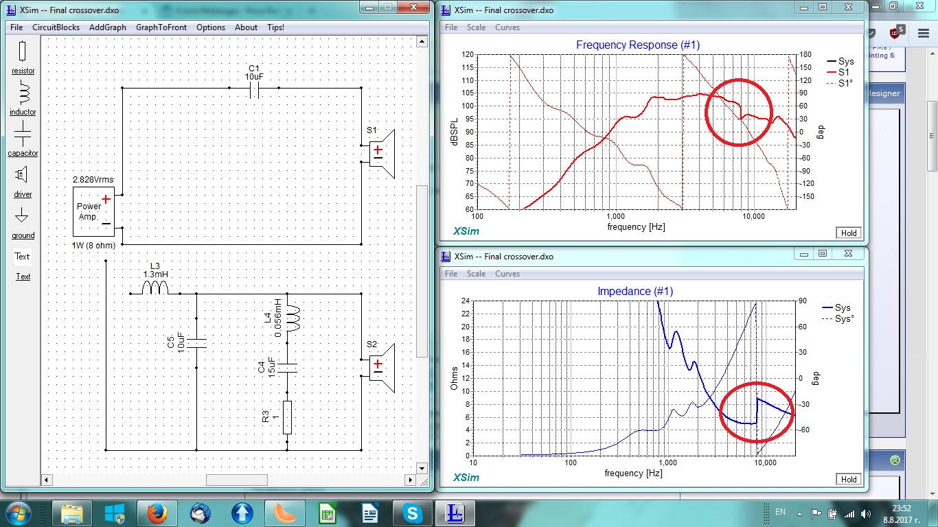

See the two screenshots - both made today under the following conditions:
- all equipment and speaker under test static
- air temp within +/- 2C
- humidity stable
- mic is a calibrated Beyerdynamic MM1 (even if it comes calibrated out of the factory)
- mic amp is a StageLine MPA102 suggested by the lab that did the calibration

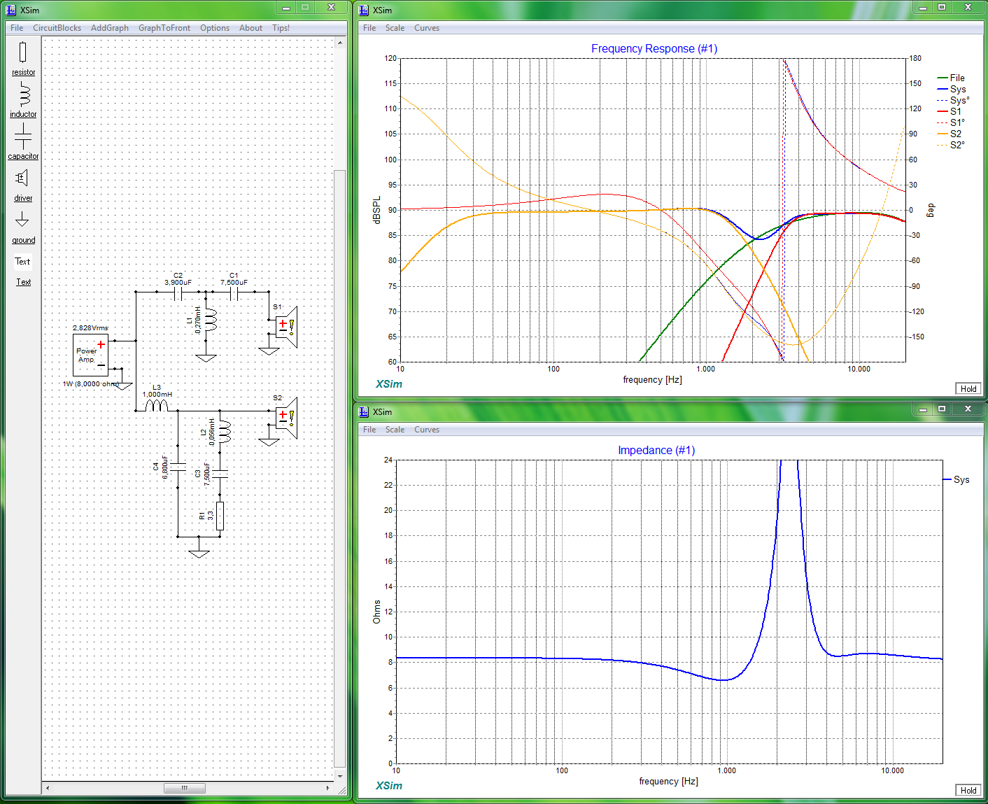

Xsim produces (evident) a massive spike in the input response where the actual measurement does not exhibit such pattern. I very much like its interface but this glitch and the lack of target responses still forces me to use other softare. Otherwise its pretty nice. Would be interested to hear comments on what could cause this erratic behaviour.

Hi Mario Pankov,
Normal XSim predictions is in sync with real world so something most be filled or executed in wrong way.
Have two comments to look for mistakes, first is can see some excess dots on wires in schematic window and these points to maybe some wires is a short under some components and to seek for these hidden wires lift every component and drivers to one side to look for if a short is underneath, second fault to look for is because we can see both drivers have some delay added seen by the "m" symbol and think that is strange because normal one is reference and then the other is either advanced or delayed relative to reference, so look for any weird delay settings that makes the two drivers cancel.

No, the extra dots do not correspond to wires that might be invisible. No delay on both. Have a look below. First one is directly connected .FRD. It looks normal as the recorded frequency response. Now, I`d add a capacitor - 10uF - immediately there is this erratic response at 8Khz. Photo 3 has the cap reduced to 3uF - look at the effect. I had abandoned XSim as I was using PCD and it worked fine but recently switched to LibreOffice whose Macros appear coded differently and it can`t launch the PCD. So went back to XSim but something is wrong here and I wonder what.

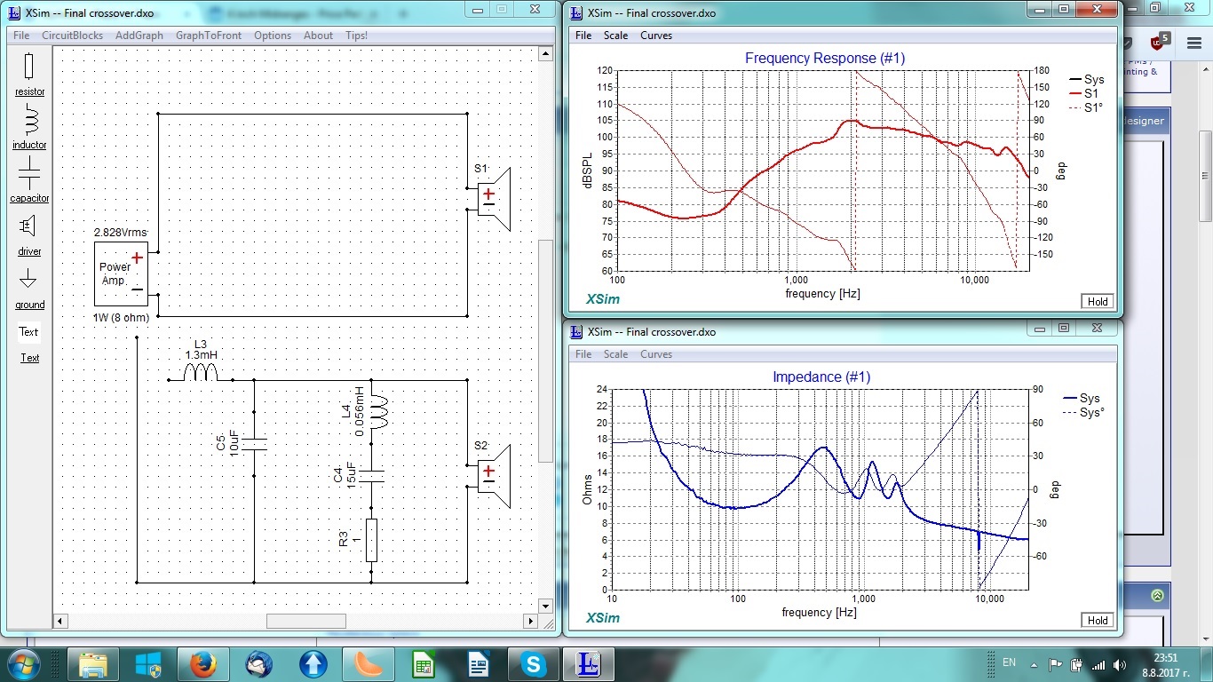

Can see it looks weird and don't think its because you don't have any ground symbol in schematic window, but suggest try remove zma file for S1 and keep its frd file and see what happens then when adding a capacitor, say this because glitch at 8kHz in impedance plot in first attachment is not normal looking and its impedance phase shift is enormous.

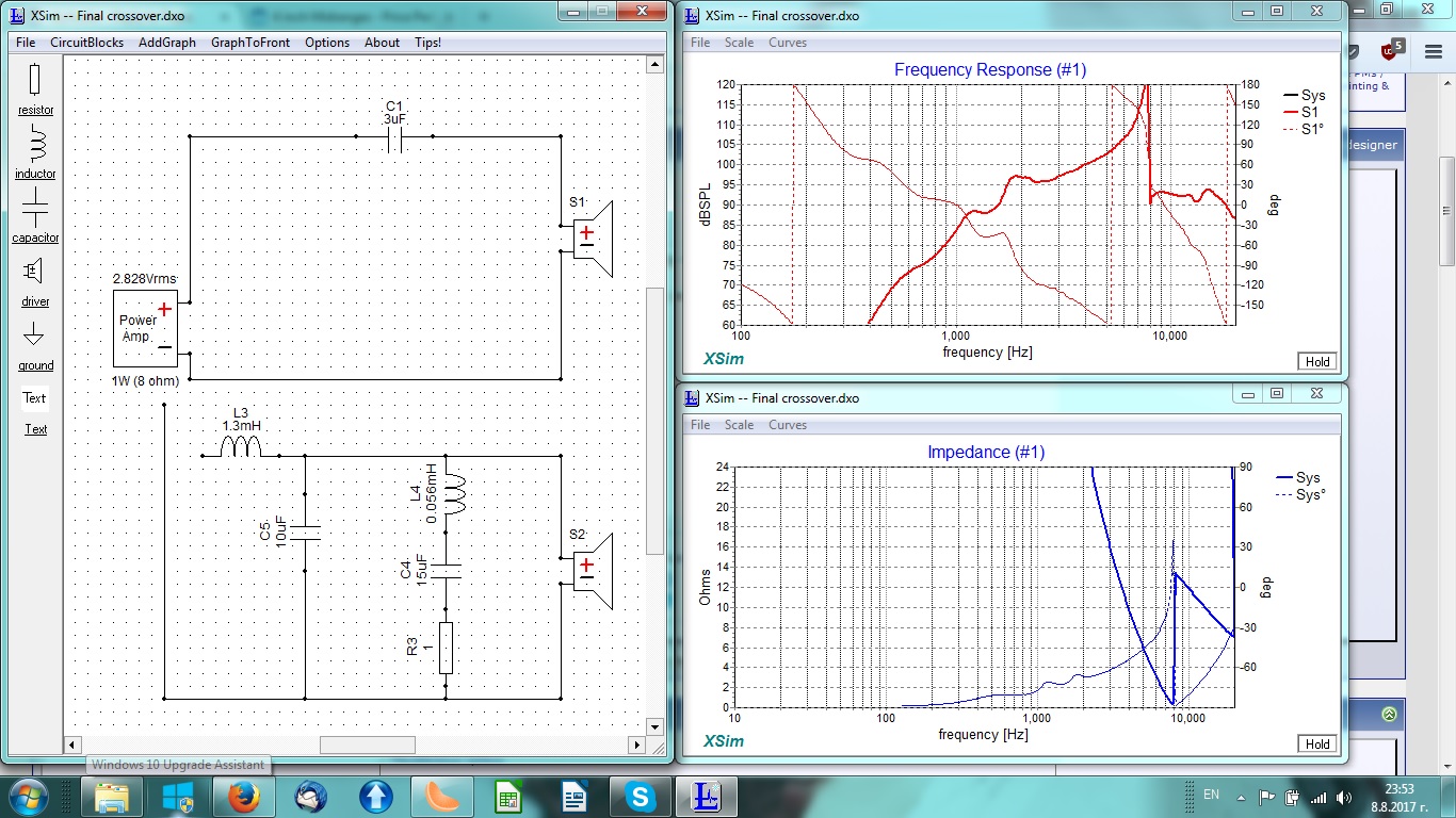

Well spotted, once the impedance is removed, the frequency response becomes as measured. Is it possible the phase in the .ZMA file to be in conflict with the phase in the .FRD?
Great it worked, about that zma file think its flawed from beginning because look at its other places of variances in few ohms and nowhere its causing phase shift as enormous as that little resistive glitch at around 8kHz, so try probe driver once again for a better and true zma curve, maybe close all other programs when measuring for impedance so as computer have most possible resources to get glitch free curve.
Just look at the impedance for that driver (you can select S1 in the Curves menu of the impedance graph). See if there is anything odd with it. You can also look at the .ZMA file with a text editor to see what looks wacky there -- there won't be any abrupt impedance magnitude changes in a real driver and impedance angles more than 90 degrees or less than -90 degrees are impossible.
Impedance will not have ANY effect if you connect just the driver to the ideal "Power amp", it can drive anything!

Thanks for dropping by. I did explore what could be wrong and noticed the impedance in the ZMA measurement (exported in column data) starts to decrease after 8Khz with a 90 degree phase change. This is not possible so today dismantled my resistor box to see whats wrong in it and I think I found the reason but am to tired to work on it today.

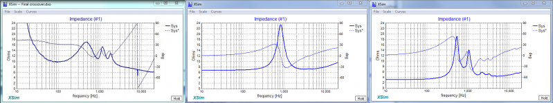

.....today dismantled my resistor box to see whats wrong in it and I think I found the reason but am to tired to work on it today.

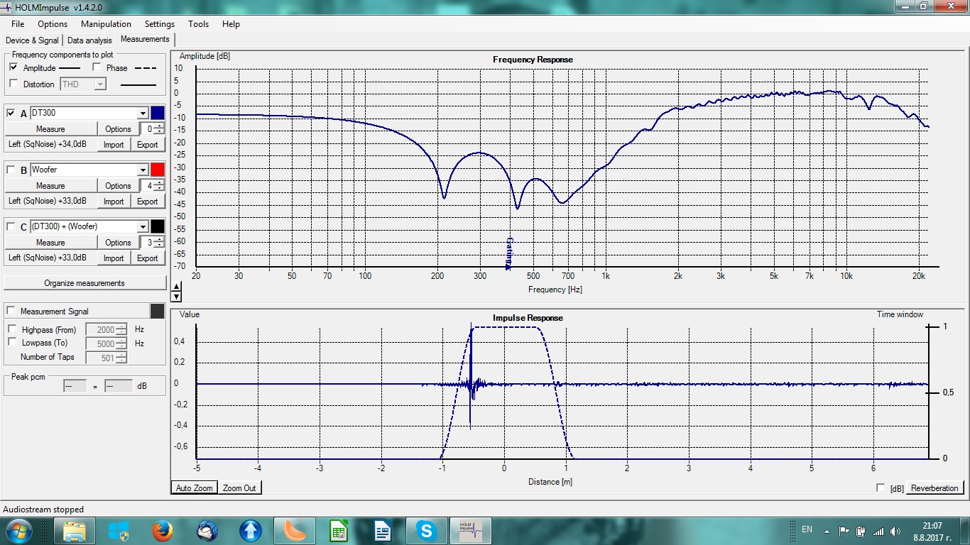

Don't know what jig and software are used but it looks missing DC component and above resonance a raising impedance as frq goes up, if it can help here is camparison to your curve how DATS sweep looks for two nominal 8 ohm units one is Monarcor DT-254 tweeter and one is JBL 2426H in 2370A horn.
There was a broken solder joint inside the test box, I use these often for car installs and here you go. All fine now (even changed the resistor to a non-indutive type haha).
