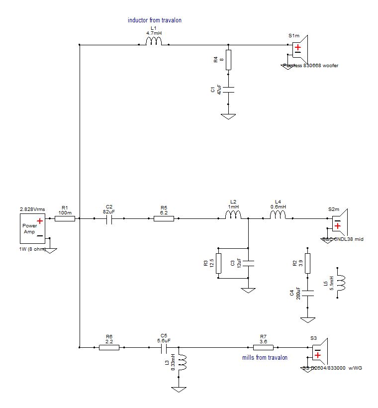

I'm at the stage now with Xsim and crossover design where I have a decent grasp of the necessary concepts. But, I have been following a couple threads of late where Diyaudio members @Douglas Blake and @jReave have made to compelling post that has me thinking I don't know that much after all.😀 So, in the pursuit to dive further into learning more advance uses of Xsim and crossover design in general; I have attached some screenshots of a current 3 way speaker that has been my winter project. Also, I have included the Xsim .dxo file so others can play along as well. Sometime later today, I will take a couple photos of the one speaker that is completed. The other is in the final stages of french polish shellac and needs maybe 1 more week (hopefully).🙂
The inspiration/ idea for this build came from Paul Carmody's Tarkus design.
Selected drivers:
Woofer- Peerless SLS 830668 (65 Liter VB) ported
Mid range- B&C 6NDL38
Tweeter- SS D2604/833000 w/ Monacor WG300
Thanks in advance! This will be fun learning experience.😀

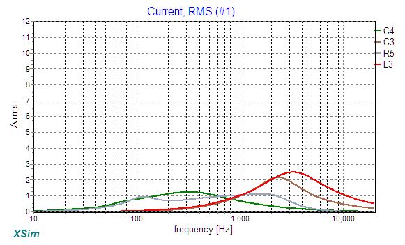

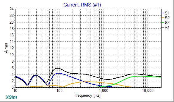

The first current panel with the amplifier output jacked up (because XSim doesn't resolve to less than an amp) shows some inefficiency. Note that the Total Current (blue) is almost always greater than the sum of the drivers below it... For example at just over 100hz you have about 6 amps flowing, but only about 4 of that is actually getting to your woofer (green), then at just under 2000 hz you have about 1 amp going through your mid (brown) and 1 amp going through your tweeter (red), but the total is nearly 4 amps, not 2 as expected.
So the question is... where is the rest of it going?
Well, if it's not going through drivers, it must be going to ground (in the schematic) where it's returned to the amplifier. My goal would be to minimise this as much as possible. The second current panel shows the currents in your shunt components (going to ground)... Here you can see that at least L3 and C3 could be a problem.
In a 100 watt amp at 8 ohms we should expect no more than about 3.5 amps total current flowing, if we aren't to cause some extra heat. There is a nice little calculator HERE to help you with the math.
So there it is ... a look at crossover efficiency... hope that helps.

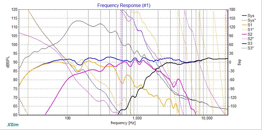

Just by example, the Xsim schematic that I attached does not display very good phase tracking at the crossover points. But, I have noticed in measuring speakers with built crossovers in place several instances those that simulated with poor phase tracking measured great and just the opposite has been observed. So, one question among many, is this something to get overly concerned with in the simulation process or just get reasonable close and than actually check with measurement mic?
XSim does a pretty good job of predicting the output, so what you can expect --without room or cabinet effects-- is pretty close.
I see speakers as "broad stroke" devices. I don't worry about a db here or a few degrees there so long as the overall effect is pretty close to what I'm looking for. Always keep in mind that no matter what anyone tells you, the human ear is a very inaccurate measuring device, so as long as we are "close enough" most designs will be just fine.

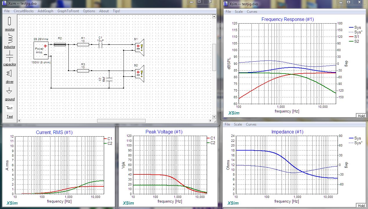

For those who are new at this...If you want to learn more about how capacitors coils etc. behave in circuits here's a very simple test jig in XSim....
Set up the panels as the thumbnail shows and play with the values of C1 and C2 you can see their behaviour in the graphs, both as series and as shunt components. Now replace them with coils and play with their values and see the effect.
The rules are pretty basic...
Capacitors conduct more as frequency increases
Inductors conduct less as frequency increases
Resistors conduct evenly at all frequencies.
These three basic facts are the root of all crossover design.

Yea....I have noticed that in my preliminary testing. I tried to address the mid range breakup with a RC tank over L2 as @Rallyfinnen suggested but current looks like it has a runaway.😱
Would you be inclined to avoid overuse of second or third order filters with components going to ground? If so, how do you achieve steeper roll offs where necessary?

Hey Rich,
I've a look at things and here are my 1st reactions:
1 - Turn off the system phase in the FR graph. It tells you nothing and just adds to the visual confusion.
2 - Get in the habit of always choosing the same colors for your drivers. Again, it lessens confusion. From my time working with PCD, I always choose black for the system response, red for the tweeter, blue for the woofer and the pinkish purple for the mid. Make your own choices of course but I suggest try to be consistent.
3 - Also for less confusion, I'd suggest formating the xo schematic with the tweeter at top and woofer at bottom. It's more natural for me to look at it this way anyways.
4 - It took me a few minutes to figure out that you are using real measured responses and not simulations. Excellent. But that's a strange result for the woofer. The dip at 150Hz and then the sort of raised plateau right after it makes me wonder if you have blended near and farfield measurements correctly?
5 - Regardless, when I looked at the sim, the 1st thing I saw was a problem with the woofer and mid xo. Way too much contribution from each on either side of the xo point. The woofer is actually only about 15dB down when it crosses the tweeter response.
So what I think will help you is to use target slopes. What I do is go to another piece of software to create them and then I import them into XSim via unconnected drivers. I use Response Modeler to do so which unfortunately requires Excel which not everybody has access to. Maybe there's an easier way to get them into XSim but I'm not sure what that is. Perhaps someone else may be of help on that point.
However before you can do that, you have to decide on your xo points and roll-off slopes which means taking a good look at your drivers. The Peerless woofer is pretty simple as it's been used so successfully in the Tarkus with a 400Hz xo point. Second order acoustic should be fine. That looks like it works too for the HP on the mid.
The tweeter on the other hand has rising distortion and increasing cone resonance below about 2000Hz (courtesy of Zaph again) and the mid looks like it has a vicious resonant peak at about 4000Hz. Unfortunately the mid fails to provide off-axis measurements but given its size, I think 2000Hz would be a maximum to aim for. Given that, I think your choice of about 1800Hz is bang on but I would go LR4 acoustic slopes to be safe and I would notch that mid resonance one way or another. But given this lowish xo point, 400Hz as the other one now strikes me as a little high (ie. not very much contribution from the mid actually), so I might reduce the lower xo point to about 300Hz.

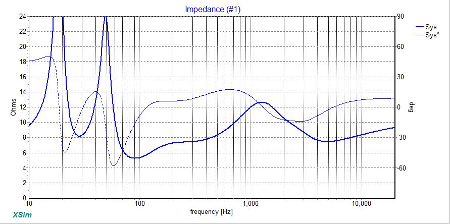

Something else to note is the rather high impedance peak on the mid. Nothing wrong with this per se but when you try to add a HP filter to it for a mid in a 3-way, you can often get a reaction that increases the output at that resonant frequency. I'm not sure yet but an impedance compensation filter may be required on the mid. Or sometimes just a lone shunt resistor of sufficient value can do the trick as well.
Also I'm a little surprised that after modeling the design after the Tarkus you decided not to use the same proven filter on the woofer. Give it a go and see what happens.
To help out, I've attached a new version of XSim with the Target filters included and the tweeter put up at the top. For the Target curves, enable the 'driver only' choices in the FR graph for the new drivers you'll see on the left side of the of the xo schematic. Choose the same color for them all as I think that's easier on the eyes. Notice that I've manipulated the Power amp a touch so your fundamental is properly lined up with the targets.
Finally, all the curves and lines can be visually overwhelming with a bigger design. Nothing says you have to have them all displayed at the same time though. If you're working on the lower xo, turn off the tweeter and the lower xo targets, and likewise the woofer and the woofer/mid targets when you are working on the mid/tweeter xo.
Hope that helps. Now I'll give the actual xo a go.
