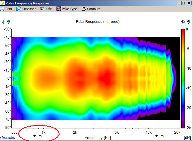

Bill, I just arrived at the party (and I haven't read all the responses here yet)....My OmniMic program, though (can be downloaded free from Parts Express, and can do all the viewing and processing steps without buying the mic) does polar plotting, similar but not the same as yours. People can just feed it a series of FRD files with the angle given within the filename and it will do colored directivity diagrams in several forms.
One question: how do I get directivity shown in the polar frequency response plot below 500 Hz in your OmniMic program? I've got directivity down to just below 100 Hz, but the plot stops at 500 Hz.

Chris,
When you have a polar plot up in OM, look just to right of the "OmniMic" logo at bottom left -- there are two little yellow arrows that control the starting frequency for the plot. At bottom right are similar for the upper frequency.
This must be a version issue with the application--there is no horizontal axis control in the "polar frequency response" window of the OmniMic version that you posted a link to above.
