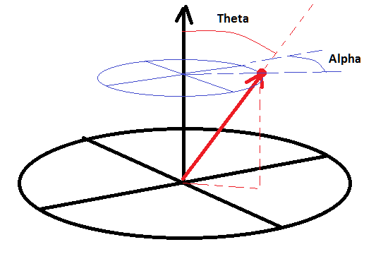

Actually, I already do something like that for interpolation over frequency. I used a "constrained spline" curve fit to map from one set of frequency points to another. In the sim I always work with the same set of frequency points, so when data is read in from any-old FRD file, the first thing that happens is to map it to my working frequency list. I usually interpolate real and imaginary (separately), since that sidesteps the issue of unwrapping phase being somewhat error prone. But I guess there's no reason such an interpolation wouldn't work for points spaced geometrically. But it still doesn't solve my issue of how to combine data taken at horizontal offsets with data taken at vertical offsets.
My test case (a circular piston, where I can calculate response vs an angle "theta" relative to the disk's normal vector) lets me calculate a usable value, and also I can calculate responses from vertical and horizontal offset angles-only values separately so I can check how well various combining approaches work (ideally, the result would be the same using the overall 'theta' value.
I haven't gotten too far into it today (other matters call) but it occurred to me this morning that I should perhaps convert the measured data arrays so the they are mapped, instead of in Horizontal and Vertical angles, into something more "circularly" oriented, see diagram below -
attachment.php
IOW, define an orientation in terms of the angle "Theta" (as before for circular disks) and another angle (call it "Alpha", as its one of the few Greek symbols I recognize both name and symbol for!). I don't remember the terminology for this coordinate system (is this the "spherical"?). Anyway, I'm looking at ways to combine response values in terms of these two angles.... might still not help the basic problems of how to combine. But if I use a basic interpolation between two sets on the same Theta angle (not on H and V directly), but interpolate on the Alpha angle rather than some other parameter, I should be able to get it so interpolating between two data points taken where they differ only in Alpha I can get the same complex result yields the same complex result also. I think. (This is where I would've done well to have spent more time in math classes and less in circuit theory classes 😱 )

Thanks, Earl. I already put together a set of complex math routines the language I use (Delphi, a graphical version of Object Pascal), so I have that pretty well covered. I guess my issue wasn't so much doing a spline interpolation (which I'm doing already for frequency-indexed values) but instead how to do it for something indexed in terms of H and V. I think I might see how to approach that now (see my pic a few posts up), if I arrange the data I index against a little differently. Or maybe not, I have to sit down with some coffee and scratch my head a bit...

As I understand what you want to do, I think that it cannot be done the way that you want. I do much like what you are suggesting and Klippel does exactly what I think you want, but we both do it in spherical coordinates. In that system what you want to do falls out naturally, but in half space, polar coordinates, I think that it is a problem, especially if you then want to go into rectangular coordinates with circular symmetry. It just gets messy.
In spherical you simply define a sphere about your speaker and expand the radiation in the radiation modes of Spherical Bessel Functions and Associated Legendre Polynomials. You can then add or subtract any number of sources in this new modal description and rotate them or whatever you want to do.
That's how I do my measurement system, but only for horizontal measurements. Klippel does the full 3D model. This allows for any level of complexity of the source, but you do then need to be careful of how many modes you use and to what frequency (ka value) or the solution will not converge. There is also a LF singularity that you need to be careful of, but this is the only way that I know of to do this problem.
This was first shown by Weinreich at the University of Michigan back in the 50's, and published in JASA. I did it back in the early 2000's and Klippel has recently redone it (I was disappointed to see that he made no reference to all of the prior art on this.)

Is the diagram I sketched just above spherical coordinates?
Yes, R, Theta and Phi, are the standard spherical coordinates. In what you have defined, theta cannot be periodic with Pi, (the infinite plane means that +-PI/2 are the limits) which would require you to redefine the whole set of functions (I wouldn't suggest that you do that!). If you let theta go to +-PI then all the functions have been defined and are available in most software packages - I have them all in FORTRAN. Its just a matter of organizing the analysis using these predefined functions.
Whatever you do, I suspect that you will need to expand the radiation into a set of orthogonal functions, of which your simple disk is but one. This works fine for the unique situation of a rigid disk, but the minute you deviate from this simplicity that sole function will no longer suffice. You can always define the set of functions that you want to work with, but that is the hard way to go.
I can tell you how to do all of this, but this forum is not conducive to detailed discussions like that. Its too hard to write the math. Read Winreichs paper will help, but be for-warned that he uses very Physics oriented language which will be very different for a EE.
