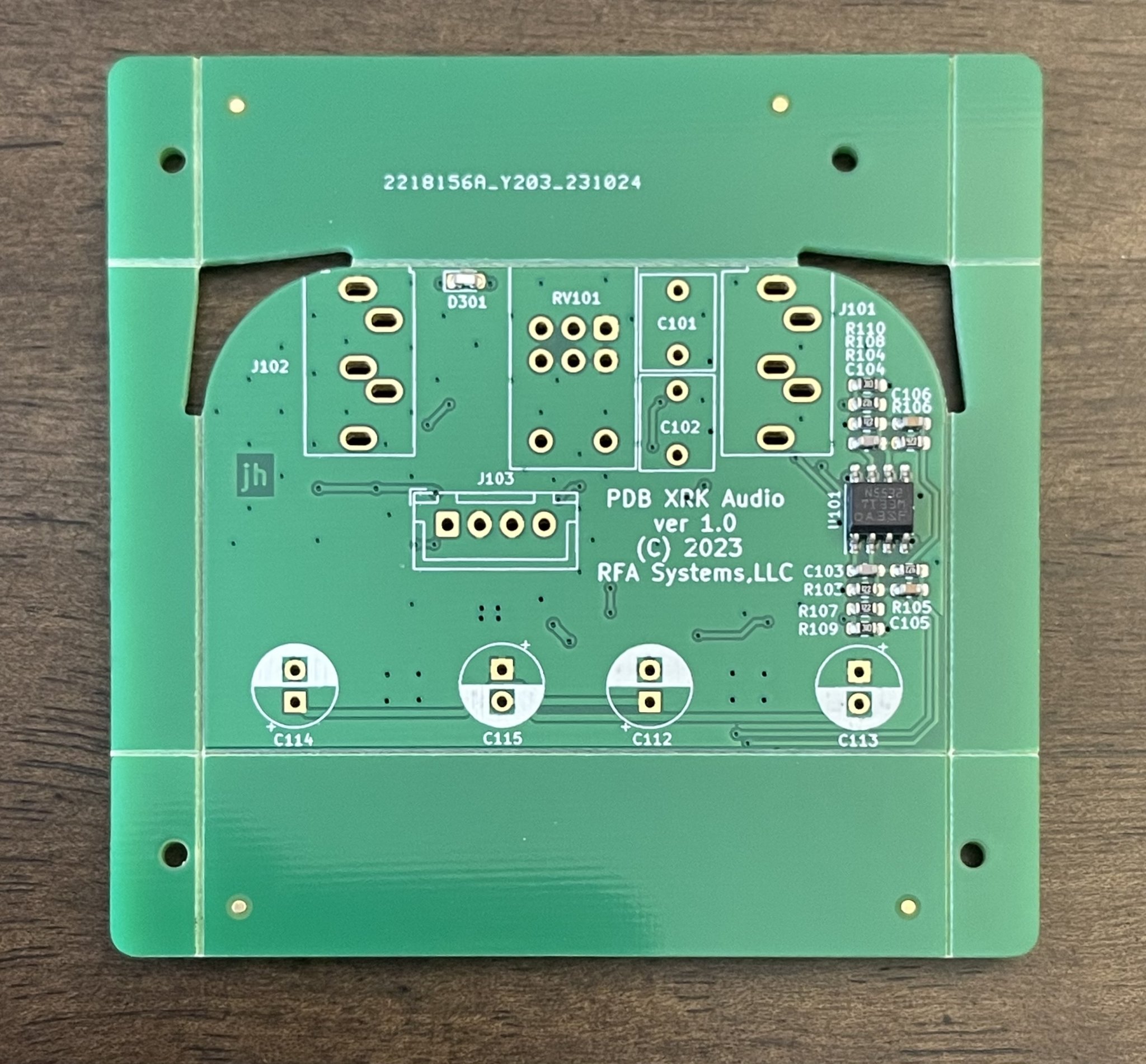

I also noticed that post 2,189 showed one side of the low impedance version (which is what I am about to attempt).
Would it be possible to post a picture of the other side of the board?
I am still very new to this, so it's always useful to have a quick visual reference to make sure I am on the right track.
paul
The other side looks same as what’s on post 1.

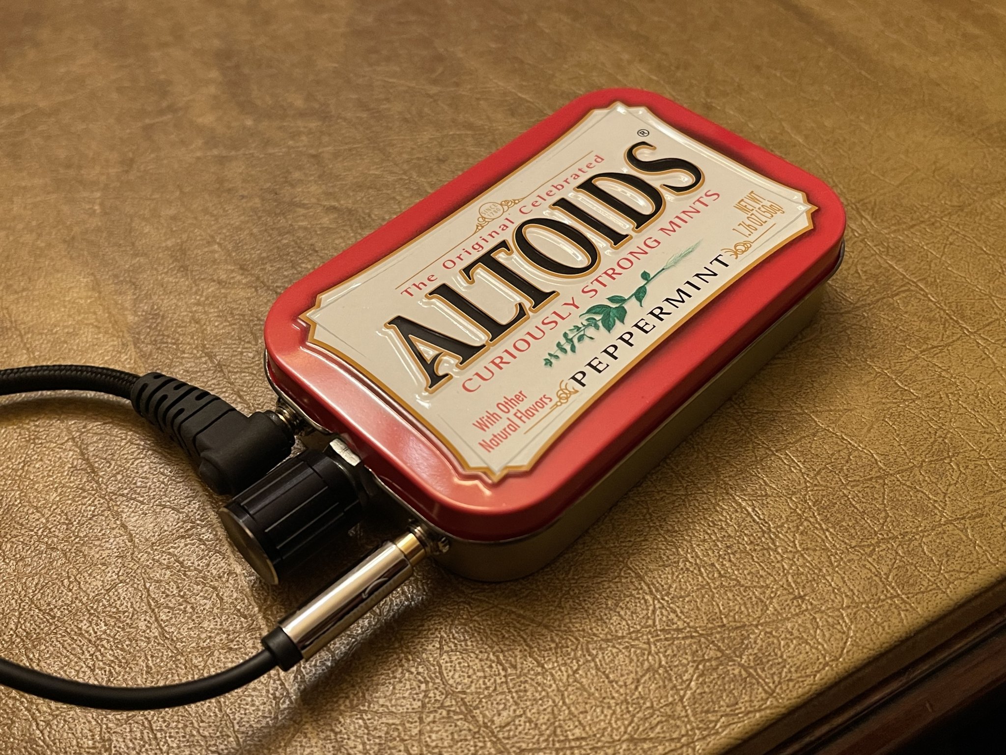

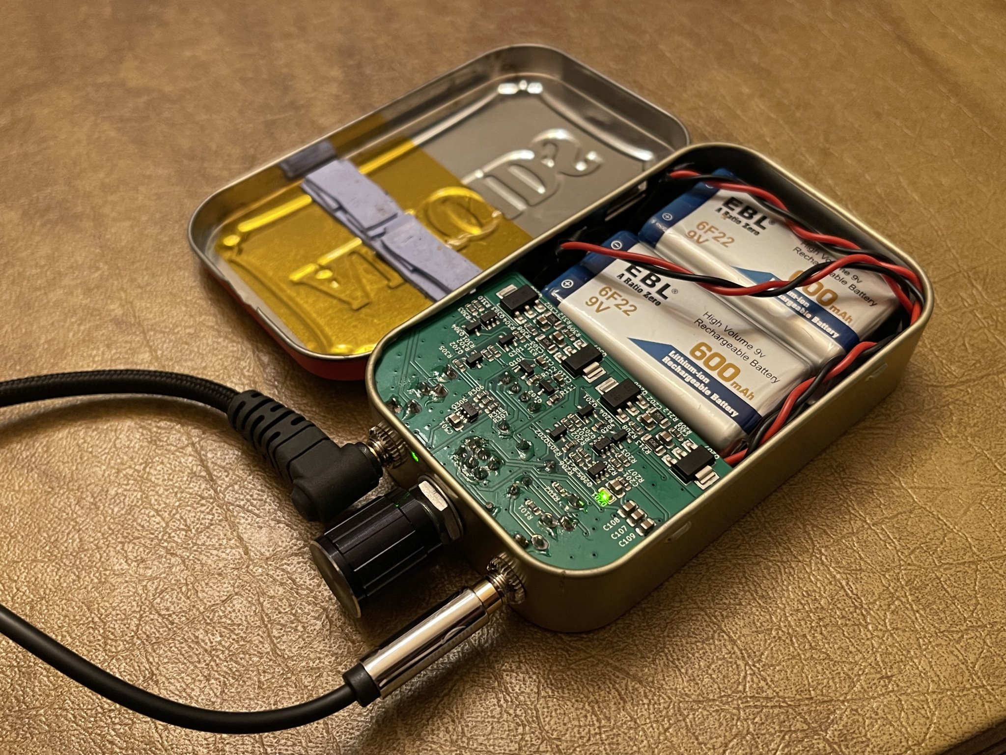

Another Pocket Class A HPA is up and running, sort of. (I built the low impedance version).
When purchasing rail caps there were several variations of the Nichicon 2200uF 16v to choose from. I chose one that unfortunately is a little too large. As a result, the pcb rides too high in the Altoids tin and if I solder the Wima 1uf's to the back side I can't get the lid shut. Whoops!
So I am running it without the Wima's temporarily. Would this be an issue with long term use? I should have paid closer attention to the physical dimensions of the rail caps prior to ordering them. I may need to order a different variation and replace them. By the way, the amp sounds very good even without the Wima 1uf's installed on the SMT side.

Congrats Uncle Mudd!
The 1uF film bypass cap is optional. You may or may not hear a difference.
You may want to switch to rechargeable 9v batteries. The Class A chews through it pretty fast. 2.5hrs typically.

Also, I ordered the rechargable batteries recommended in prior posts from Amazon. They're charging as we speak.
Great. Note that the 9v rechargeable a have a smart safety circuit inside - actually a very sophisticated current monitor and solid state relay mosfet eFuse. This cuts off current to prevent a fire in case high currents are detected. When you initially turn on, a large startup current flows to charge the rail caps. The battery shuts down. So click the on off button quickly on off a few times. Each time it charges the caps more until no more in rush that triggers auto power off.
Usually 3 clicks on/off/on does it.

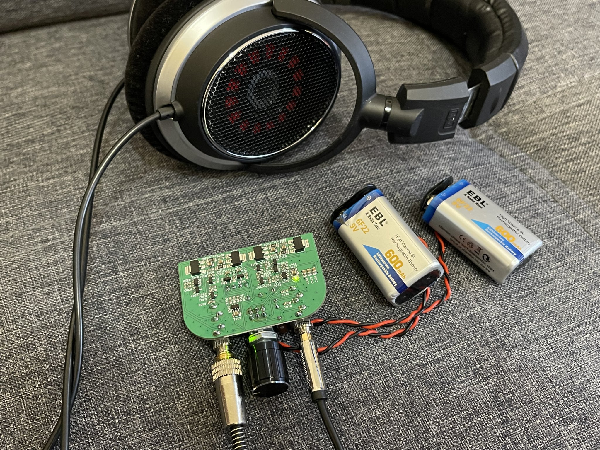

The Pocket Diamond Buffer Class A amp in Altoids tin is now a reality.
Testing worked great from first power up. Amp is DC coupled output so no coupling caps to get in the way of the sound.
With current setpoints the bias current is a bit high at 75mA. Open air temps of outputs are 75C. With silicone thermal pads conducting to the lid temps were 45C. I think I am going to have to readjust the bias current back down to the design setpoint of 45mA.
The sound is amazing though. Drives inefficient HiFiman HE-400i very well and can get super loud. Predicted performance is 1W into 32ohms capability with 0.11% THD. At modest 4mW, THD is predicted to be in 0.0007% range.

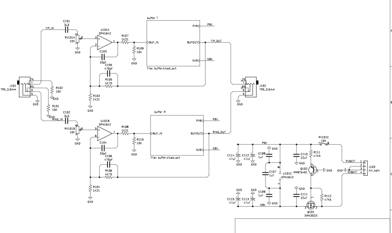

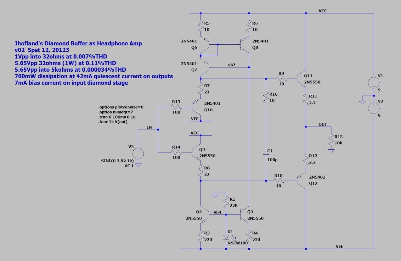

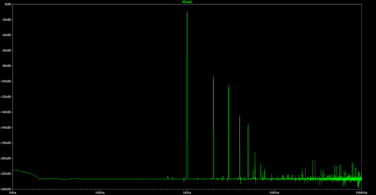

Here is schematic of the diamond buffer output stage. The output is nested in a composite amp with voltage gain provided by an opamp and negative feedback to the opamp input. Overall gain is set at 12dB.

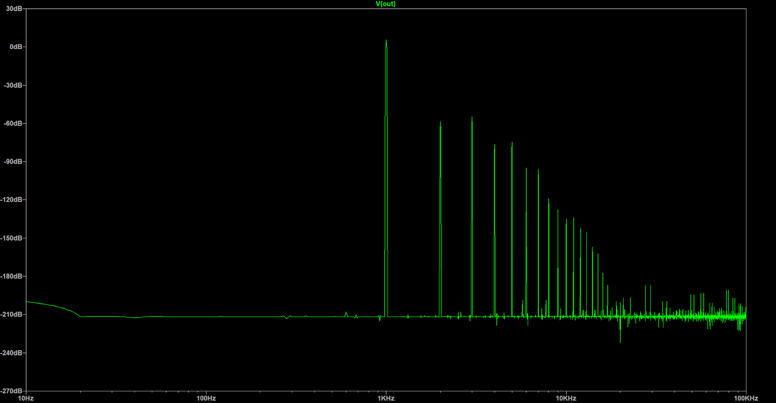

Predicted 1Vpp into 32ohms with 42mA bias current gives 0.0007% THD:
For 5.65Vrms into 32 ohms (1W) we get 0.11% THD but still monotonically descending harmonic distortion profile:

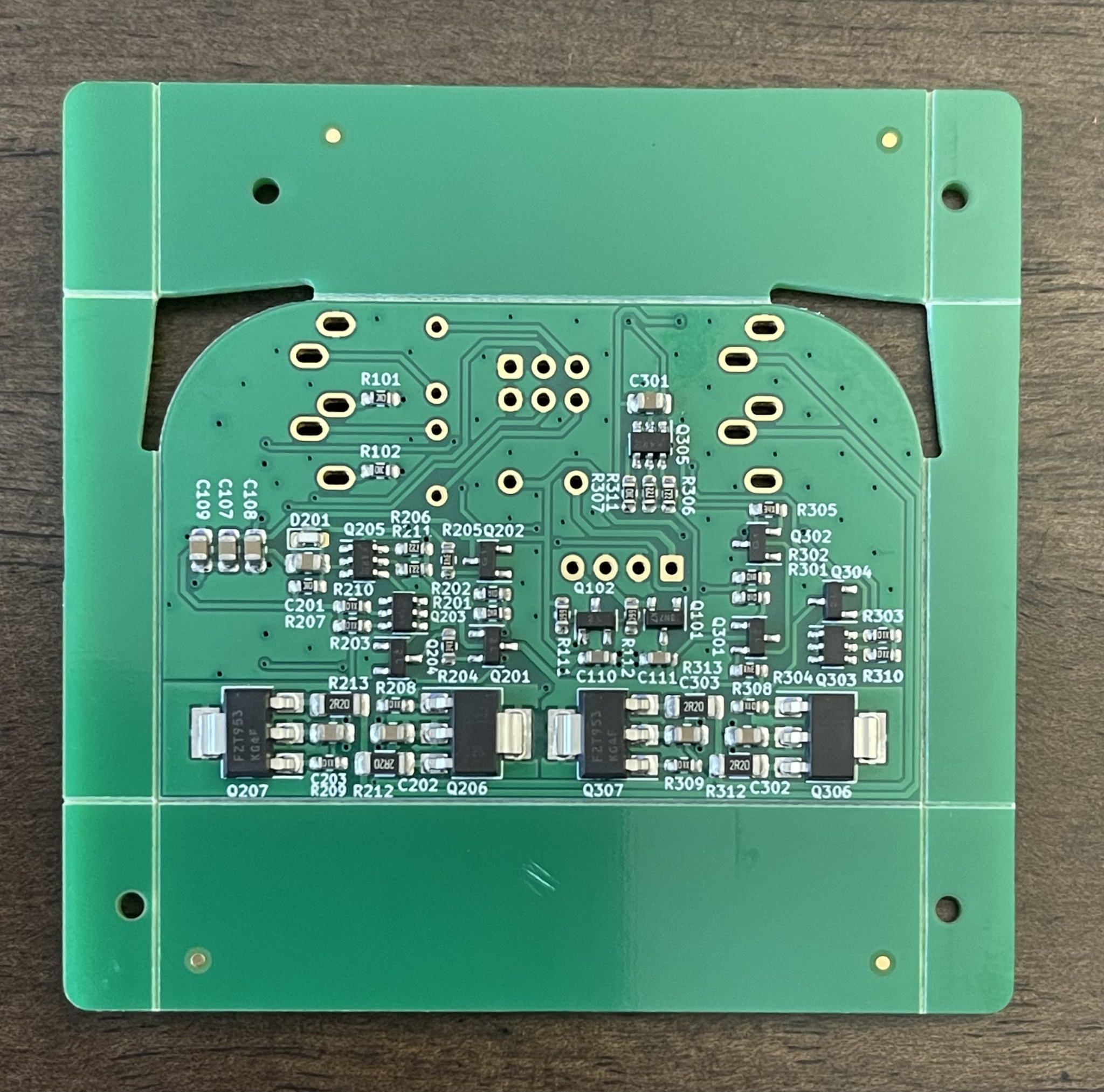

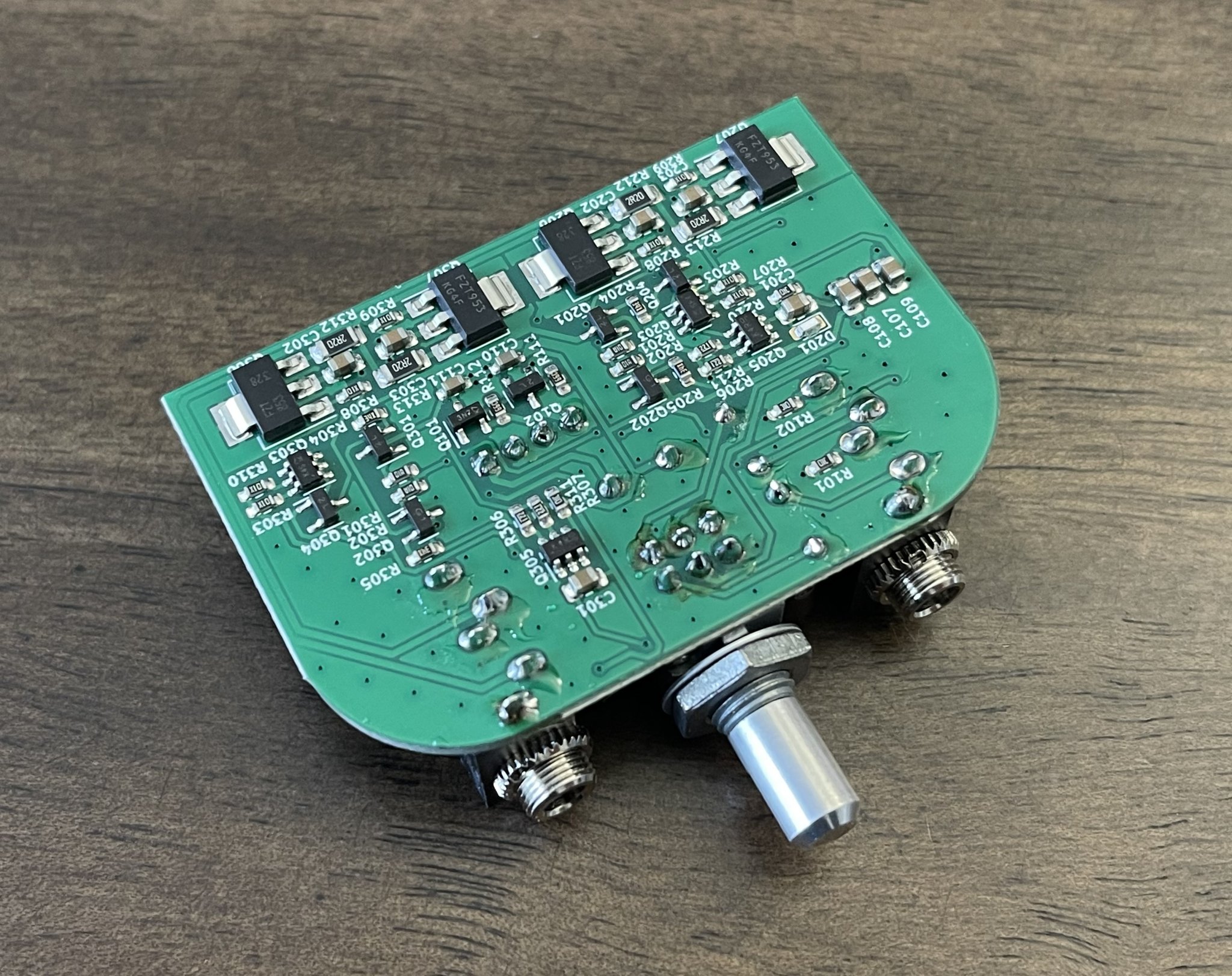

Detail of PCBA all SMT buffer side:
Closeup of bottom side with opamp buffer and all where all TH parts mount:

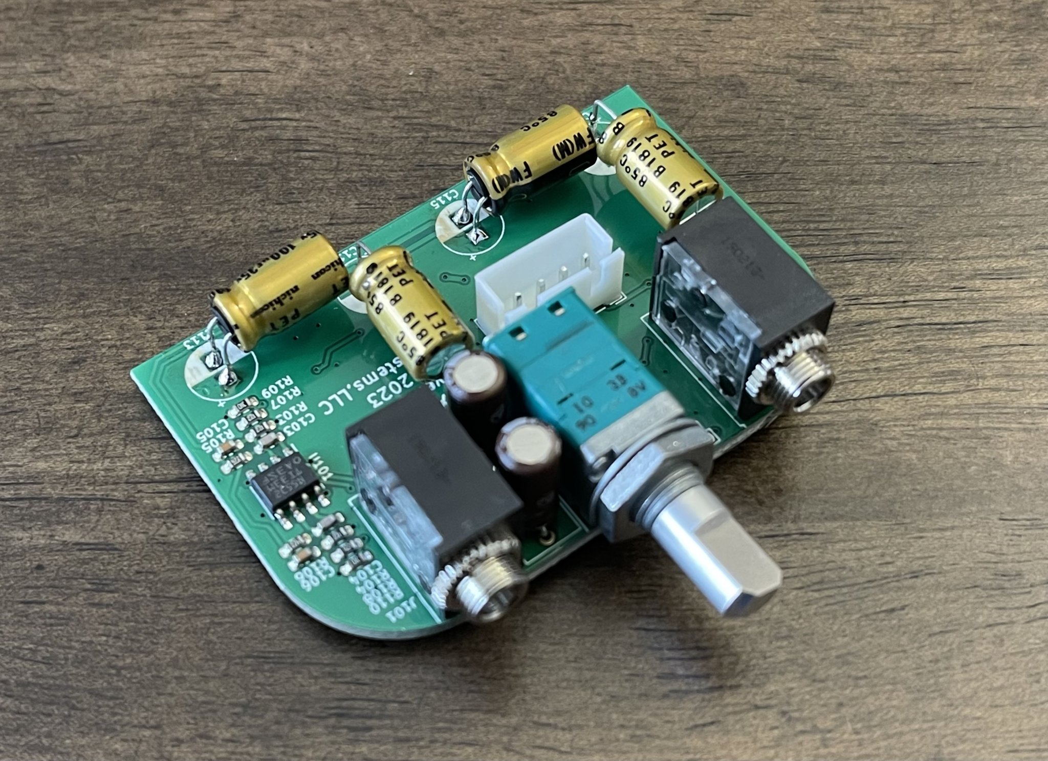

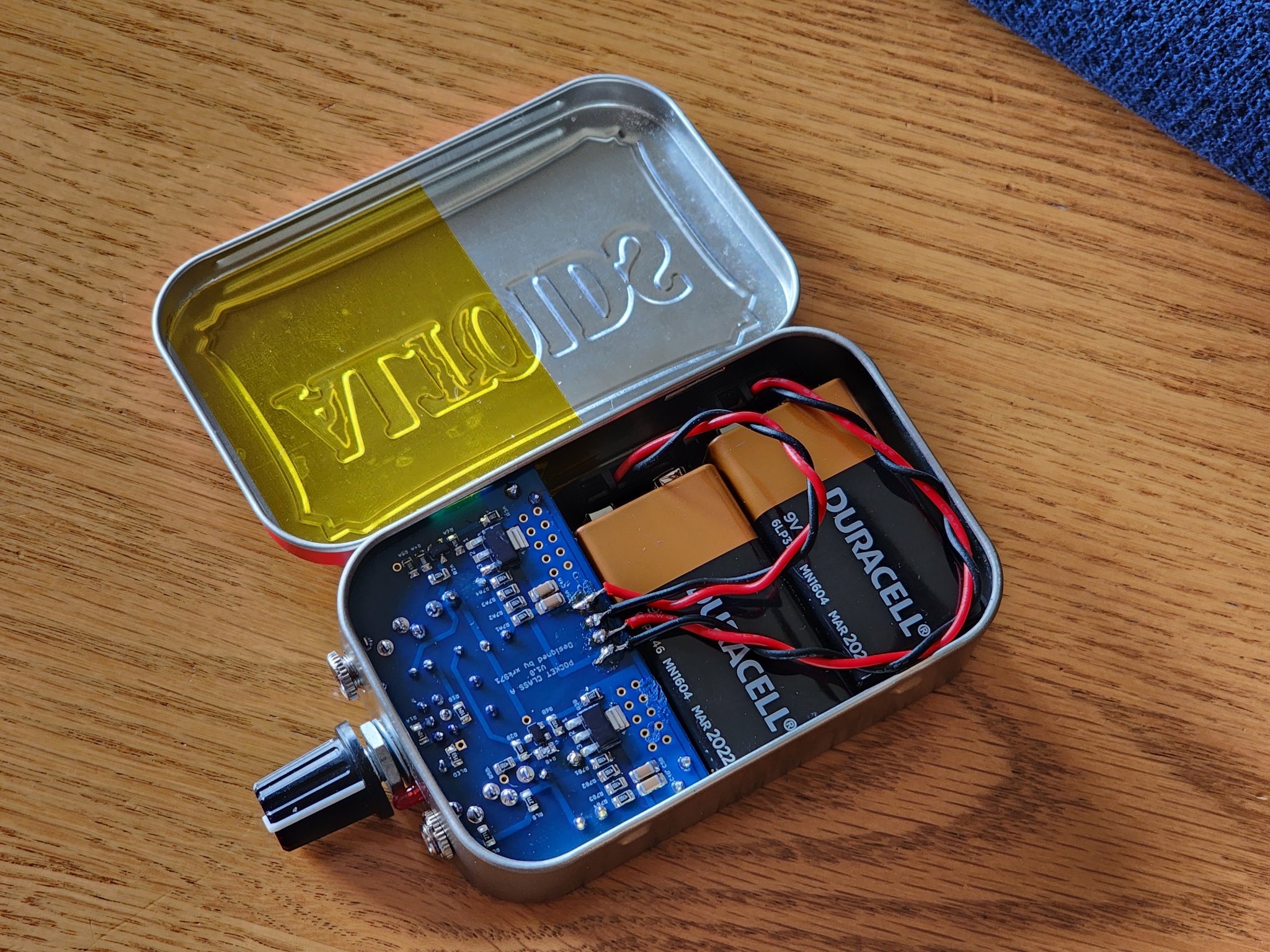

Final assembly of remaining TH parts is really easy: volume pot, 2 input caps, 3.5mm jacks, 4pin JST, 4x 100uF electrolytic rail caps.
