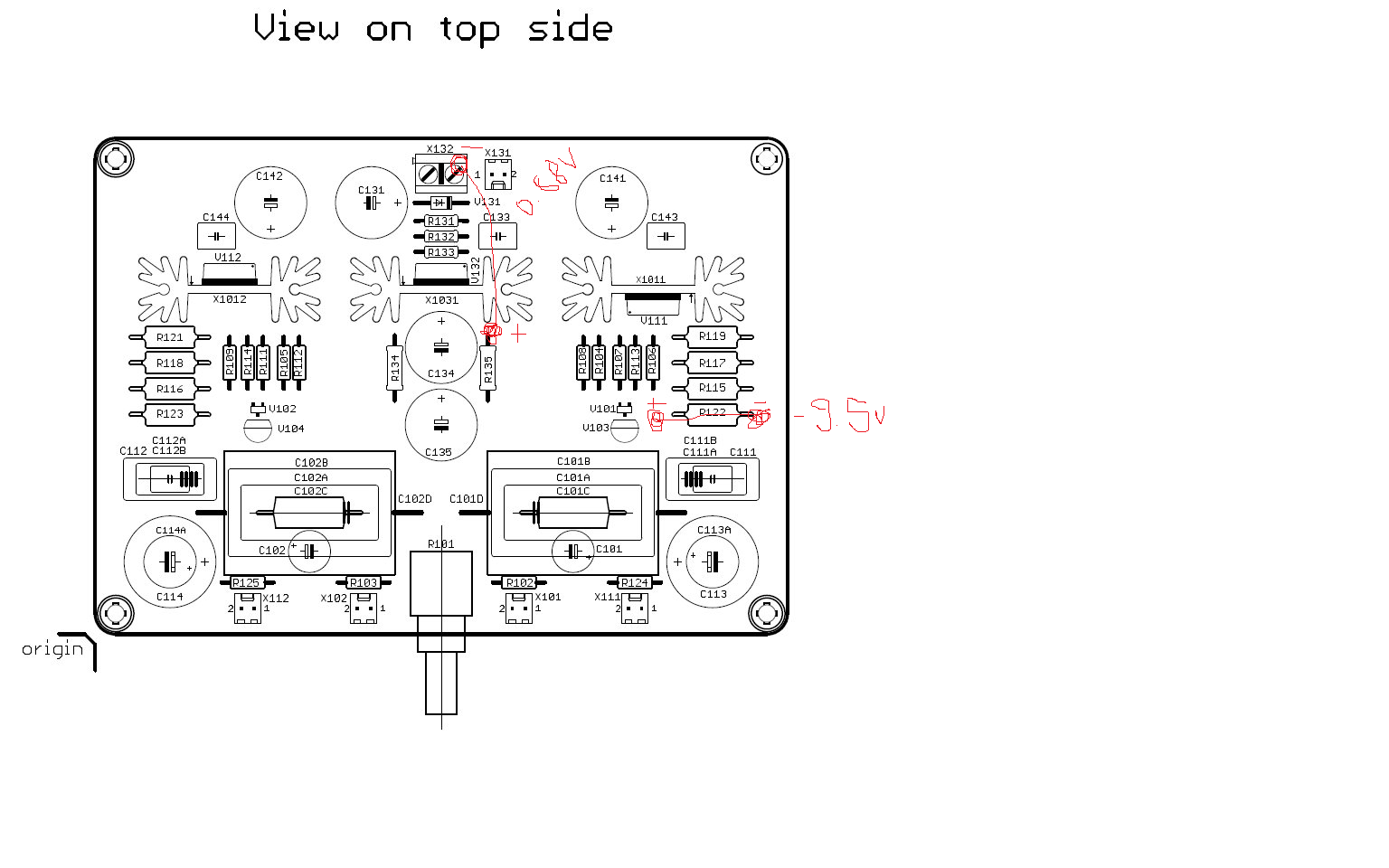

I've managed to break my amp. 😱
I use a jumper for an on-off switch and I plugged it in when the DC was connected and I got a nasty spark.
Now when I listen, I have a booming steady hum at all times (DC?) and some low level distorted music in the background.
Measuring the 24V DC from the step up at the board input connector it's only measuring about 9.8V.
With no electronics knowledge, my basic reasoning says that the caps and resistors should probably take a bit of voltage with no ill effect so maybe I've bust the cap multiplier as that's the first active device in the way?
Any suggestions as to how to diagnose would be appreciated.

What is the voltage of the step up without connecting it to the board? Cap multipliers are pretty tough and immune to turn on transients. The cap multiplier is a slow turn on valve that protects everything downstream. You may have a busted wall wart, or a bad DC step up or a bad (shorted cap in the multiplier). 9v supply will sound terribly distorted.
1. Determine if wall powered DC supply is good still
2. Determine if DC step up is good
3. See if cap Mx works (slow ramp up and output is 4v less than input)
4. What is bias current through MOSFETs? V at pin 3 divided by R in bank (67.5ohm).

Any luck debugging where the problem is yet? If it is not the PSU or DC-DC, (and a true 24v is provided upstream of cap Mx), please measure DC voltages relative to GND at all nodes (connections) on circuit, mark up schematic with it and post here. Also, some close up photos so I can see values of all resistors installed, etc - that will let me debug it very quickly. Good luck.

Hi X
1. Supply is good. Gets very hot now. Replaced with other 12V supply with indicator and that goes down to 7.75V when attached to amp.
2. DC step up good. 24V. Gets VERY hot when attached to HPA.
3. On attachment see where I have measured the CM voltage at 0.88V.
4. On attachment see where I have measure the MOSFET bias voltage at -9.5V.
It was working perfectly previously.
Does that help or is more info needed?
You should not be getting negative voltage on a single rail supply amp. If you have negative voltage at output of mosfet pin 3, it means your DC converter is connected to amp in reverse polarity. Can you double check that voltage at pin 2 of cap Mx mosfet is +24v relative to GND?
