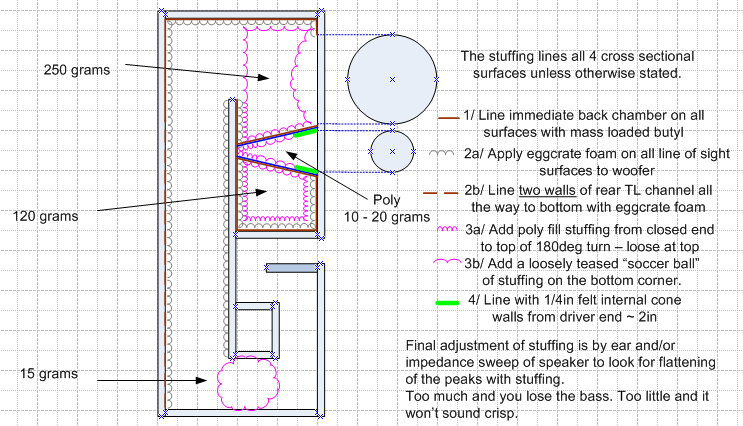

Do you know exactly where on the thread you specify how much stuffing material, what type and where to add it? I might build a set and let Thomas hear it.

The is a stuffing diagram at the bottom of post 1 in the main thread.
https://www.diyaudio.com/community/threads/10f-8424-rs225-8-fast-waw-ref-monitor.273524/
Looks like this (made by member GUJoe ):
There are also photos of the internals with stuffing and padding made by members throughout the thread.

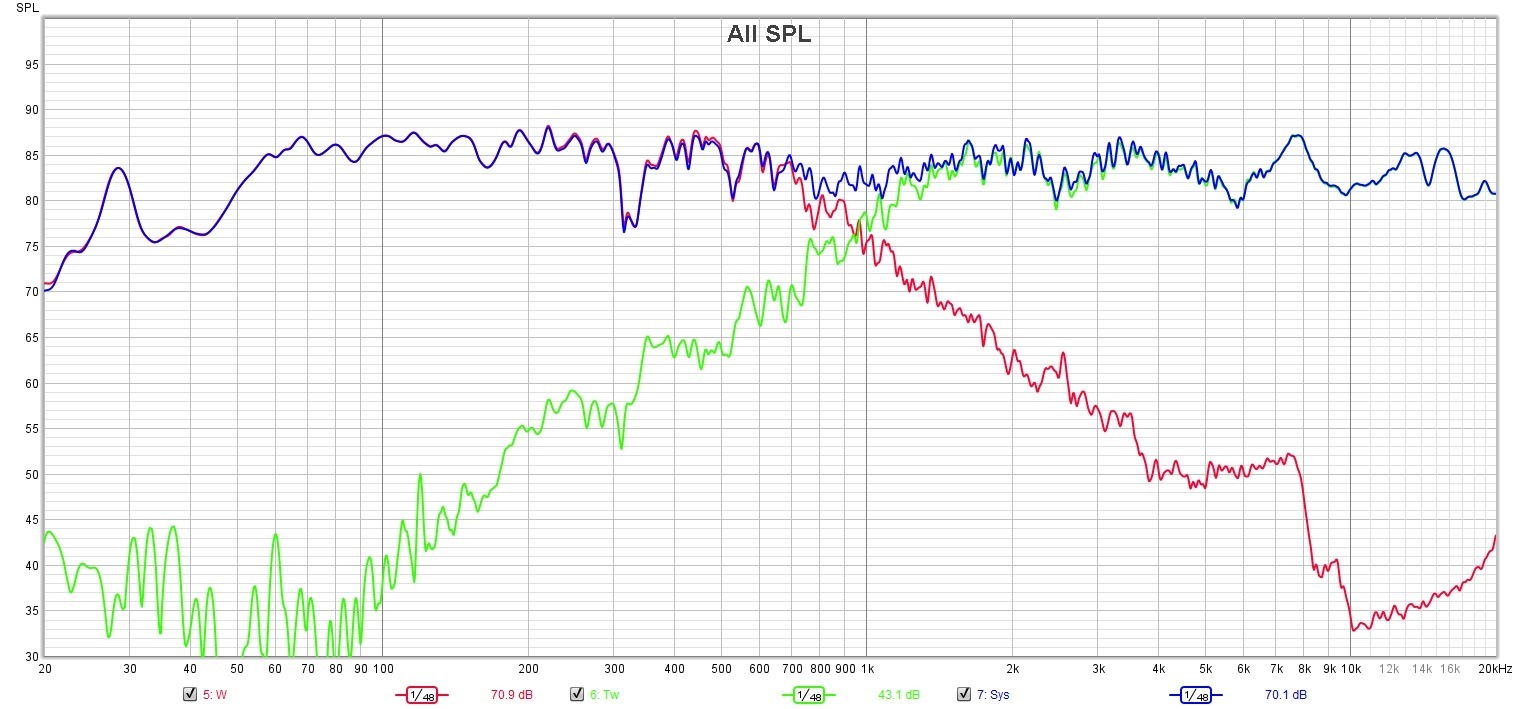

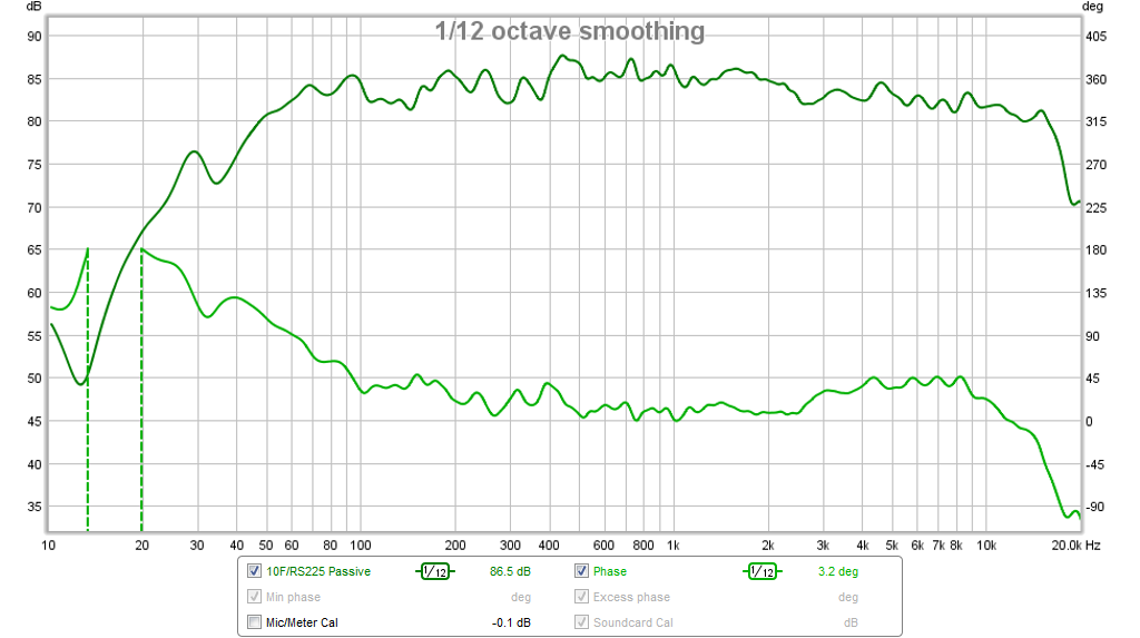

The RS225-8 in a 24L sealed box has a -3dB point of about 55Hz. With the SB23NRXS45-8 it’s about 52Hz.
Here is the SB23 in the sealed cabinet (before I ported it). The peak at 30Hz is the room mode.
Here is RS225-8 in sealed:

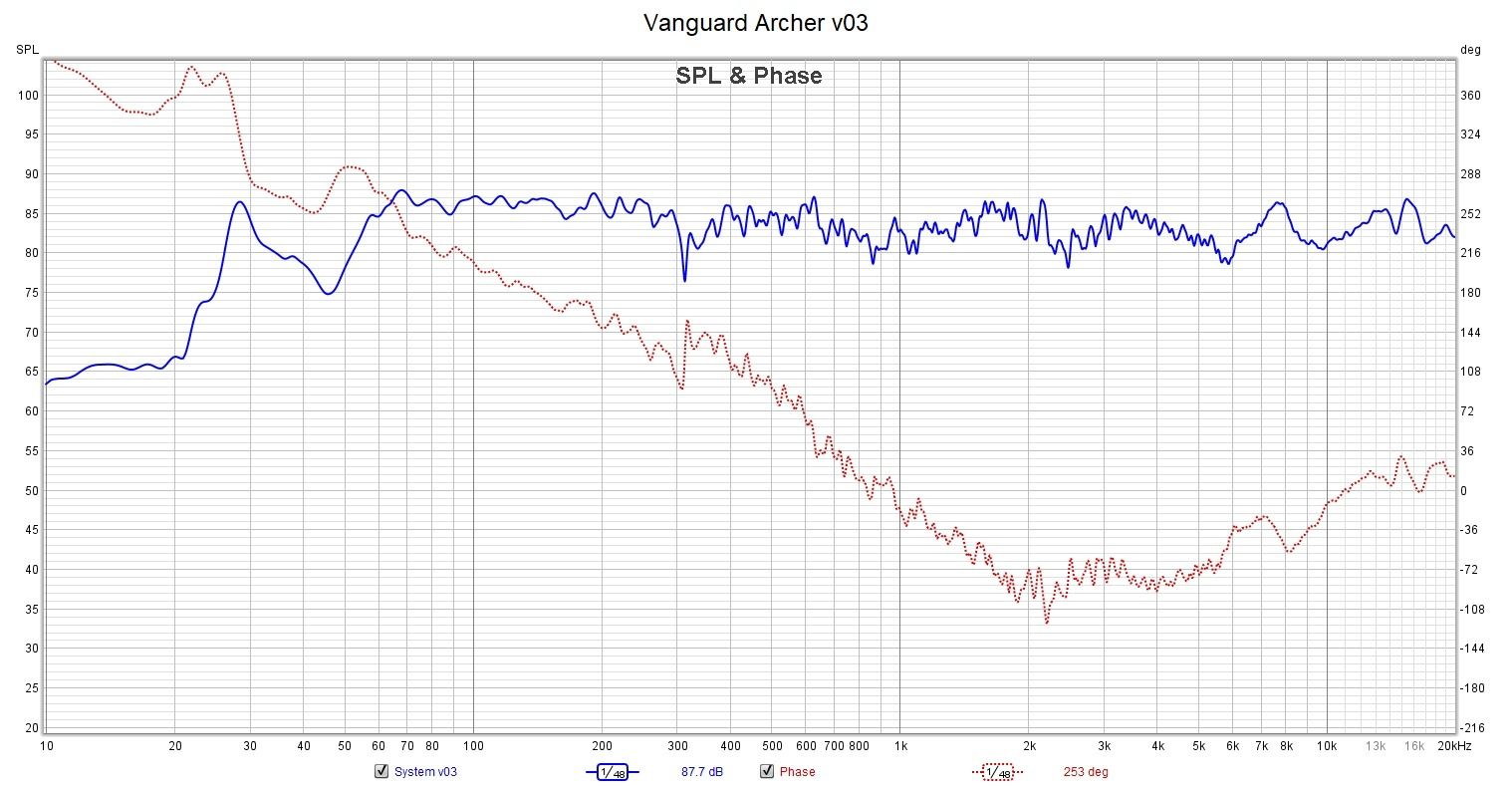

Yes, I did measure ported but only with SB23. It’s here
Phase:
Phase:
