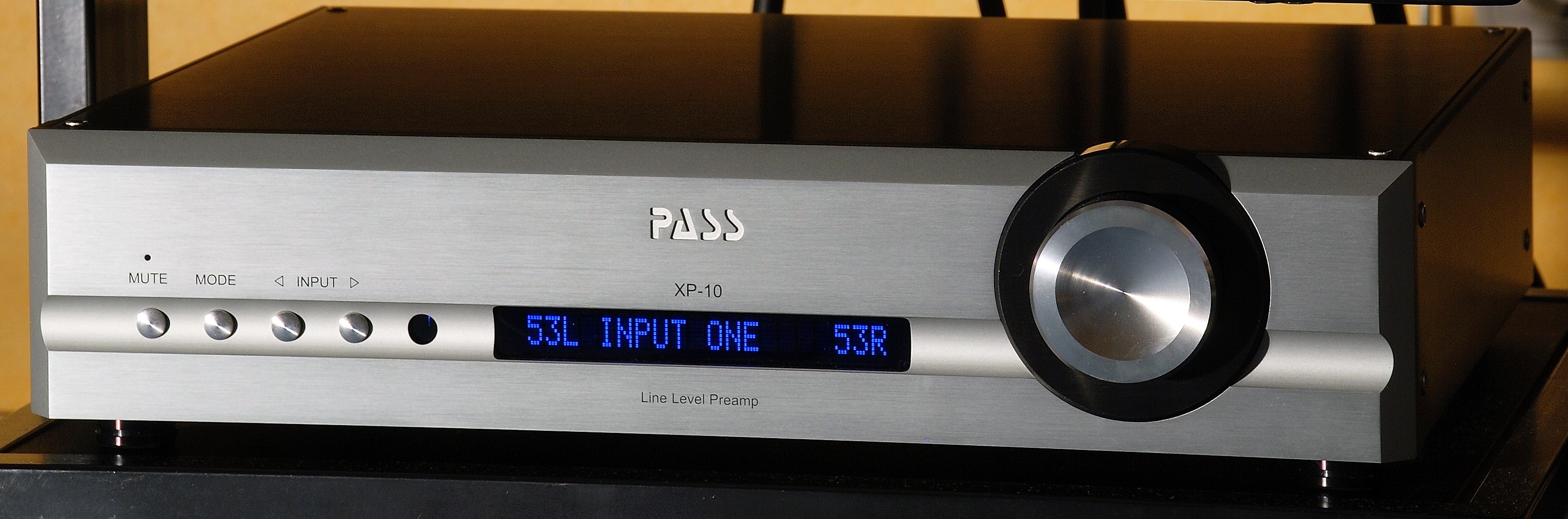

However, I would prefer to replace the dying relay.
But waiting for designer's official standpoint. 🙂
I ordered on Monday, I got it on Wednesday.
Here is the relay.
So I waiting for the XP-10, to repair it.
Here is the relay.

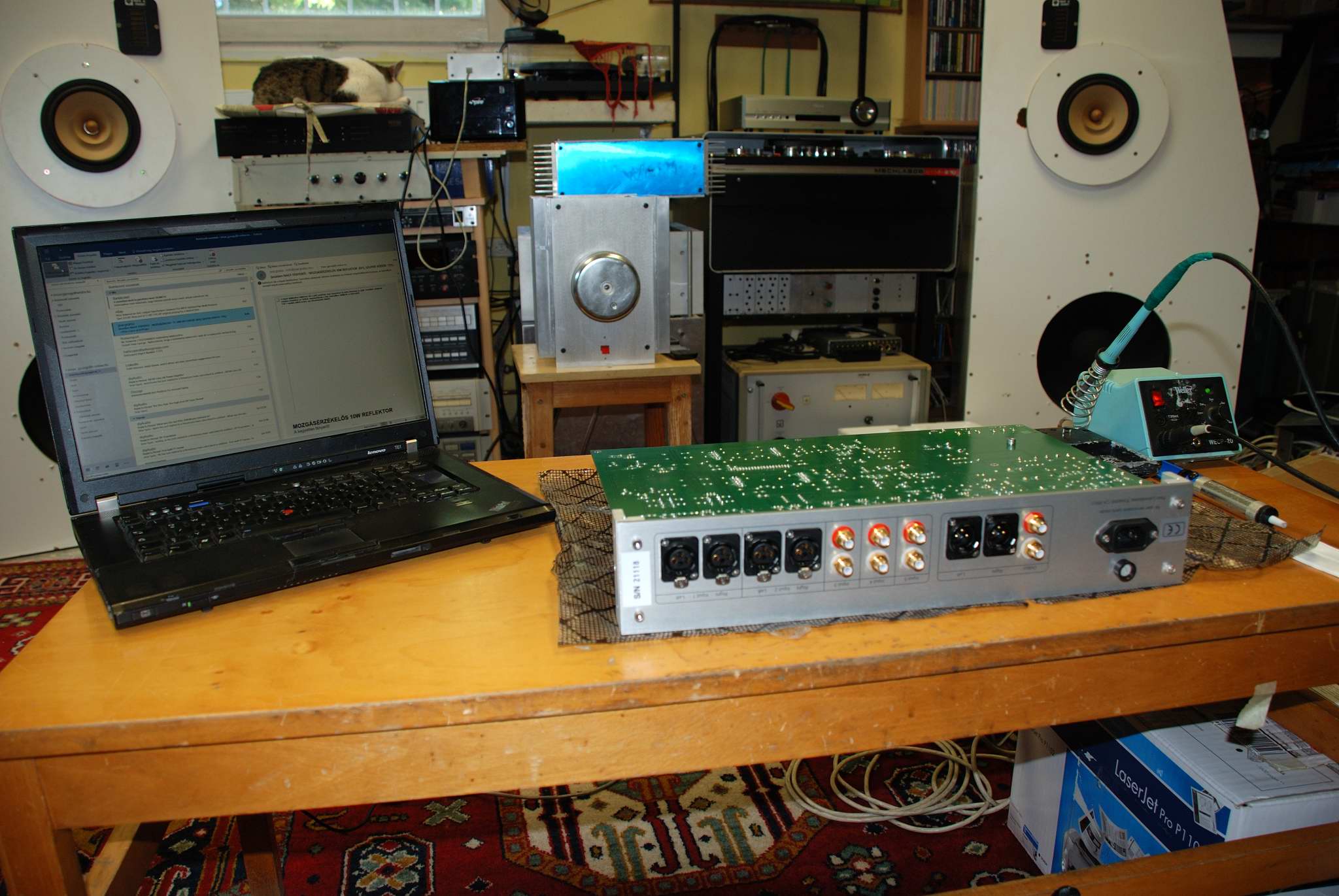

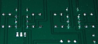

There are good news, K13 relay removed from panel, without pain.
It shows changing contact resistance between pins 4 and 6.
New relay is in its place!

Surgery was a big success.
It has a damned good sound.
(What a surprise.)
