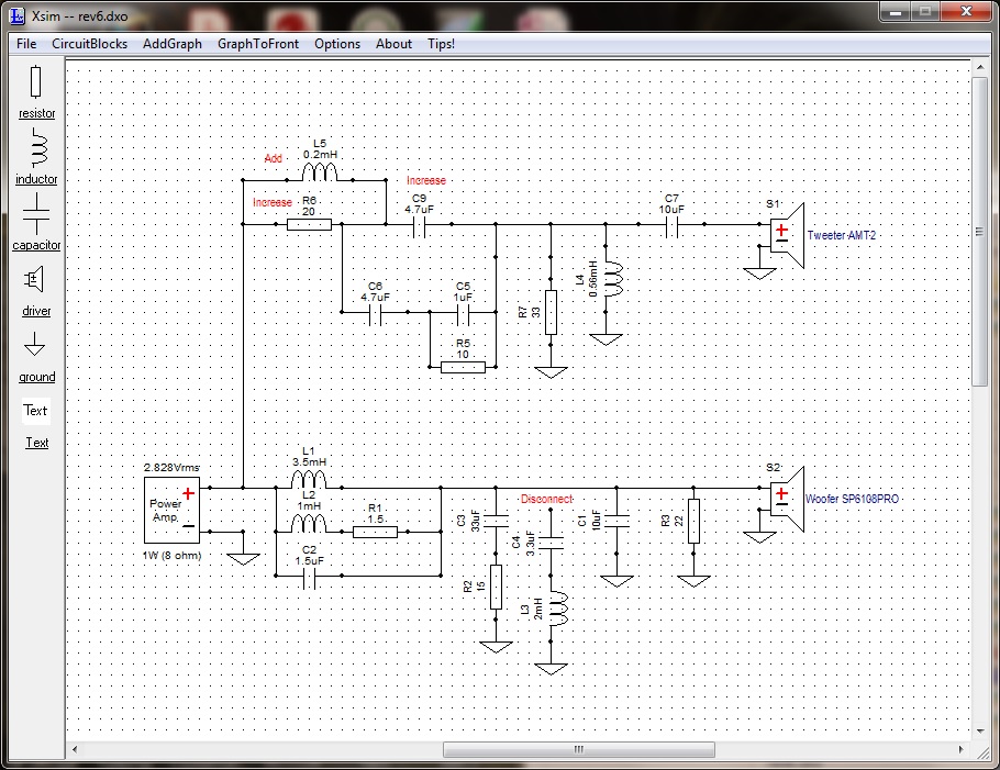

I loaded the FRD/ZMA files (provided from your new thread) into Xsim, and used your original XO component values. You can see the results are not so good.
Then I did the minimum amount of XO changes (schematic marked in red) to get a reasonable FR. There is enough LF gain for baffle step loss compensation.
There are still a lot of components in that XO that are not required for this design. They have minimal effect (ripples) so they were not removed or changed, otherwise you would be building a new XO 😉 I included the Xsim file so you can try it.
