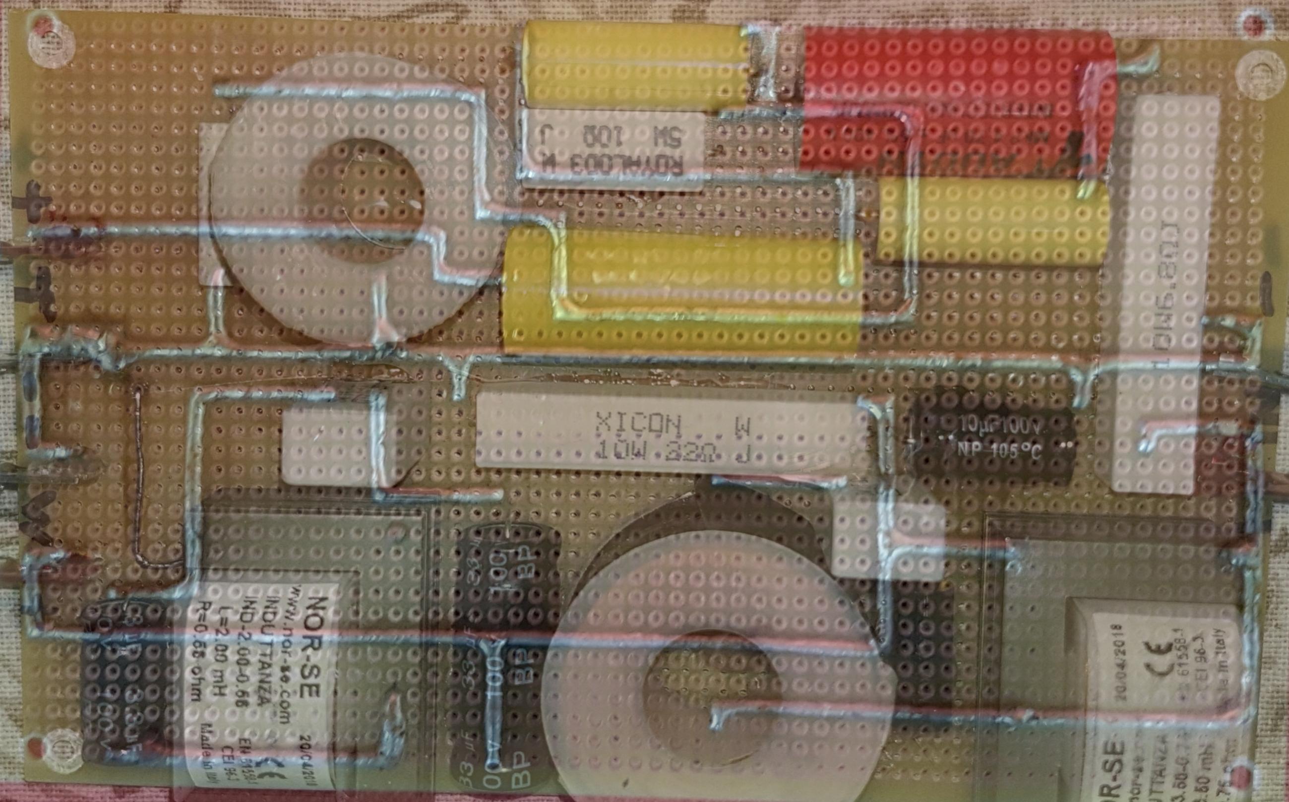

Xover reverse engineering
Here's another pictures obtained overlapping top and bottom of xover.

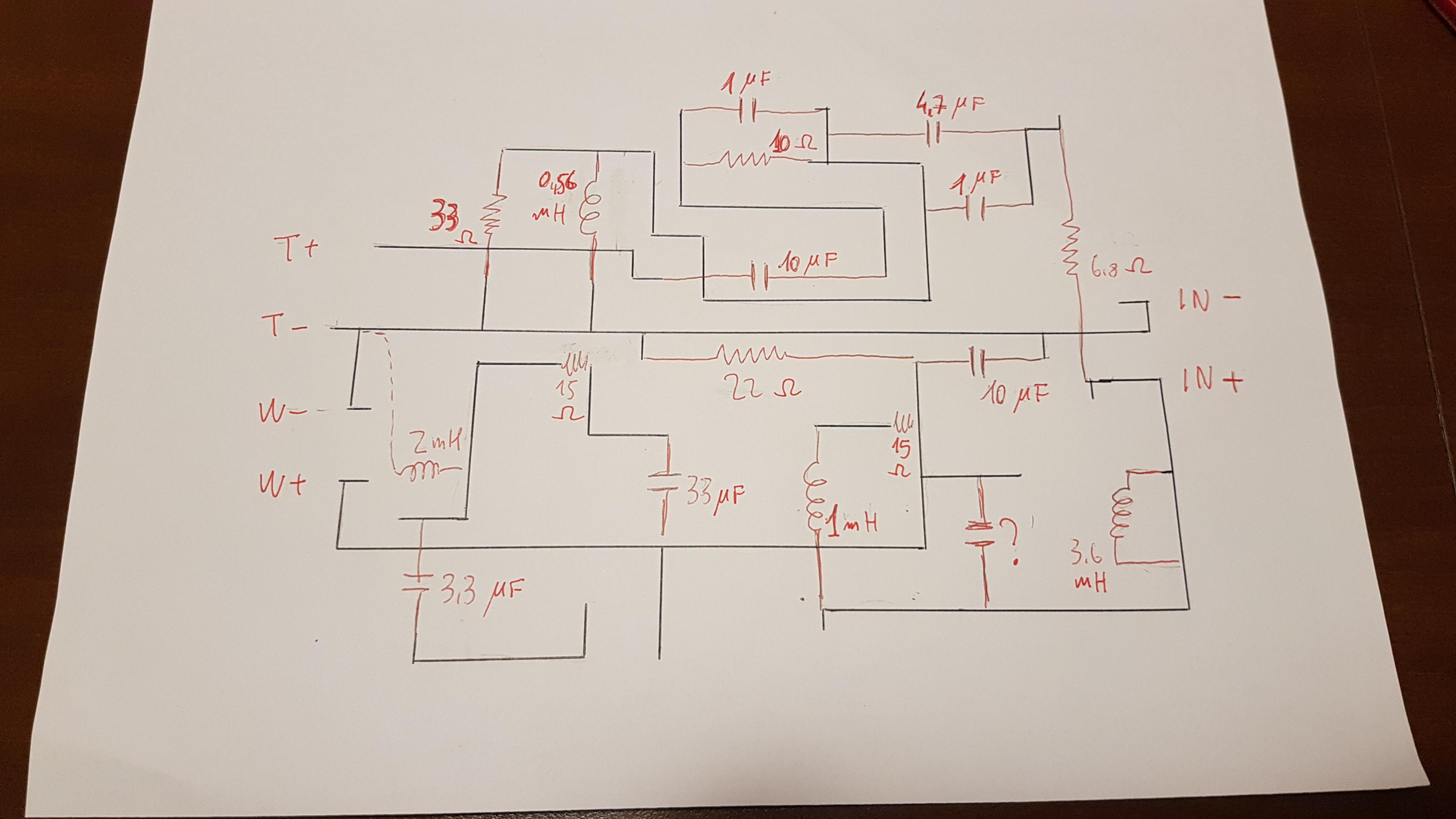

Hoping there are boy so much errors, this could be the scheme. Is it easier for you to determine xover parameters? Even l-pad, zobel, attenuation... if any... and I'm really not able to split woofer section from tweeter. Help please...

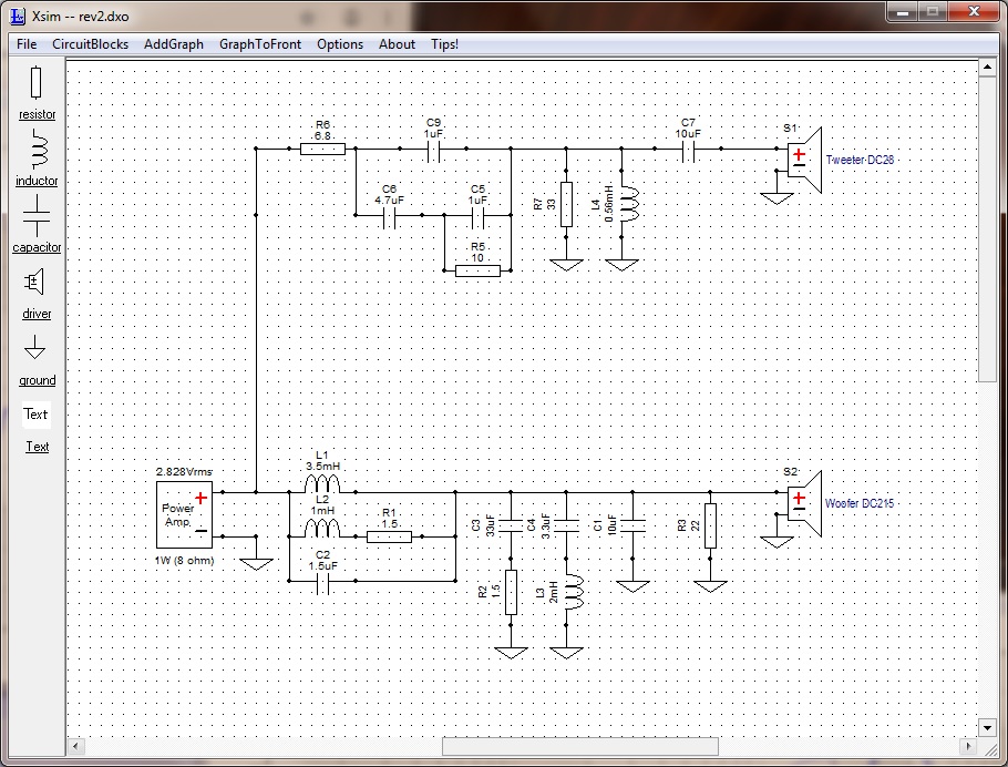

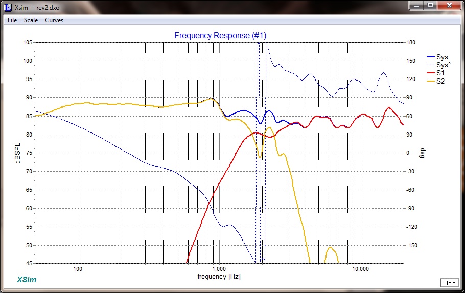

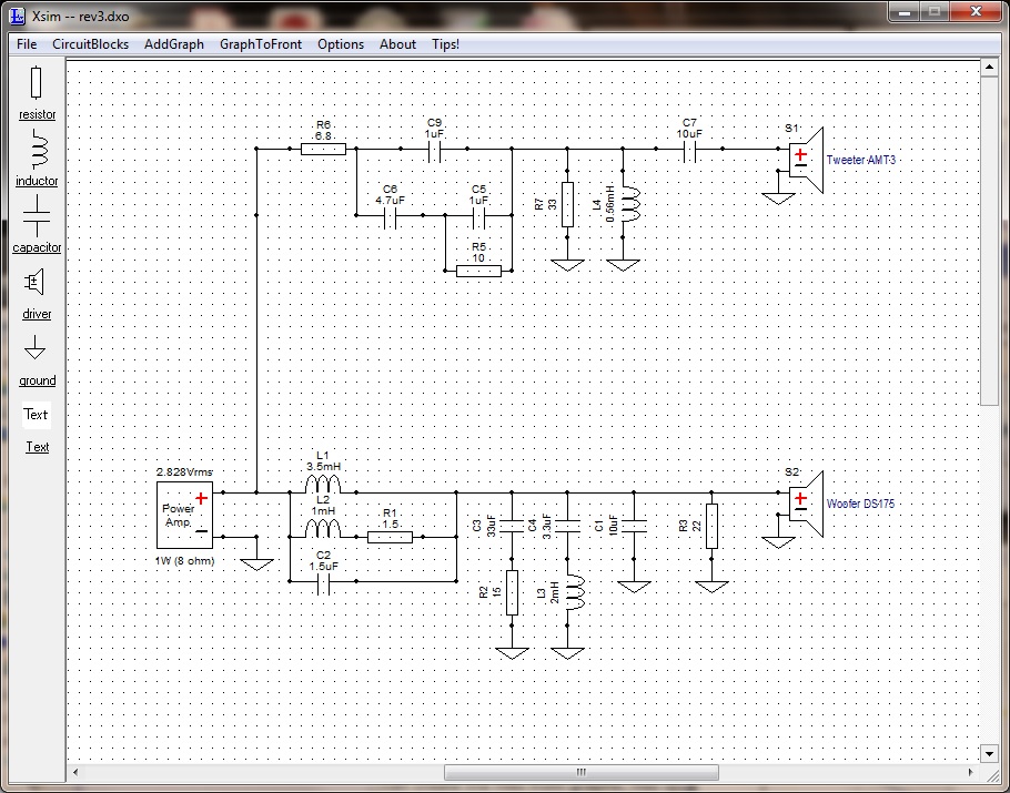

I had another look, and updated the component values. I made a few changes to the schematic to make it more readable.
Can you use your ohmmeter to measure R1, R2 I think the 15R is too high and should be 1.5R
What are you intending to do ? Change drivers ? Improve the Xover? I still don't know what the purpose is.
In short time I verify with multimeter R1 and R2 values. You made a great job, many thanks! Reasons for me to know everything possible about this xover are at least two. The first is practical, I used it on a double bass reflex tower enclosure with Monacor drivers (SP6-108PRO and AIRMT-85) without satisfaction. So I would like to try other configurations, for example Troels Gravesen 2-way cabinets, and I have to know xover values. The second is less "noble". The guy who has designed, built and sold me xover refuses to share tech infos about. He is a very strange man and there are no logical reasons for his attitude. It is a challenge for me at this point! Last question, could you please share XSim file of your last effort? Thanks!

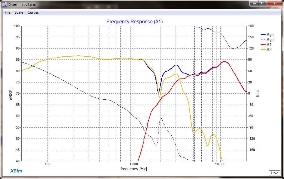

I have updated the schematic (V3) to include drivers that are now "closer" to what you have. Monacor does not publish full data (FRD, ZMA) files. Although you can create the files from graphs or measurements. You can see the FR mismatch which can be easily fixed in the XO. It still does not have the cabinet effects (tuning, baffle loss).
Your double bass reflex cabinet is tuned and is sensitive to the woofer parameters. If you can measure the cabinet and port dimensions we can check the tuning with HornResp. Then we can add the effects of the cabinet to the Xsim simulation and finally adjust the XO to get good performance.

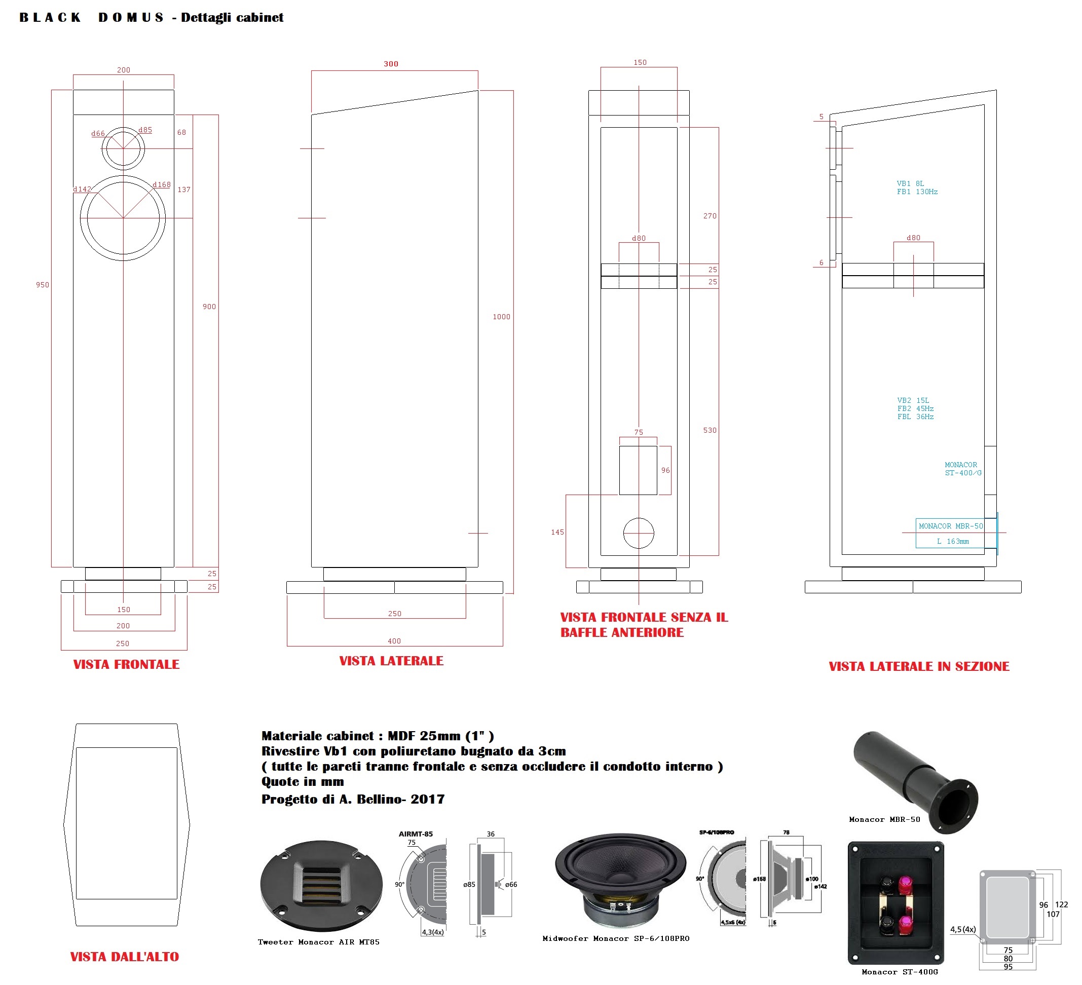

Here's the origina project and few examples of what I've in mind:

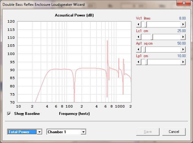

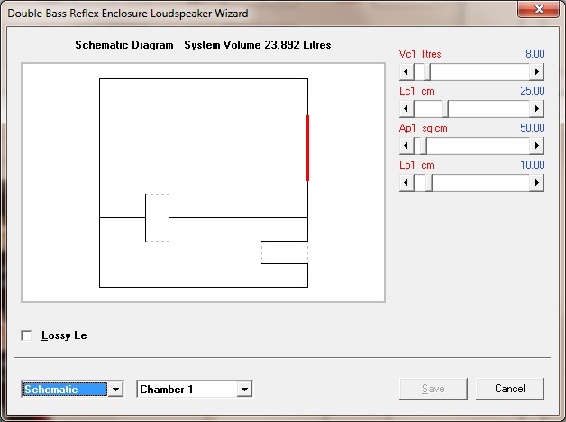

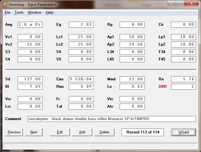

Let's check what you have now. You did not like the sound but maybe it can be fixed.
This is a HornResp model of the cabinet with the Monacor woofer. I also attached the HornResp record so you can import it and try it out HornResp Hornresp
Ignore the "spikes" they can be reduced with stuffing. The bass performance is poor because the cabinet and woofer were not tuned together. If we add in the baffle loss, the bass performance will look even worse. Is that one of the problems ?

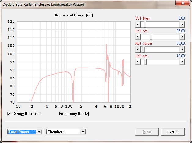

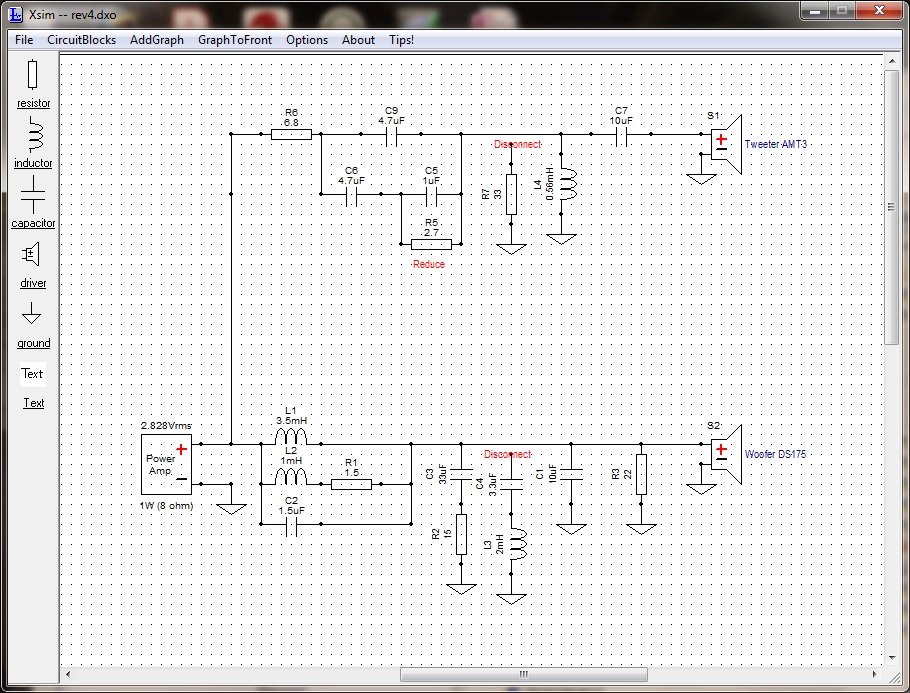

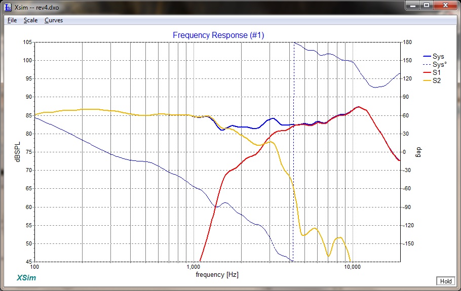

First of all, do not make any changes yet. This is just an "example" of the effect of just a few modifications. These may change as the simulation model gets more complete.
The cabinet's lower adjustable tuning port, was shortened to 100mm.
The XO has a few disconnected components based on drivers "like" yours.
